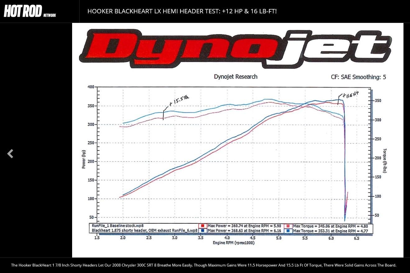

I am looking more seriously at the Hooker shorty headers.
I just found this test on a Chrysler 300. Simply bolted on the headers and gained 11.6 HP at the wheels, and 14 pounds lighter. This may be my best option without needing to re-tune.

Shorty headers are a total waste of money... alot of money for not many gains
