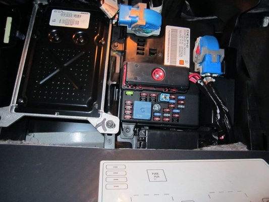

The clock spring under the steering wheel would effect the controls of the radio, horn, but I think that would be all. The stalk would be connected to the hardness on the steering column, that's were I would start with.
Also, the BCM controls many functions that you're having issues with so maybe check the big blue colored connectors there. If you don't know where the BCM is, it's under the carpet on the passenger side foot well. Grab the top of the carpet and this will reveal the BCM.

id already unplugged the BCM and nothing wrong there.. checked the clock spring it appears to be good.. idk
