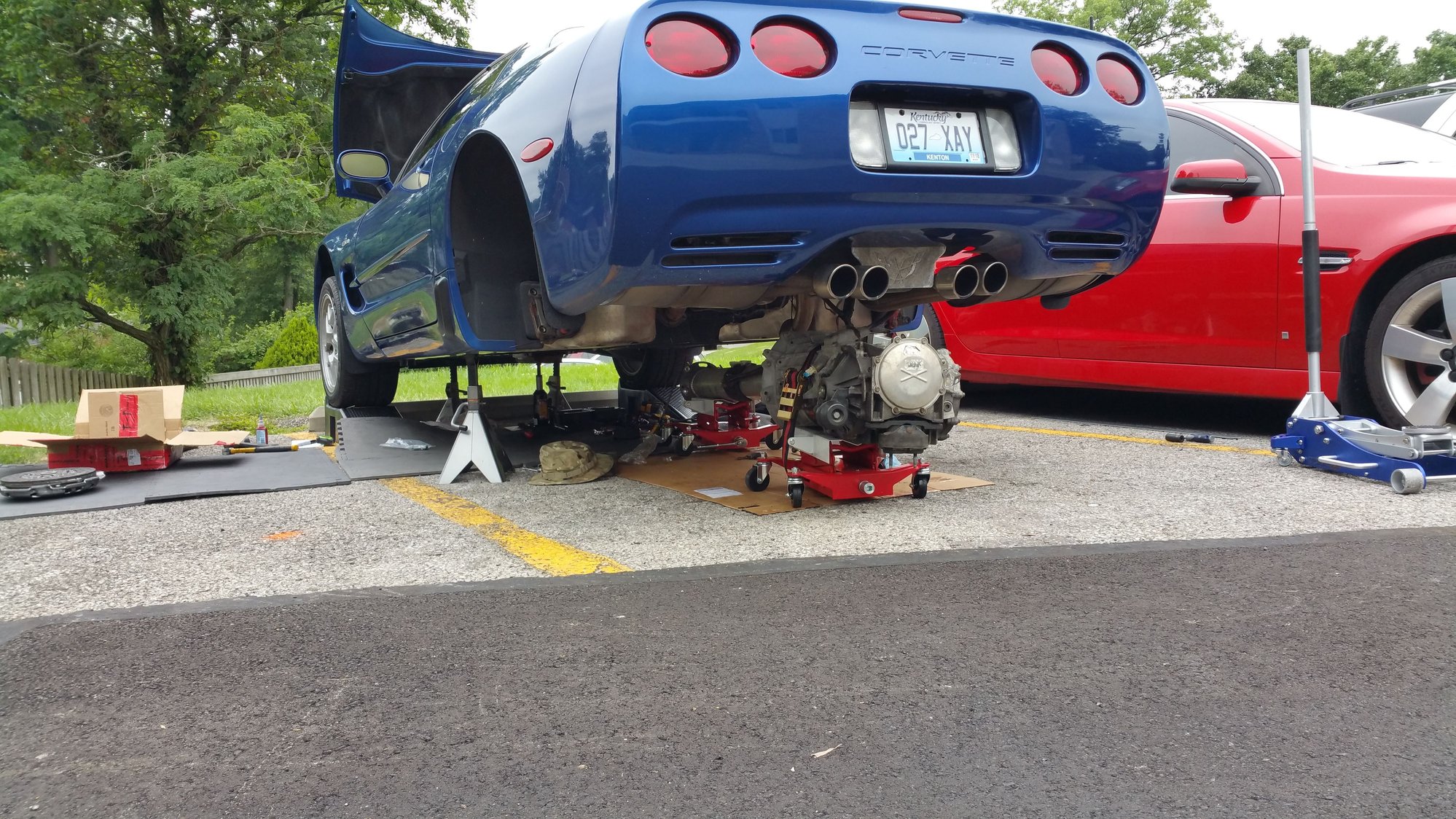

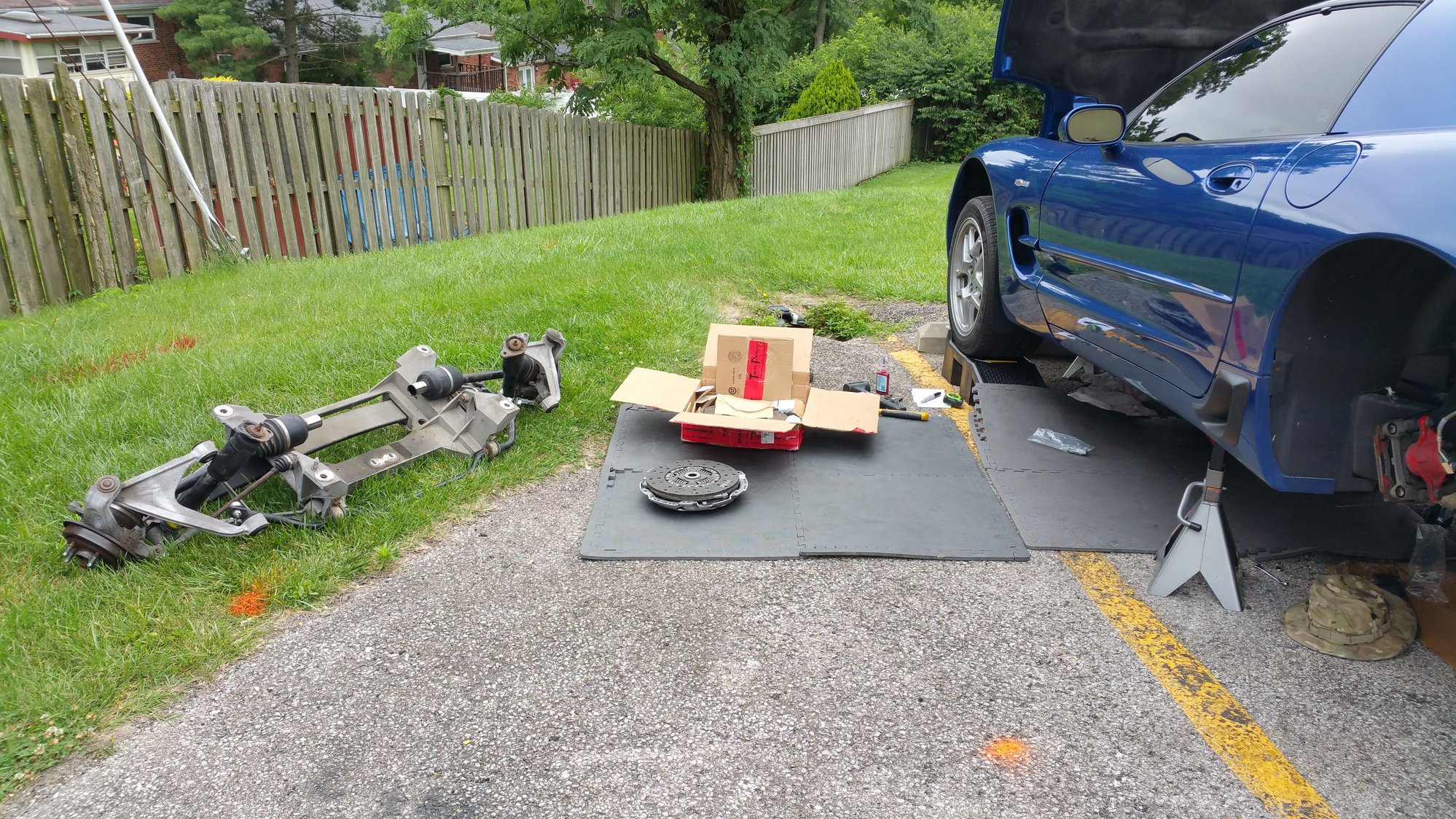

Also, as far as the job, it is not difficult in that it is not complicated. It is just that you need to disassembly most of the drive line to get to the clutch. A lift is a nice luxury most do not have. But you can do this on jack stands in a weekend. I did exactly this. Drove my C5 Z06 up onto ramps then jacked the rear up and placed on jack stands. Used a couple of Harbor Freight scissor jacks to support the trans and torque tube after removing the rear cradle. I did it all by myself. A lot of work but very doable.

Im not very mechanically inclined and decided to attempt it myself as well, did it on my drive way with jack stands and a low pro jack from harbor freight. Its not that hard, i actually found it better on jack stands. if i were to do it on a lift i would of had to buy some of those really long jackstands for the rear end. It is time consuming though. took me a whole weekend by myself and had to rent some tools from my autoparts store.

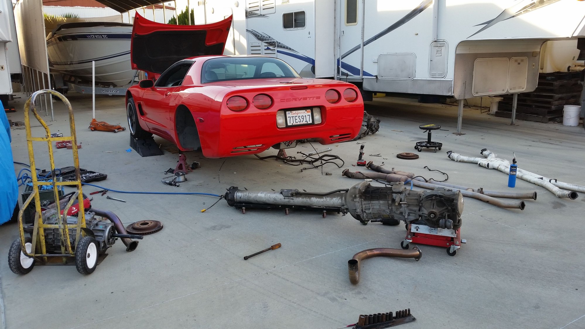

I did it in my FRC. More time intensive than difficult. Had it done in a weekend with a TT rebuild. Transmission jack and a furniture dolly were the only real specialty tools involved.
