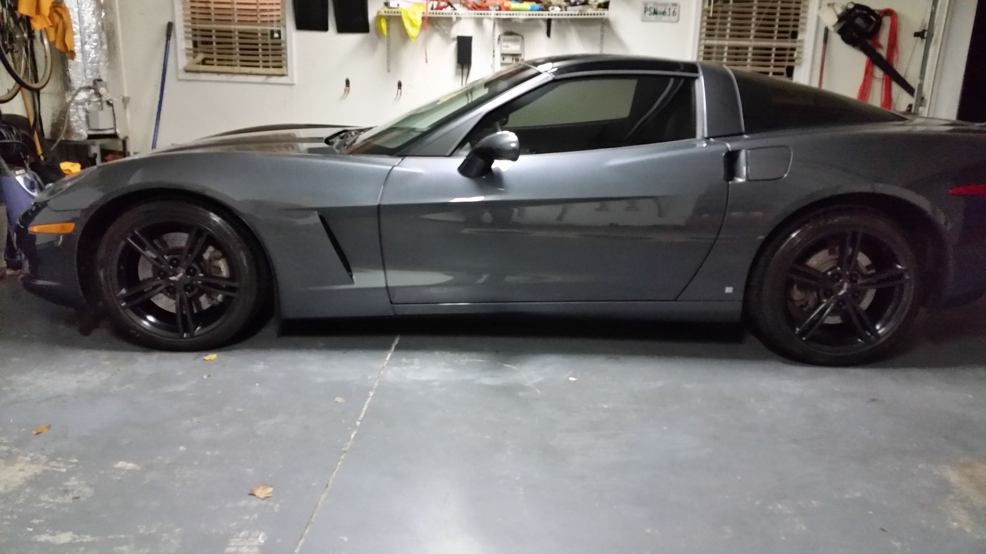

I did mine because I was considering buying black wheels and wanted to see what they'd look like on the car before spending a lot of cash. They came out great. I highly recommend a few coats of the clear over what ever color you go with. I drove with them thru the winter with no problems and they held up well.

Steve is correct, I did about 2+ years ago and still holding up well. Plus if I or the next owner of this fine machine want chrome back all they have to do is take it off It was originally a test to see if I liked my car with black wheels and now I wouldn't have them any other way

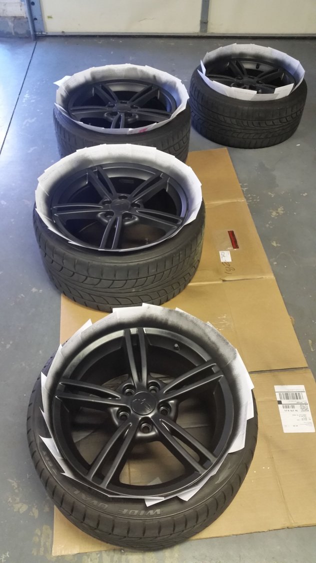

Just sprayed my friends Forgestar wheels in Superwrap. Came out really nice, powder coat like gloss finish. Takes about 10 coats with 2 coats of clearcoat.

They call it a sprayable vinyl. The finish is a lot better than plastidip in my opinion. Costs about $100 for the product. I'll send a pictures of the wheels I sprayed in a minutes.
