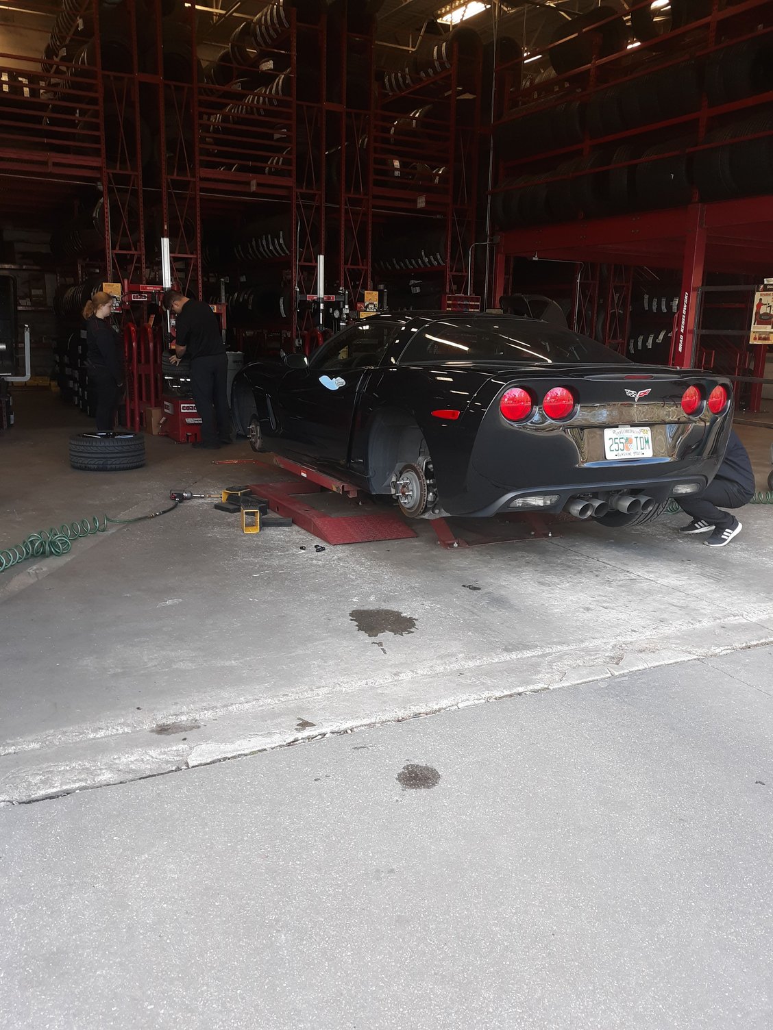

Default Update
I went to Discount Tire, and their tool picksed up the sensors. However, it is identifying them as 2005-2009 sensors, and advises that the sensors are "improper" (or something to that effect).
$300 later, the wheels and tires came off, and the proper sensors were put on. I think FSS (vendor) should.refund me for their tire sensors, and also pay for the new ones.
Also, discount tire used this kind of lift... Never seen this before! Ok to use?

Old Feb 9, 2019 | 10:48 AM
JABCAT's Avatar
JABCAT
Joined: Nov 2017
Posts: 12,759
Likes: 10,657
From: Prosper TX/Austin TX
Sent you a PM, and if they put pucks under there when using that quick jack you should be ok, if they didn't I'd check for damage.
Also FSS will ask for the TPMS back, so hopefully DT didn't snap them off like they did mine. They gave me a bag of broken TPMS back & I told FSS they could take it up with DT.

Old Feb 9, 2019 | 10:52 AM
spdkilz911's Avatar
spdkilz911
Joined: Aug 2012
Posts: 1,732
Likes: 44
From: Richmond TX
Like JABCAT said, as long as they used pucks that lift is fine.

Old Feb 9, 2019 | 10:59 AM
KingCorvette93's Avatar
KingCorvette93
Joined: Jan 2019
Posts: 558
Likes: 83
From: Tallahassee, Florida
No pucks... There was a rubber pad on each side of the lift that ran the length of the side skirts. But it lifted the car from the skirts, yes.
