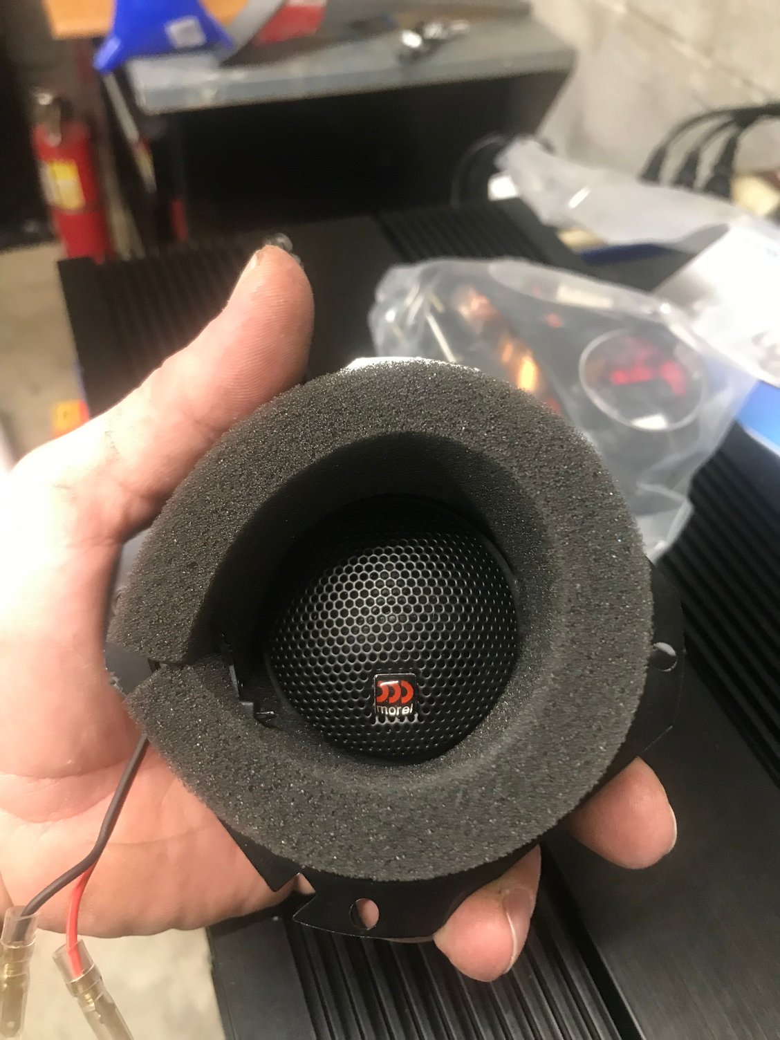

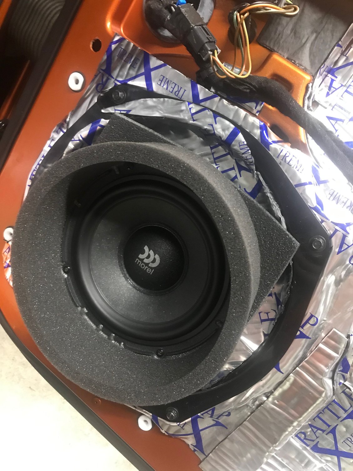

Get the speed rings too. It’ll help put all of the sound into the car instead of losing some in the door panels
Got the speaker plates from Amazon, direct bolt in
Originally Posted by TorchRedFred
I would recommend running new 14 gauge speaker wire.
My only other advice is to take a little time and make sure this is something you want to do. Your audio project is getting more complex by the minute and to do this properly you are also going to need to add a subwoofer and another amp to the equation. With my system I installed a 5 channel amp to power the front and rear speakers and also a subwoofer. Good luck!
Agreed, my audio project took almost 2 months of weekends. Although I took my time and Dynomatted the entire car it was a huge project. I ran 12 gauge ofc wire to make sure it was perfect. I didn’t try this but from what I’ve read about on here, for better sound if you don’t want to go crazy with everything you could just replace the head unit. I considered that first. Took about a month of thinking and planning before I ordered anything. Good luck with whatever you decide to do!
Just a tip, take your original door tweeter, cut the paper out, chisel the magnet off and you’ll end up with a perfect way to mount the new tweeters.
