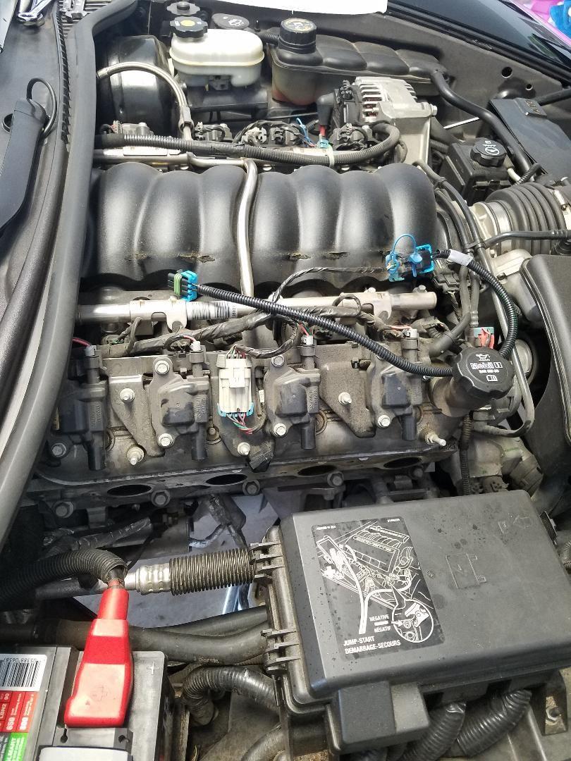

I just got my ARH headers back from being ceramic coated. I took out all the plugs and wires, disconnected the original mid pipe and im left with the manifold/catalytic converter. The problem i see is that the rear o2 sensors are still connected and i have no earthly idea how i can get it disconnected. Im stuck on both driver and passenger sides. Any advice on what i should do?

ok update i disconnected the manifold from the cats. So the manifold is out but the cat is still connected to the rear o2 sensor that i cant seem to unplug. I am trying not to have to cut it to make this work

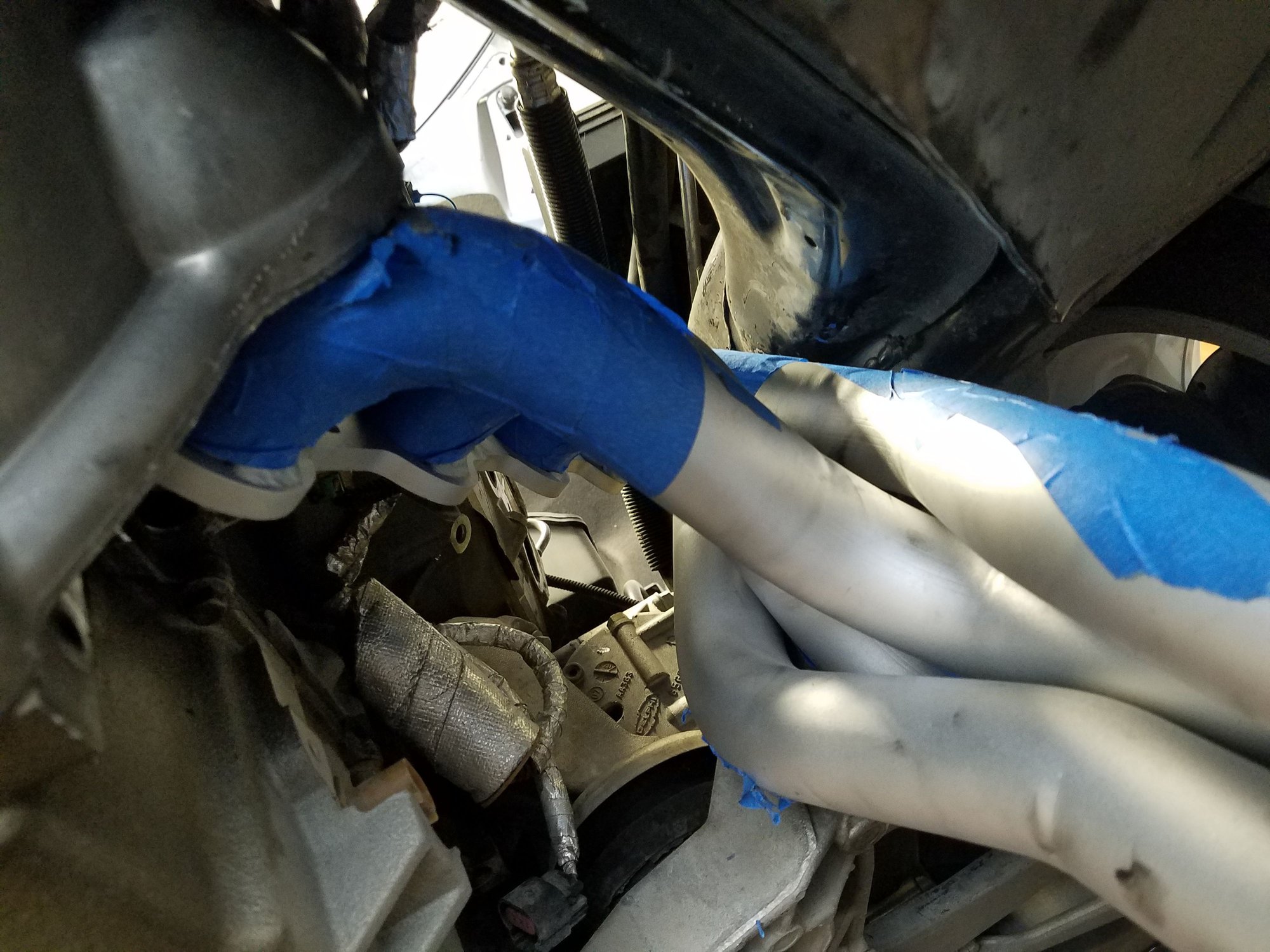

Ok starter is out but damn i cant get the header in on the passenger side. Is there anything else i should be removing?

This is DIY and im by myself. I got the driver side header up and in and its on the bolts just not torqued down yet until i can get the xpipe in. I am having a hell of a time trying to get the passneger side in. The starter is out everything looks to be out of the way but it feels like this damn header is too big.

i have tried to go in at every single angle...the right side keeps hitting the clutch housing or if i do get it passed the clutch housing it gets stuck on the other side..

Also the car is lifted about 30 inches off the ground unless im lifting it wrong i dont see how the passenger header can go in..anyone live in Leander/Crystall falls area ??

Sometimes you have to loosen one or both motor mounts and jack the motor up about an inch or so to get the required clearance.

I didn't have the trouble you're having. Passengers side (once the starter was removed) was a slam dunk. Had all sorts of room. You've got the car plenty high. I seem to recall the drivers side going in from underneath and the passengers side going in from up top. But still, starter needed removed. Been a while, I might be thinking reversed on that.

Most of all, don't get frustrated and do something stupid. As was already mentioned above, you might need to loosen a motor mount and jack the motor up ever so slightly to make room. Just be patient and get them in without making a mess of the coating.

put it up on an angle, so that the collector is almost under the oil pan.
not sure about ARH but my kooks went in like butter from underneath. i did not remove anything outside of the factory exhaust. the starter was still in place. i did this on a quickjack whatever the max height is.

Take a good look at this idea. I just did my clutch and lowered my engine by dropping cradle down about an inch on the cradle bolts. I then had access to the bellhousing bolts and did notice that it gave good access to exhaust manifold and the head.
So take a look and see up or down it might give you the little bit extra you need.
