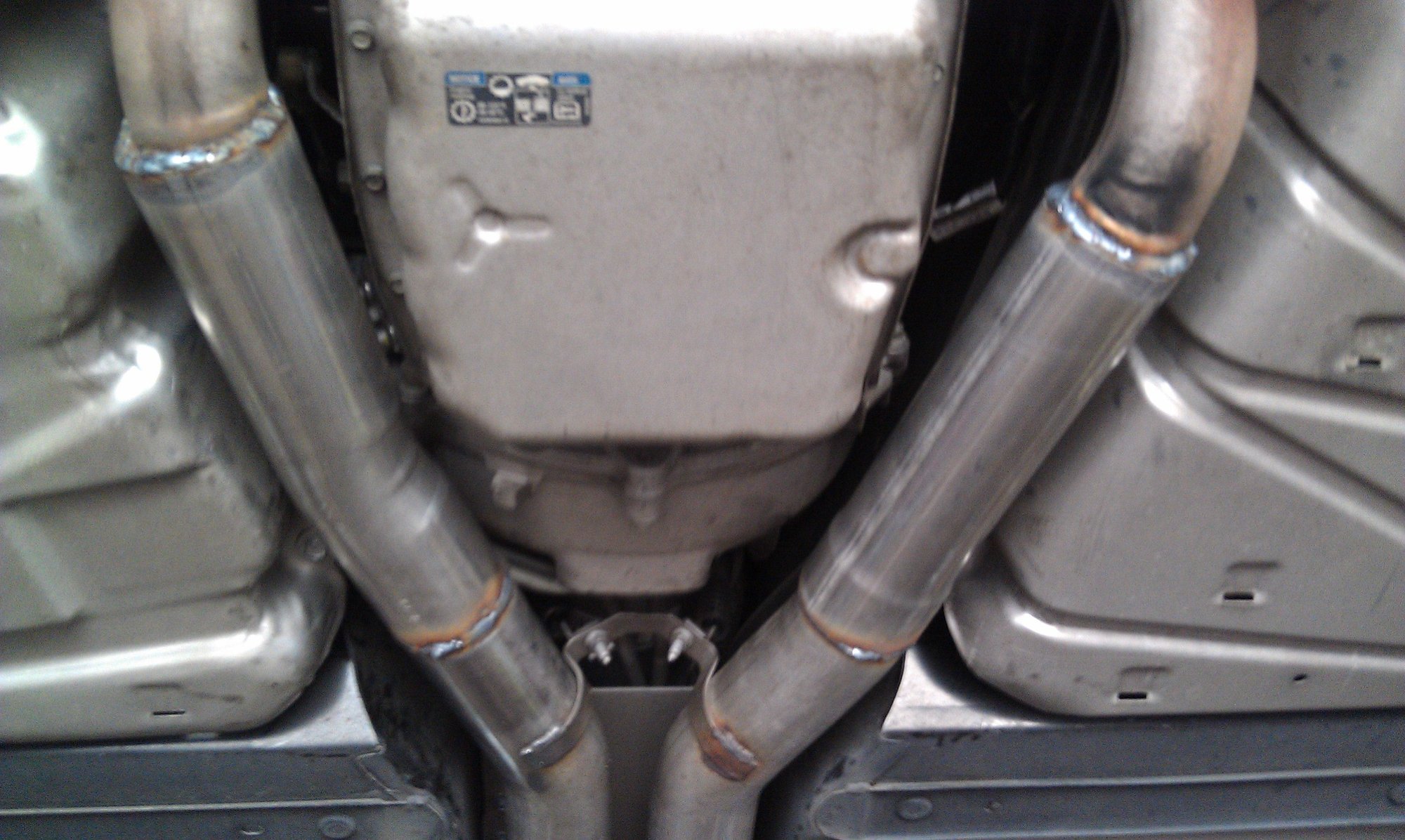

I actually have ZR1 (2009) manifolds, cats and mid pipe now. I had a muffler shop manufacture, cut and weld the 2.5" muffler pipe to the 3" X pipe. The OEM muffler pipe now slides into a 3" adapter and is welded at that point.
