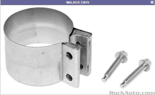

2. buy some quality exhaust clamps (see pic & part number above) . don't waste your time on cheap ones that LOOK like this as they WILL NOT WORK WELL. I tried three different clamps before these ones to get rid of my exhaust leak(s)
