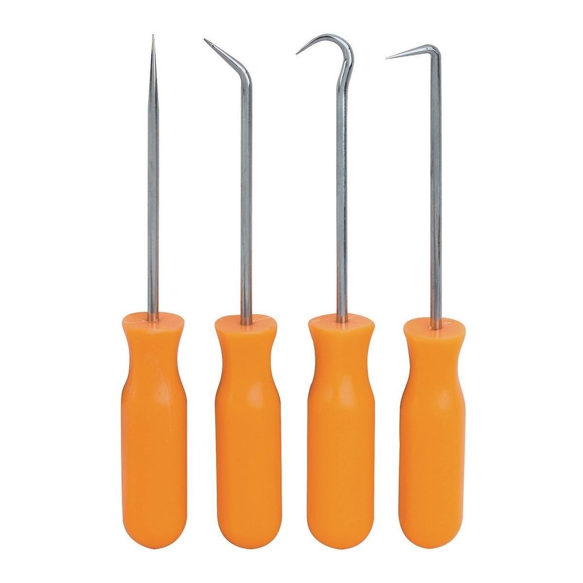

I bought a pick set at Harbor Freight when I broke mine... Good Luck!
