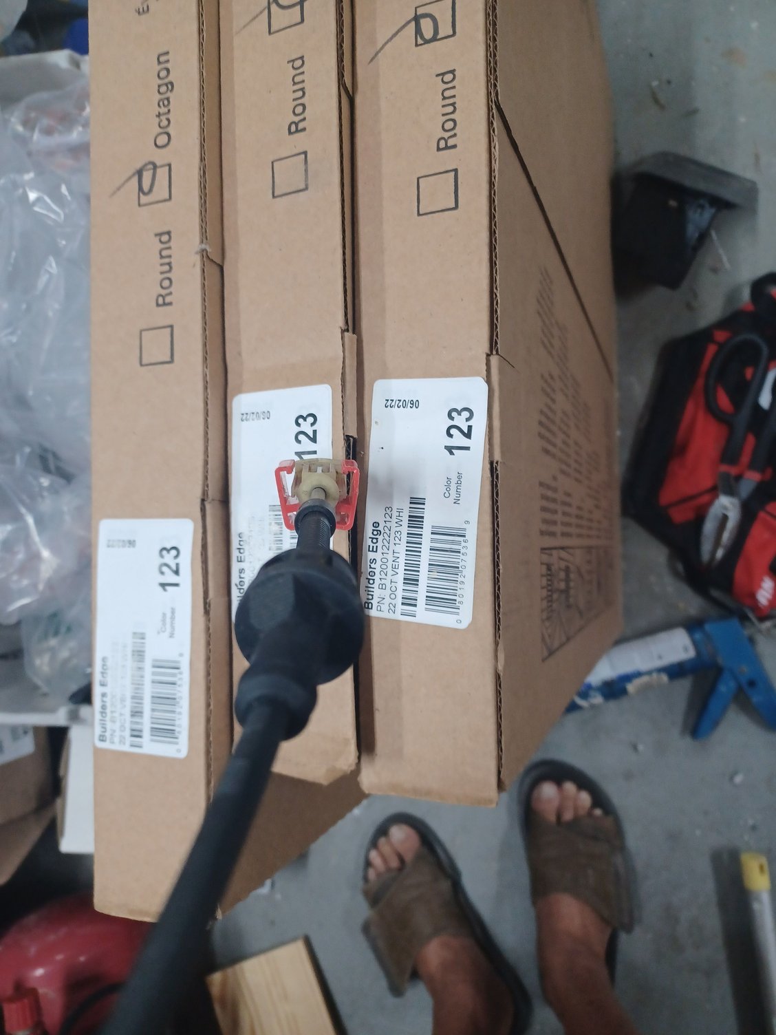

Take a closer look at first pic, I saved it and zoomed in, to me it looks like that cable end is put on backwards. My locking tab is faces away from the trans LH side of car. This one looks like the lock tab faces the trans, also the outer ball socket is on the tab side. If you zoom in you will see what looks like the locking tab (arrow) is in shipping position with red clip. Pic #2 is the way the cable is shipped unlocked to adjust cable end when in neutral. Pic #3 shows the cable end, big side socket that goes on trans lever ball with shipping clip attached. Pic #4 shows the cable end, locking tab side with outer ball side of socket. with shipping clip attached. Pic #5 shows shipping clip opposite side of locking tab, that will not work.

Forgot to add this Pic Yes the red clip will lock the tab in but it will need some trimming if you really want to add it.
The front has no lock .tab, only a ball and socket . The rear lock is to set adjustment of cable and it locks well enough with out anything else. The ball sockets are the weak point on the shifter cable.

XX the first picture you show above does have the cable end installed incorrectly. The red piece is only used for shipping to keep the lock from engaging.
I have repaired too many to count C5 shift cables and a couple of C6 ones. All had the lock pointing to the outside and no other piece to hold it.
Gary
Gary
I agree the red clip is only there to hold the tab in the unlocked position till install. If someone was to install the cable end backwards it would ruin the cable end ball socket.
