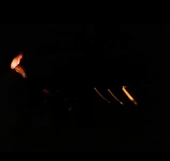

Hey corvettejoe2006, I actually put them into my GrandSport. It was a little bit of a PIA but was well worth it in my opinion.
You definitely want to take off the wheel to have more room to get access into the fender. For the life of me I could not figure out how to just remove the fender so I ended up pulling the tape off that they used to hold the backside of the fender to the fascia.
The PIA part was reaching in behind the fender between the two parts trying to shape the metal to properly fit.
The next thing is that they give you double stick tape which I learned the hard way will not hold for long.
What I ended up having to do the second time to secure the metal in place was to use clear silicon around the metal so when it dried it would really hold. Has not come off in the past 3+ years now.
The key thing about getting the silicon to hold is that you would need to come up with some kind of way to keep tension on the metal while it is in place to dry fully. I saw someone using a bungie cord to hold it in place.
I ended up doing the same thing where one end is on the metal the other was around my floor jack.
Oh and while I did that I also wired blinkers into the coves so they would look indicate to idiots around me that I'm trying to switch lanes. At least at night time it is apparent.

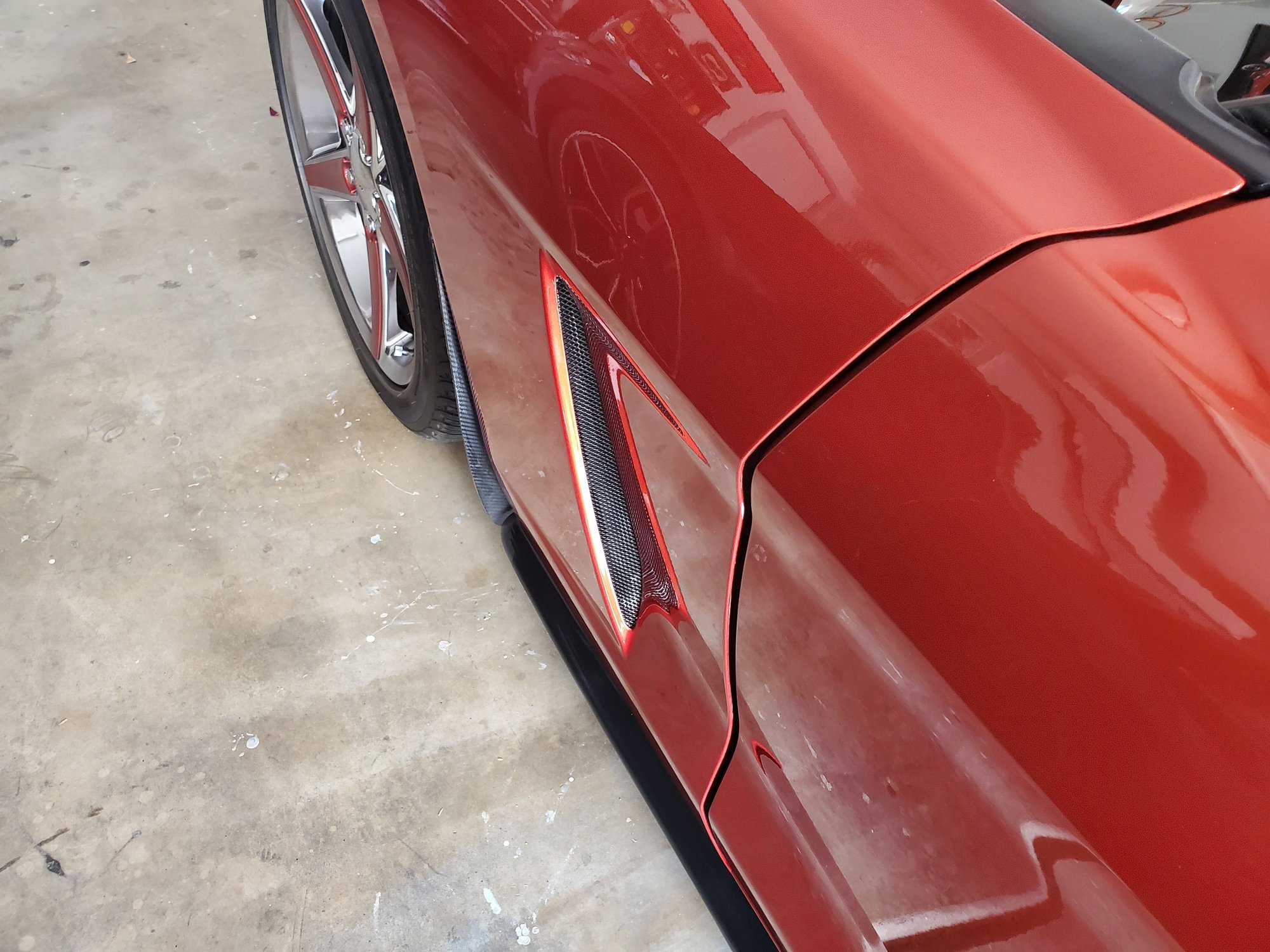

I did the install as well, and it was a minor PIA, but well worth it in the end. After this pic was taken, I added black door edge trim on the other side to highlight the grill opening. It matches the other black accents on the car.

Think they look good myself. I like Elijah's Grand Sport up there, not sure about putting lights in there though, but the grills look pretty nice. May have to look into that for my GS sometime down the road.
