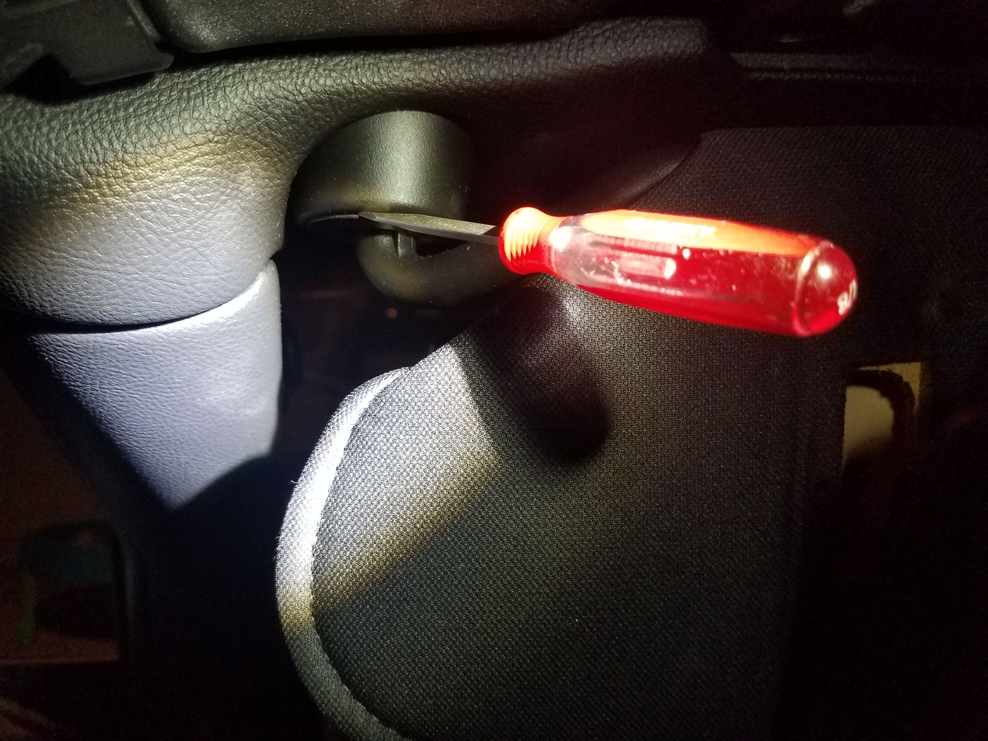

Originally Posted by rrmdeuce
I just took both visors off completely. Use a small screwdriver in the slot use the visor to leverage the screwdriver and twist the complete plastic housing with a downward pressure it will pop right off unplug it and you’re good to go
Is this where the screwdriver goes?

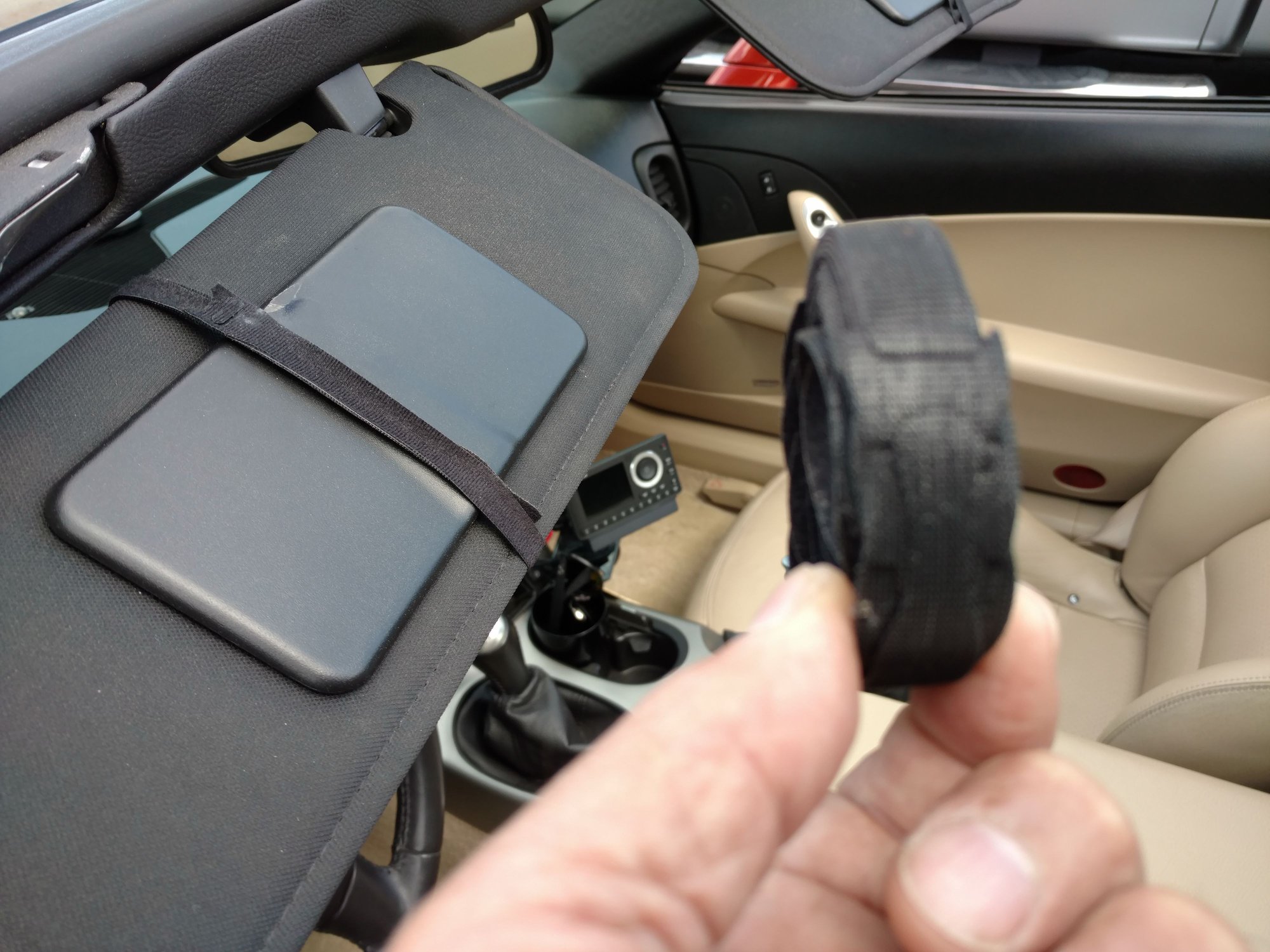

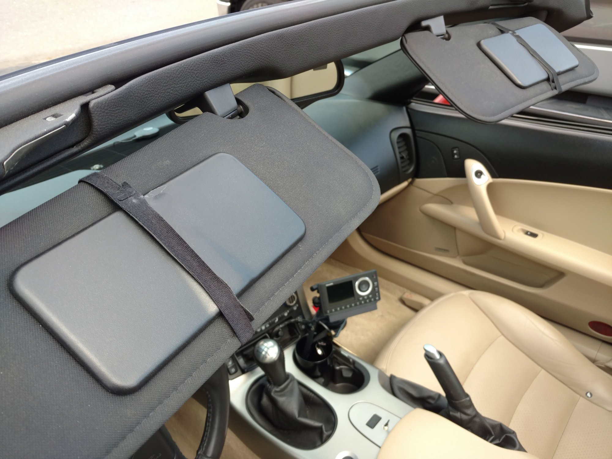

I don't use the Visor Mirrors anyway, so this was my solution, a couple of dollars at Target 1/2 inch Velcro Straps comes in a roll of about 25

No, screwdriver goes straight up. Then use the visor as leverage against a screwdriver holding the screwdriver up in the slot and pulling down at the same time twist the visor and it will pop right out. I then just unplugged it and left it out . Looks much better and visibility is improved Plus no cheap two dollars factory mirror
Thanks, I will give it a try.

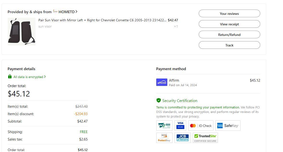

Originally Posted by cadbob
I bought these from of all places TEMU and they came with LED's installed They actually came surprisingly fast also, think it took a week. I'm very happy with purchase, still have my OEM's also which now have LEDS and Vanity Glued back, but sitting in box like all my other Upgraded OEM parts
Since they don't have Homelink buttons I decided to repair mine and it worked great.

Originally Posted by DaveJB
Wow! Thank you for this! I just ordered this and since I'm a first time Temu customer I got a $20 off coupon. So two mirrors for $19 instead of 1 from Chevrolet for over $200. Hopefully the quality is close.
Can't figure out how they could sell these for such a low price. Has anyone ever dealt with them before? Please let us know how the quality is, I have both sides broken and would like to replace them if these are decent. Thank you...
