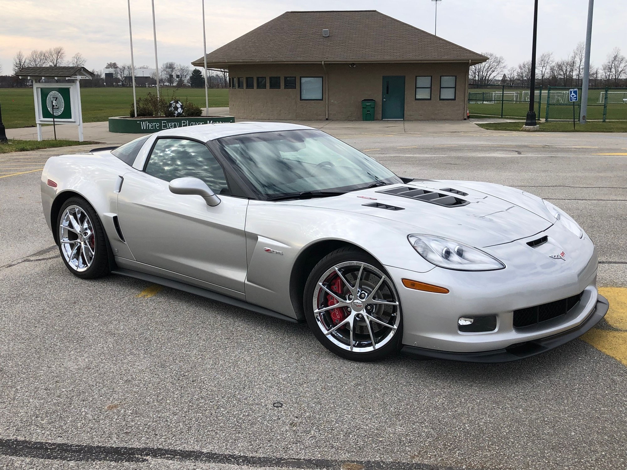

Plenty of options out there, Carbon Fiber $$$$$, ABS painted $$$ or ABS unpainted $. I went with the ABS unpainted, pretty much matched the OEM rear diffuser and widow trim. It's low maintenance, don't have to worry about paint scratching or chipping. At the price tag under $320 for side skirts and front splitter if anything should happen it's affordable enough to replace. They all look great, but for me, I couldn't do carbon or painted unless I had the rear diffuser in carbon or painted.

BTW-JABCAT, sweet ride, nice combo with the black wheels and painted splitter and side skirts
