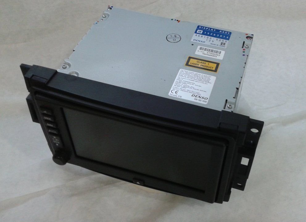

In dash factory nav won't read the disk on a 2008. Nothing happened it just stopped working. I did the compressed air/freon spray in both slots and bought a new Nav disk. No joy. Sorry if this has been asked before. My search feature does not work.

To the question. It's possible that the Nav laser lens is dirty enough that the compressed air will not clean it adequately. You can try a CD/NAV cleaning disc (a good one) and see if that helps. If that doesn't work, then try disconnecting the battery and see if that clears any faults in the player. (re-index windows) once you reconnect battery.
You can try the battery disconnect first if you want to try that.
If all that doesn't work then.....
If you are willing to take the radio surround console out, and remove the Nav unit from the car, then it is possible to remove the top CD player, and get access to the top of the Nav unit to manually clean the laser lens.
If you don't want to do that, then you will either have to buy a used unit, or an aftermarket unit.
Removing top cover:
  • The top CD metal encasement can be accessed by removing the top HU cover. The CD encasement and the bottom DVD encasement are attached to the back portion of the HU using small screws.
  • With the top HU cover removed, the top of the CD case is accessible. The CD laser lens is attached to the sliding tray that tracks the CD. The top of the sliding tray can be manually moved towards the back side, and the lens can be seen and cleaned with a Q-Tip with alcohol. Once cleaned, the sliding tray can be moved back into it's original parked position.
Unfortunately, the top of the DVD cannot be accessed without removing the CD player. The CD player can be removed from the case by removing the small screws in the back of the HU, and also the front screen has to be left open prior to disconnecting the unit power conector.
See the attached thread on the experimentation that took place to get to this stage. Lot's of pics of a broken Nav unit that i took apart, and with help from Kenny94945, he did manage to remove the CD player to get access to the NAV laser lens to clean it. (post #37)
https://www.corvetteforum.com/forums...g-it-up-2.html
