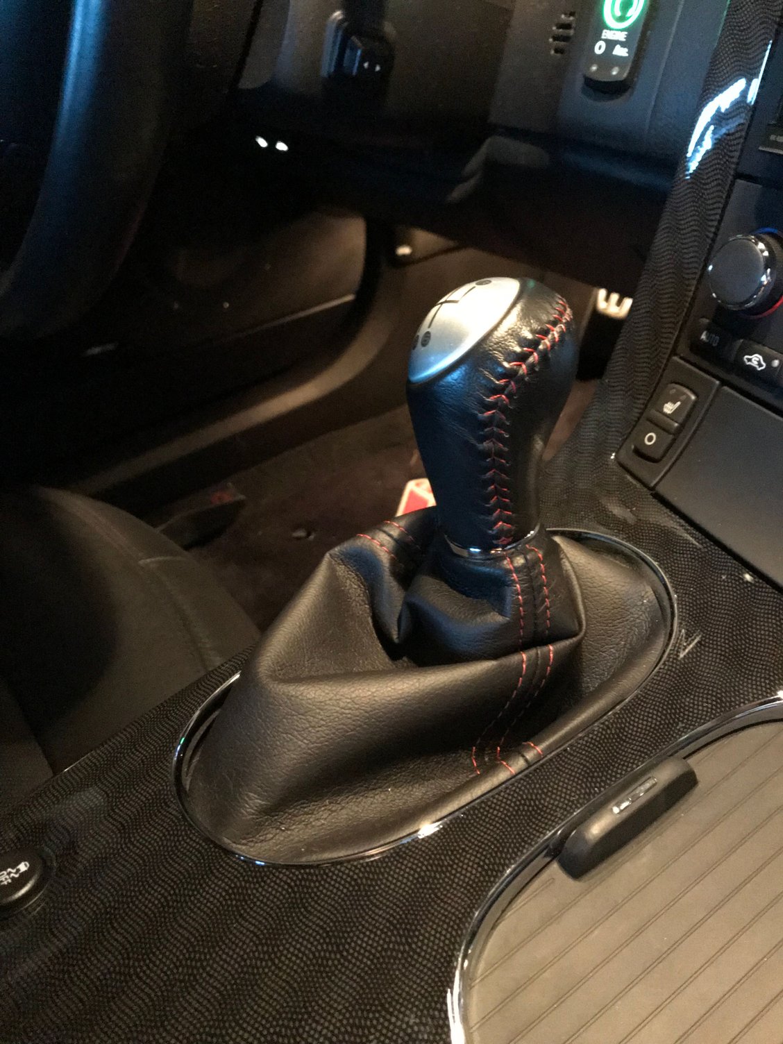

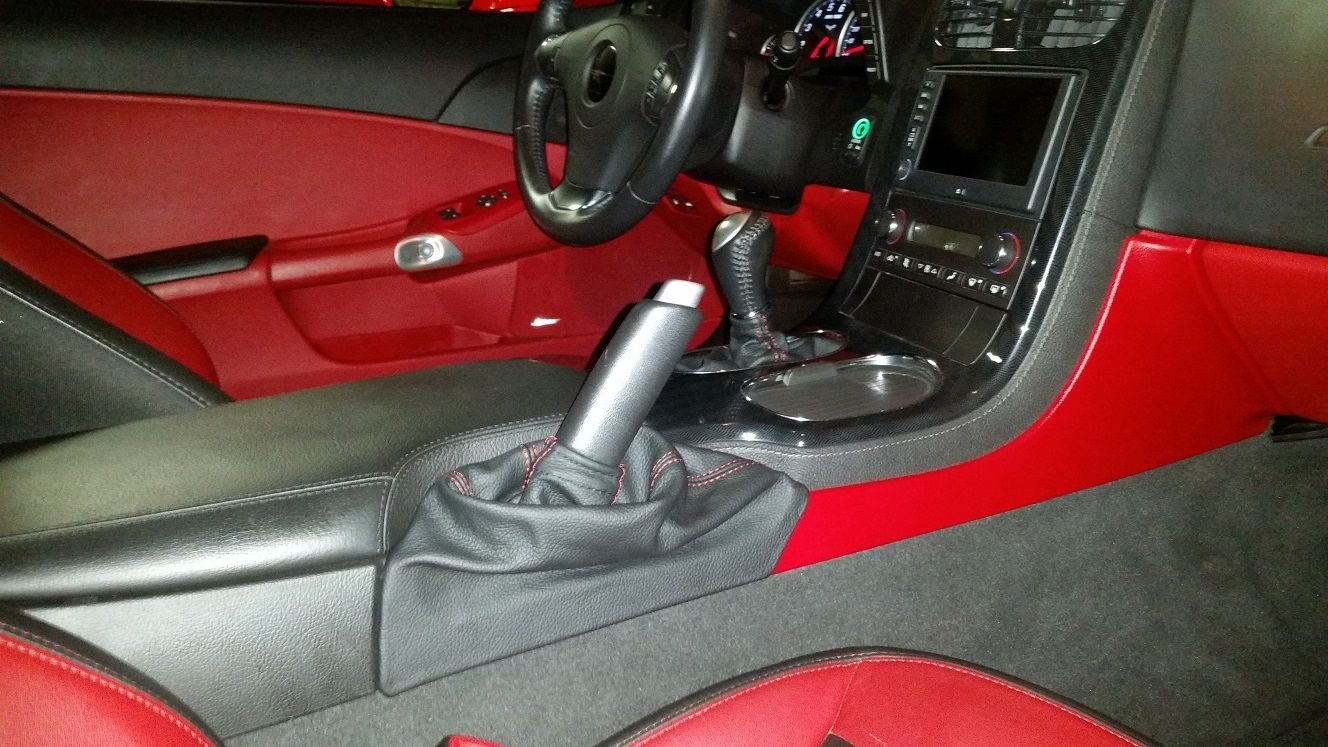

Here's a pic of the Redline shift and ebrake boots I put on last night because I don't want to start a new thread about just this.

About the shift boot and e-brake, looks great. Don’t forget about the shift **** with red stitching. I got one, looks great.

Thanks. Yeah, I thought that after looking at the pictures I took. Because the boot stitching lines up with the shifter, it stands out.
