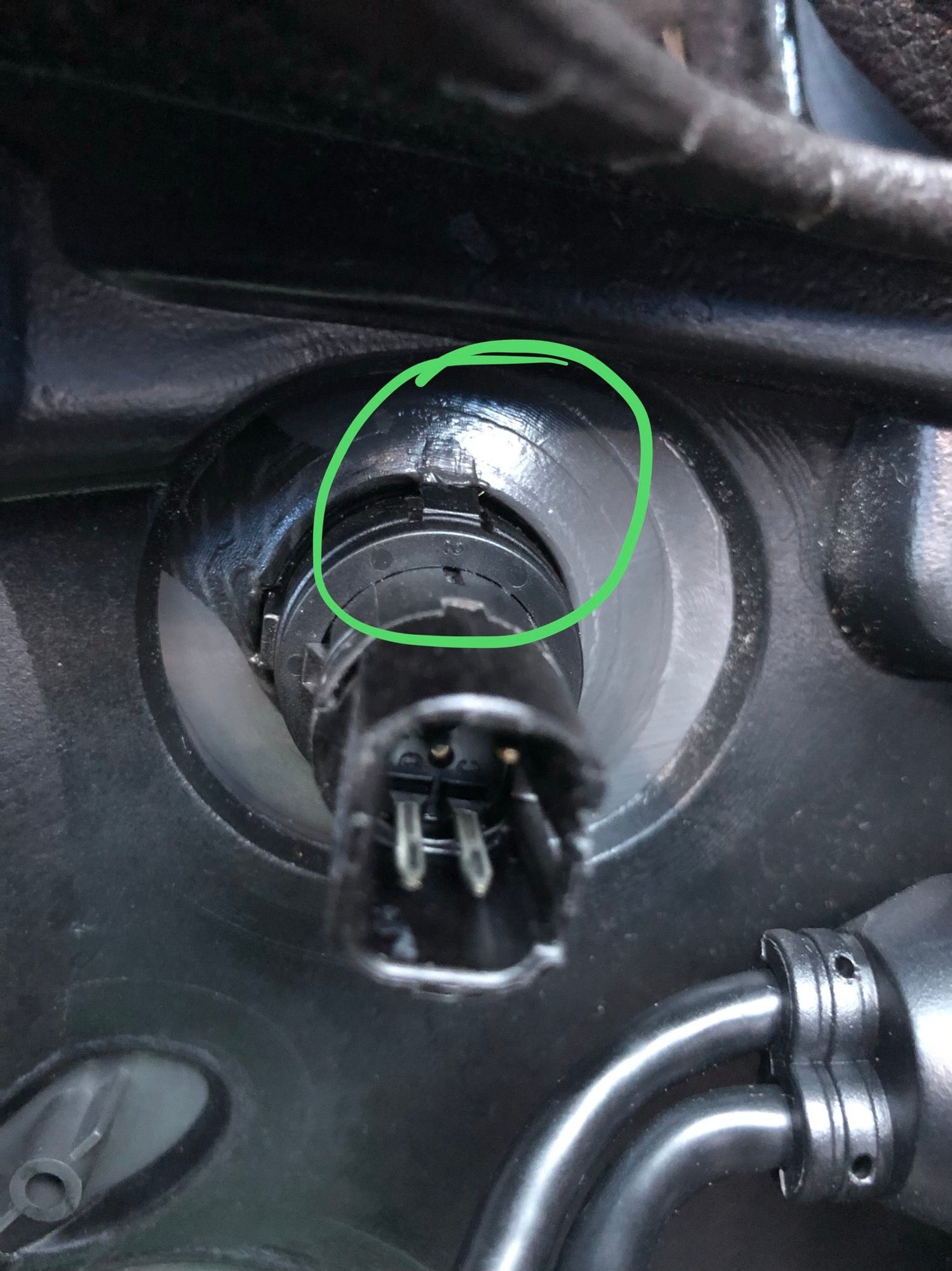

Had to open up the center for camera wiring, and might’ve broken the traction control button. It won’t click anymore and just stays down.
Any idea if it can be fixed or will I just need to replace it?
Tried taking it out but only only one side will get loose and other side seems like it’s stuck.

So it doesn't push down or up, it's just stuck downwards

I borrowed this picture from another thread, but under the traction control button there should be this rubbery cup or thimble looking thing. This acts like the spring or spongy like resistance that gets pushed in and then pushes the traction control button out. If you ever took it apart before, this piece may have fallen out. If you can't get it working right, you can order the entire TC button off Amazon for like $16 with prime shipping.
