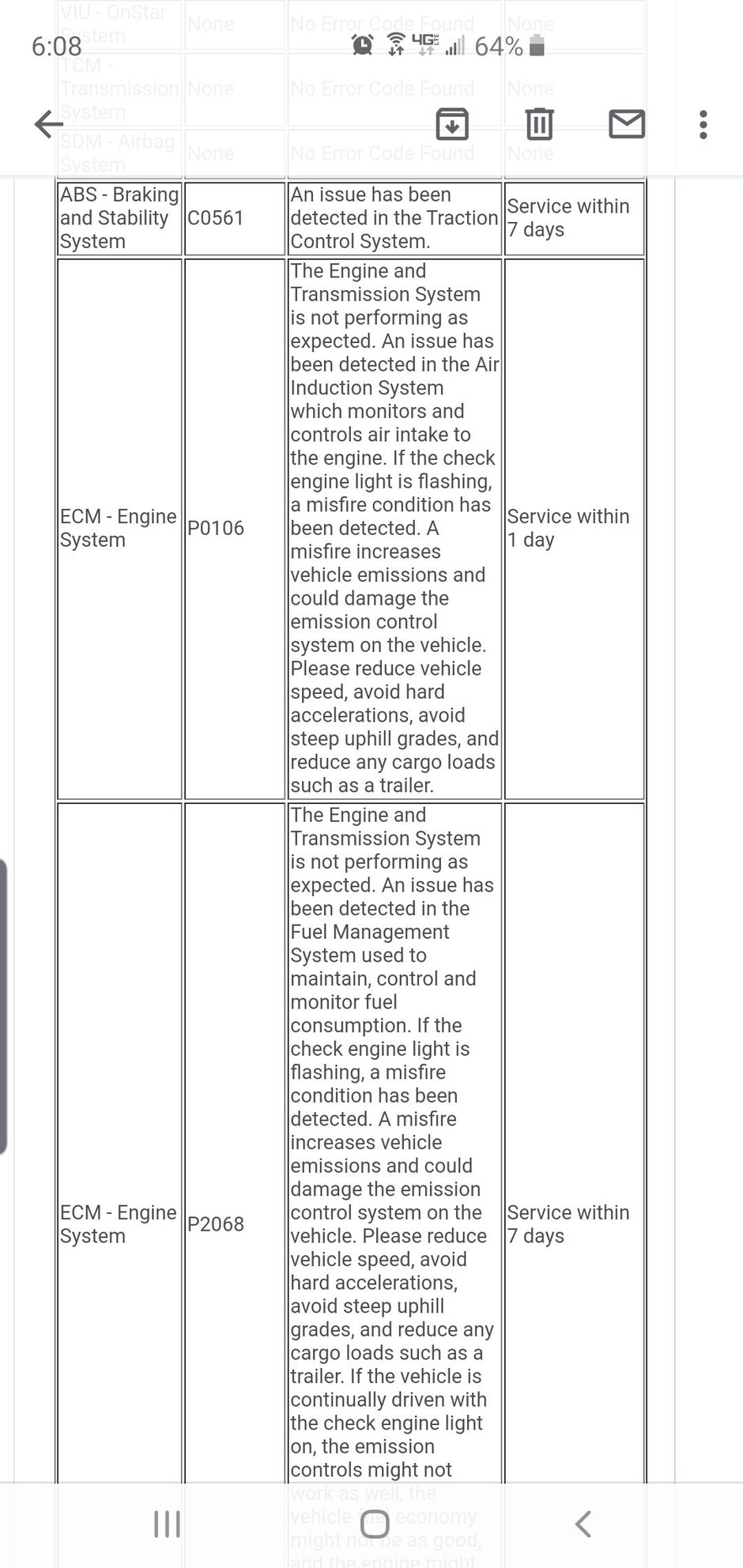

This is what onstar sent me regarding the coded its throwing.

I had all those codes but when I pulled the fuel rail covers off the drivers side rear plug wire was off. Put it back on and all was well. Surprisingly frequent problem although the affected cylinder varies.
