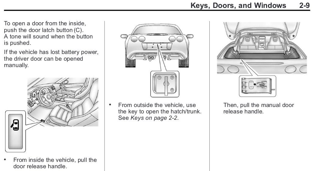

Hi Guys I have a big problem I have not started my 2008 convertible in a few weeks The windows went down a few inches but the doors will not open and it is going to rain soon If the battery is dead how can I get to it?
Thanks Tom

take key out of FOB
insert key into trunk lock, open trunk

car is a convertable
Pretty sure the instructions apply to all of them...
here is a video too...
To battery dead?
