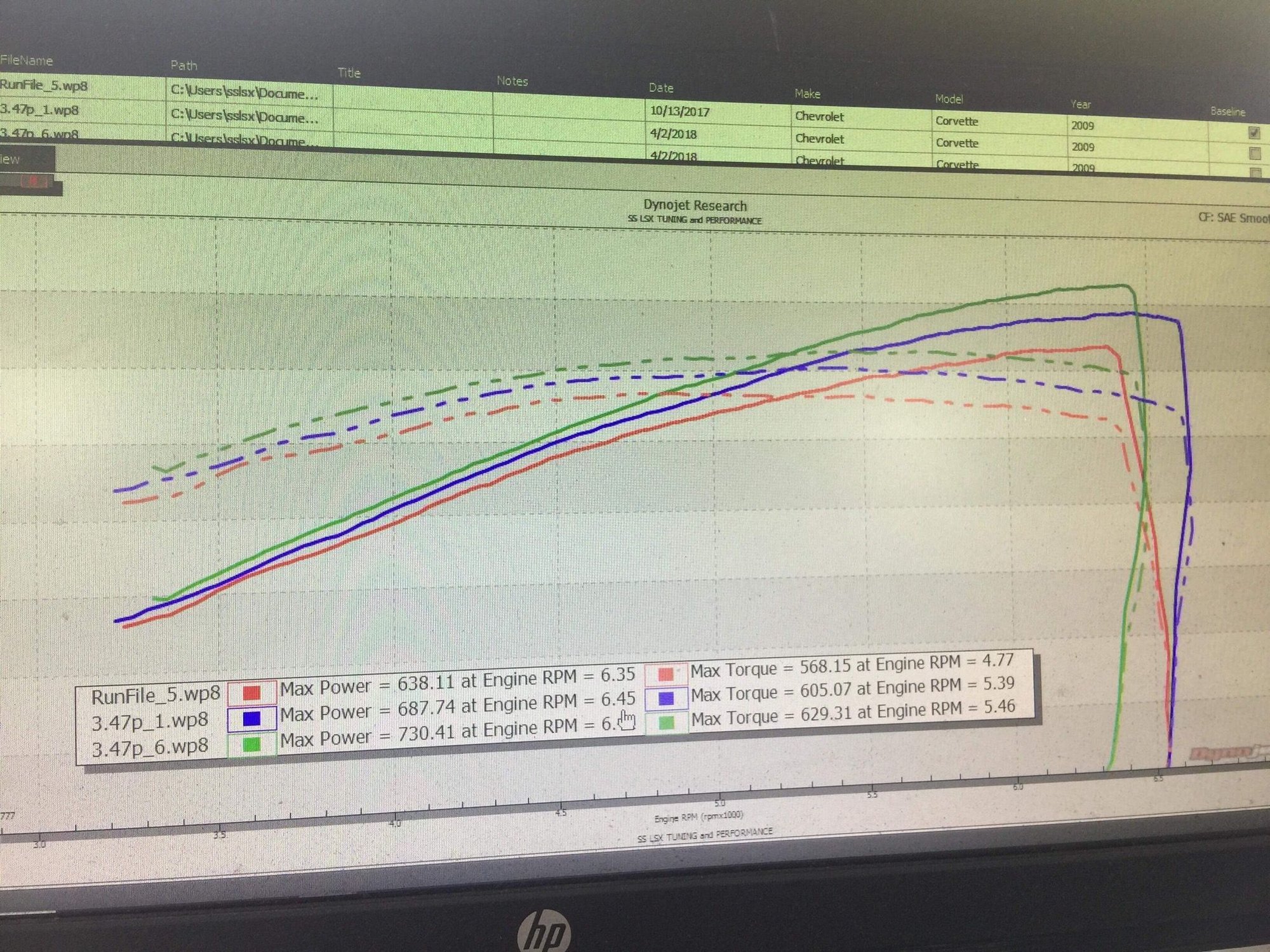

Old Feb 13, 2020 | 10:13 AM
sonnysucks's Avatar
sonnysucks
Joined: Jun 2019
Posts: 381
Likes: 58
From: Pittsburgh PA
I went from 687 - 605 on pump 93 to 730 - 629 on e85. Supercharged, if you are going with a charger, flex fuel all day. I have the fore triple pump and rails with ID1300s.
