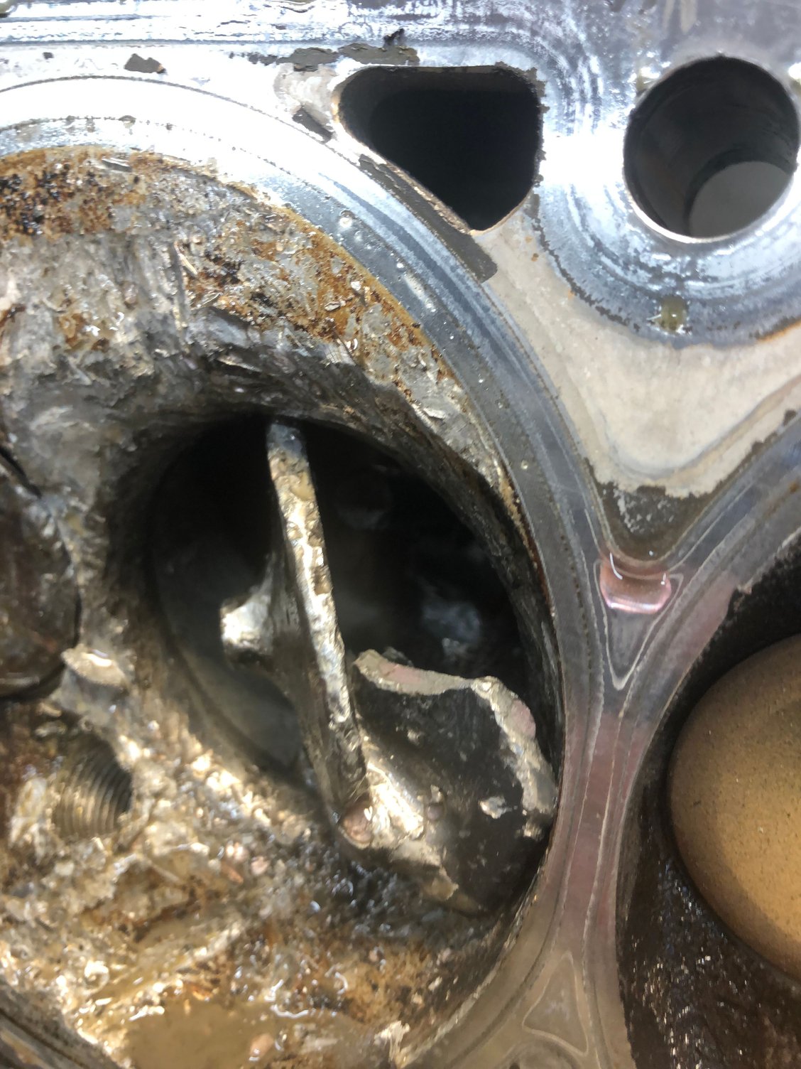

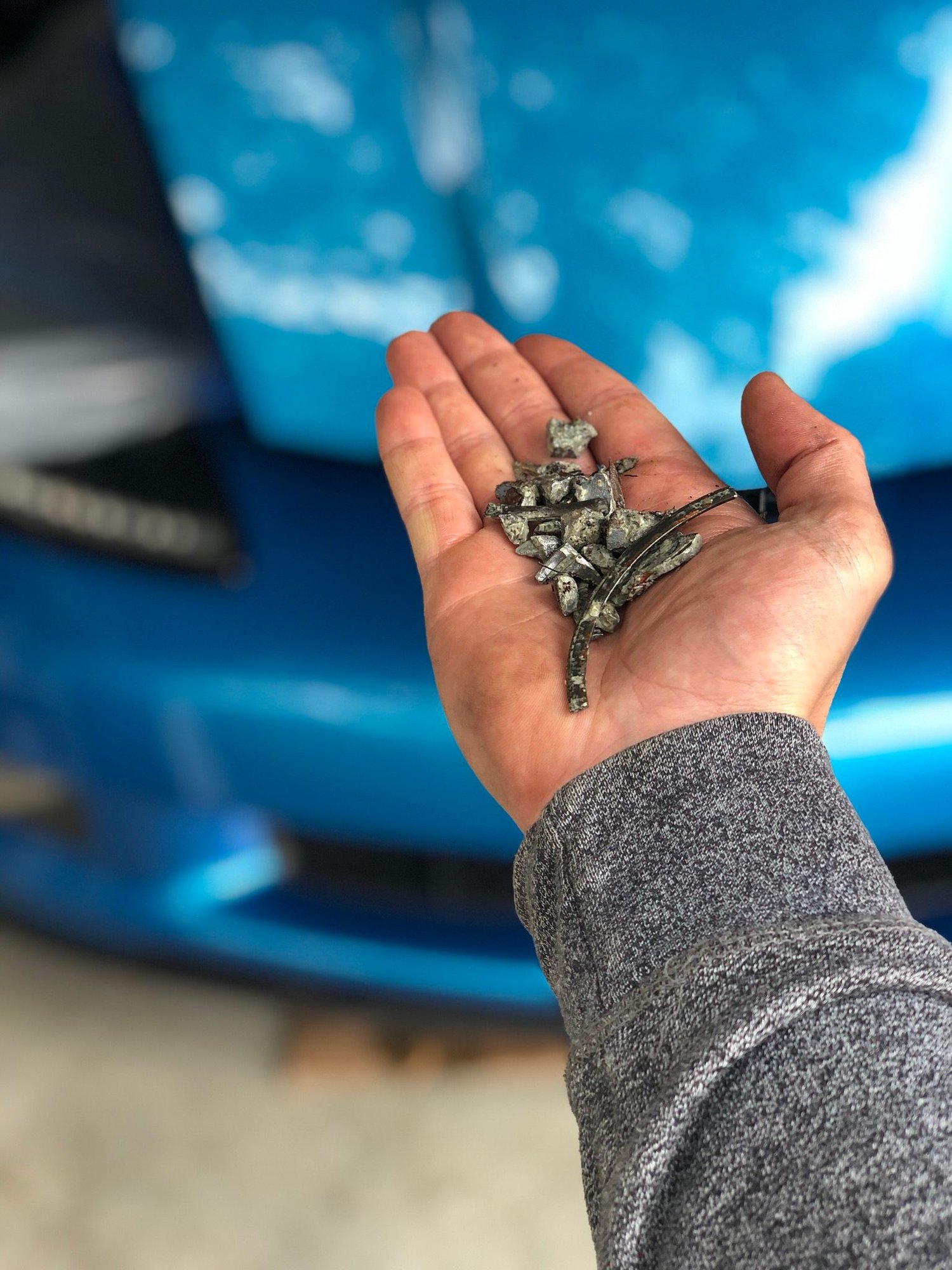

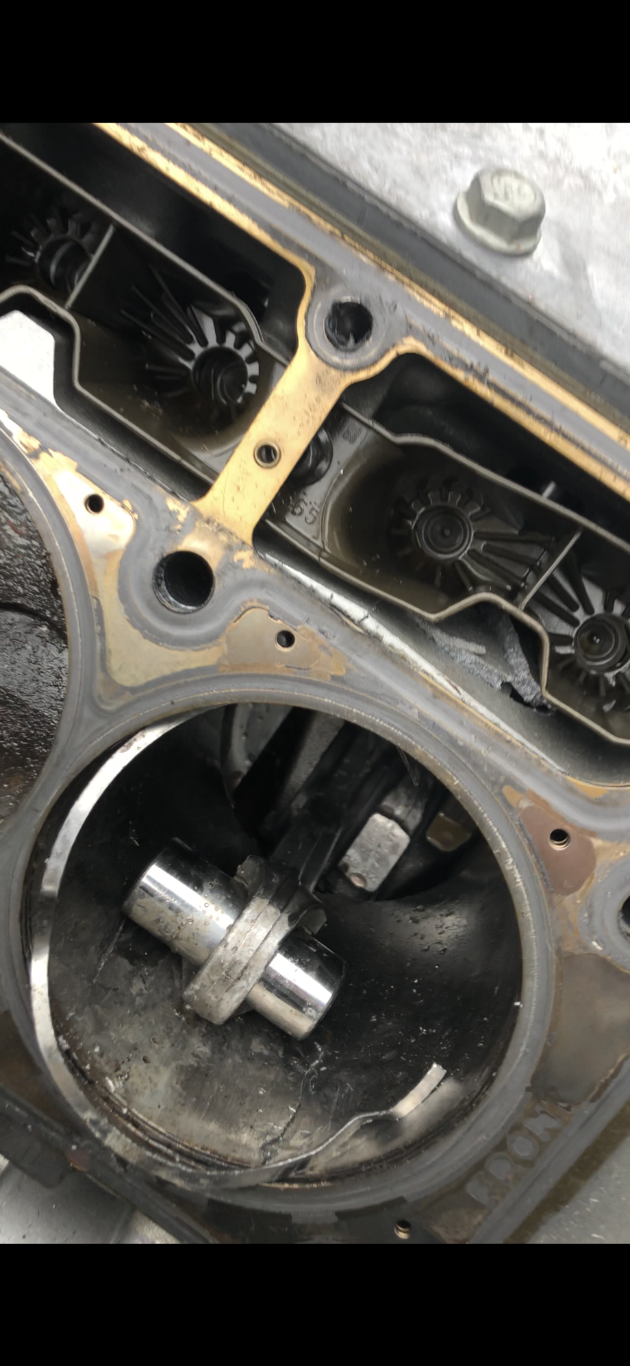

Good Evening vette family. So I recently had a valve drop in cylinder 2, even though they were “fixed” by LG Motorsports. The damage is catastrophic. Having to do a full motor rebuild. My question and concern is: Other than replacing oil cooler and oil pump, is there anything else you wouldn’t use? Second; How would you flush the lines and anything else, to make sure there is no debris that enters the new motor/system. Any threads, videos, and guidance is greatly appreciated. To show you how bad it is, I will give you a little taste with pictures and a video(if they post). Thank you for your time and help!

Damn. Sucks to see and hear. You'll be cleaning metal frag out of that for a long time. You're already tracking on the oil system, but in addition...the coolant passages were compromised, so metal is likely in the cooling system as well. Won't affect the new motor per se...but expect to do 3-4 cooling system flushes to get all the flakes out.

Valve drop in cylinder 2. Piston went through the side of the block and cracked it all the way around on cylinder 2.
