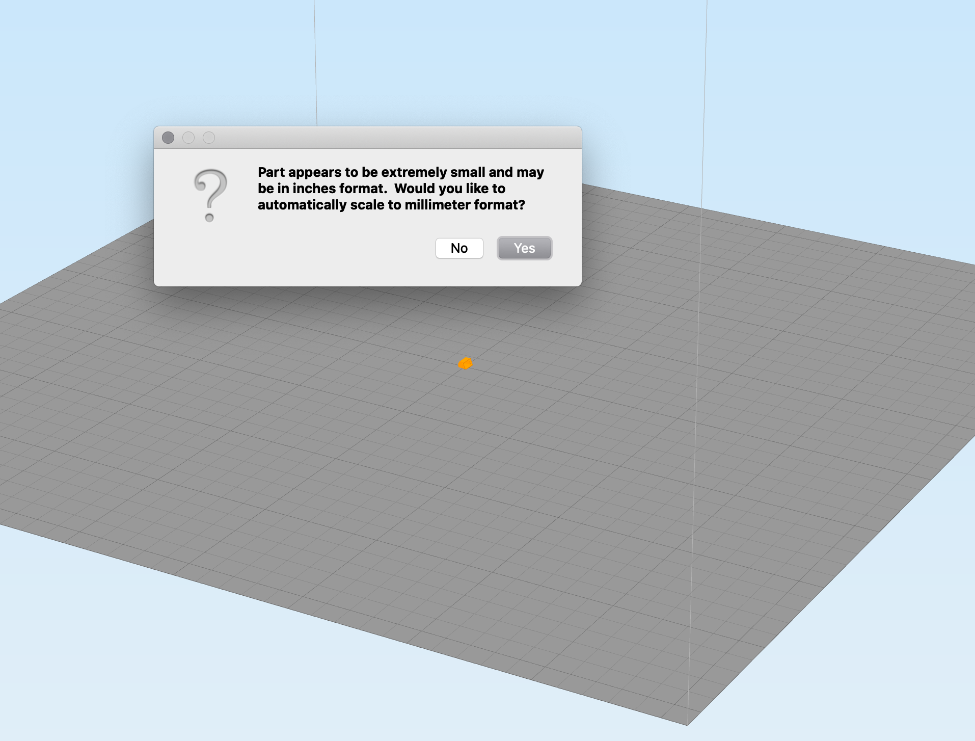

When I import the STL file into Simplify3D or TinkerCad it comes in super tiny. Seems like there is a scaling issue? Never seen this before in any other STL file I've worked with...

Scale it for mm. It is designed in inches.
