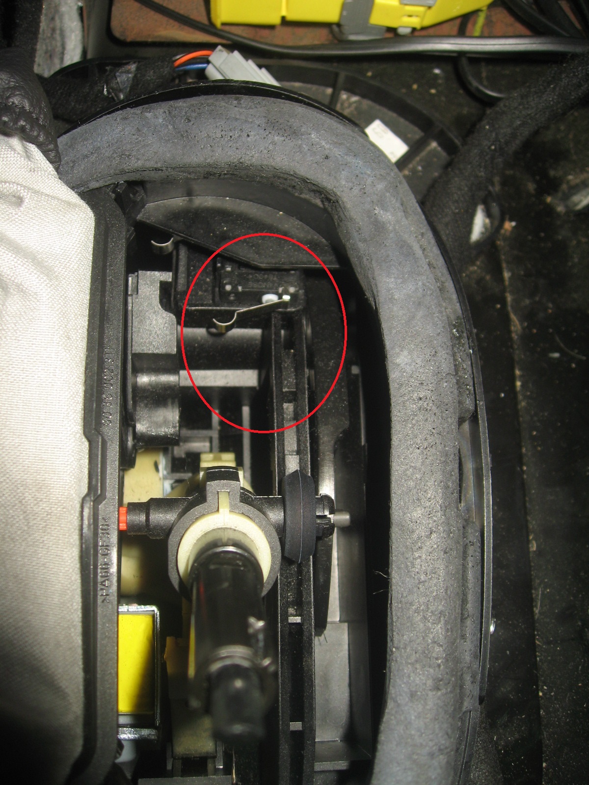

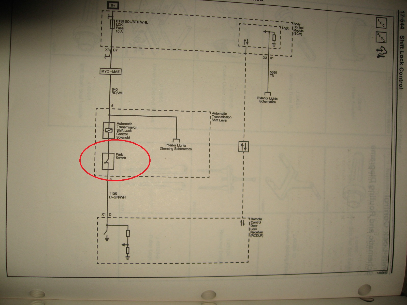

Does the DIC say Shift To Park" ? If so, then it is likely one of the 2 micro switches located in front of and at the base of the shift lever. Make sure your shift lever is as far forward as possible, Try starting. If it won't start, carefully listen for the click of the 2 micro switches as you move the lever rearward.
Micro Switches (one below the other):
Micro Switch Circuitry:

my 08 is an automatic, i did move gear shift to drive just to test this out, and it says put in park to start. I do not hear any clicks, i even tried holding both in by hand, still no start. I have checked all fuses, not one bad. Why is my steering not locked? Does that have something to do with the not starting?
