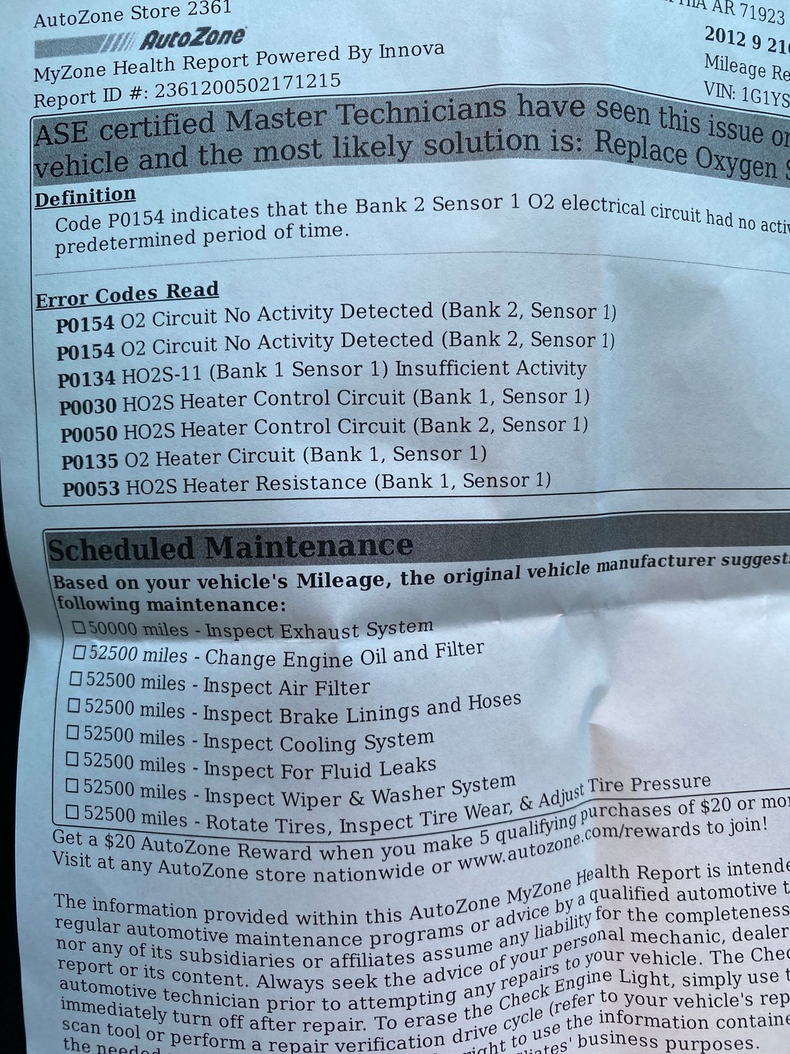

What codes are you getting? P0420 and P0430 are pretty common with headers.

the previous owner was meticulous about his car and told me it definately was, I can insert the codes I got from auto zone

these are the codes
