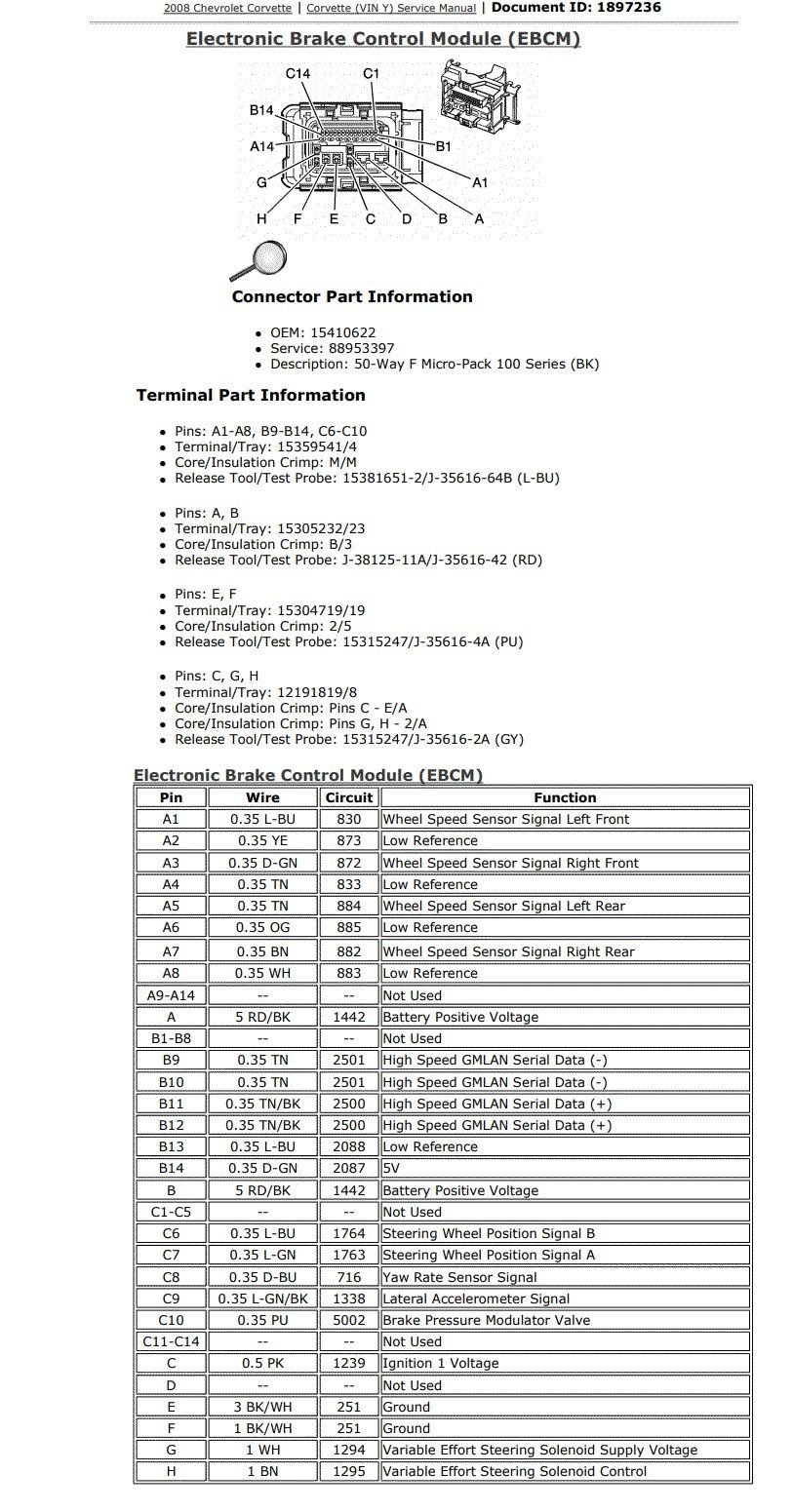

Do anyone know where I can get a ebcm connector or harness ? Mines burnt out !!!
Anyone know where I can get another ebcm connector harness ?

You can try aescorvetteparts.com they are a vendor on the forum here, and they carry a lot of corvette parts. I’ve ordered from them with no issues.
Good luck. That looks nasty.....

Try https://aescorvetteparts.com/ for a used one.
Here is the connector details
