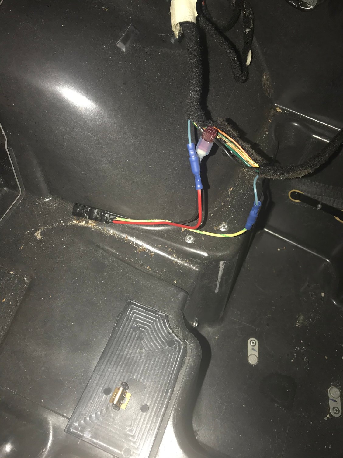

I bought a ‘12 GS a short time ago and just removed the rear carpet to install a rear camera, Kilmat and a new head unit. Just found this by the RR fender. Any idea what it is? Mild to Wild or something similar? I bought from a dealer so I can’t ask a prior owner.

It is a powered printed circuit board but don't know what it controls. M to W is normally done in the passenger footwell fuse panel.

Anyone know what the light blue wire runs to?

Where does that cable harness run to going back?

Third brake light flasher?
Goes into the rear panel under the hatch.

Some kind of vehicle tracker ?

Looking at the 2006 color coded electrical schematics, that light blue wire is going to the third brake light.
Could it be a set up to make the third brake light act as a strobe?
This is just a wild stab at it, but that wiring harness has the same colored wires as my 2006 schematics.

I have a third light flasher, and it connects right to the third light connector, it ballets. Nothing in that locations.

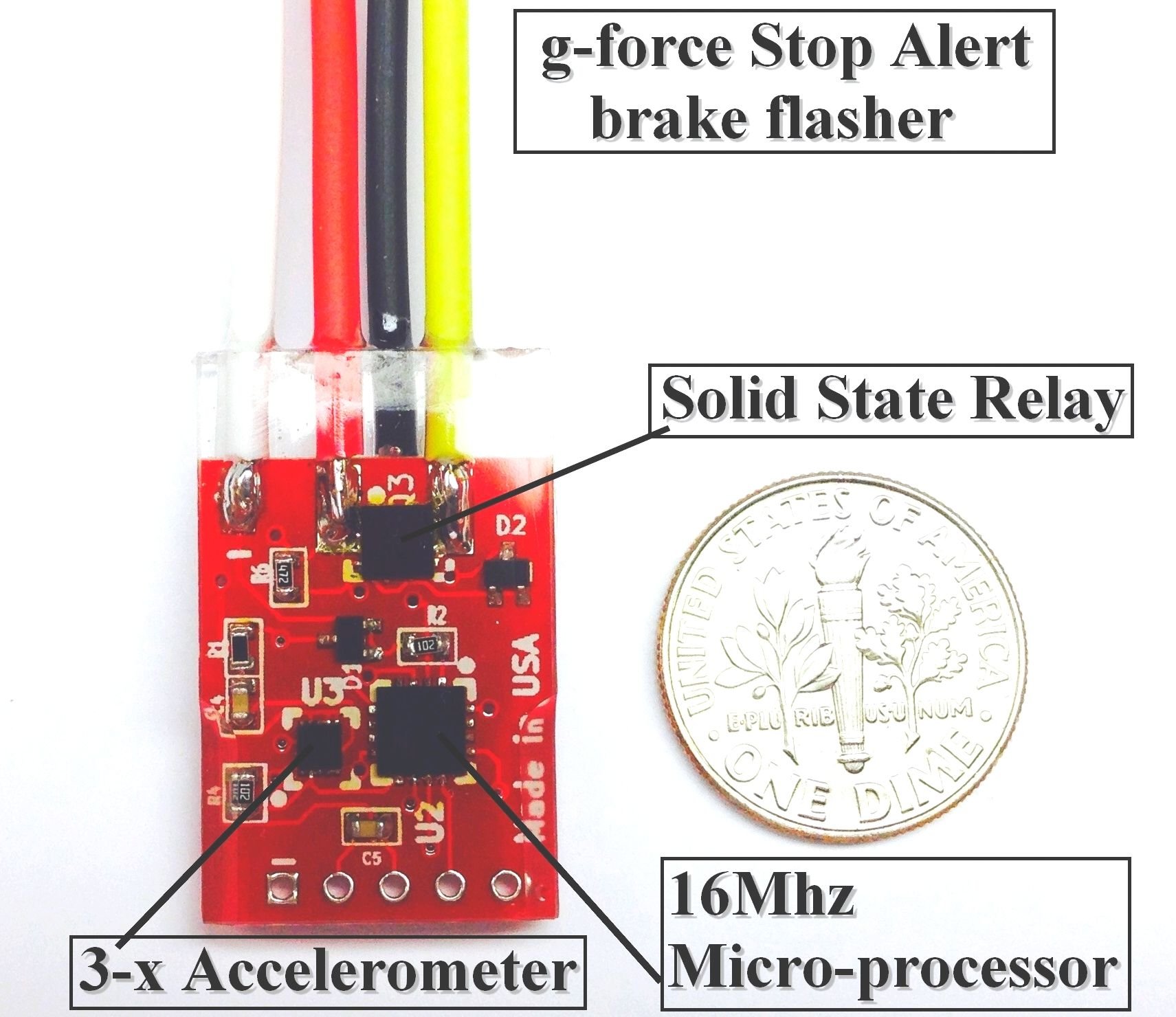

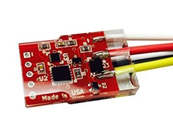

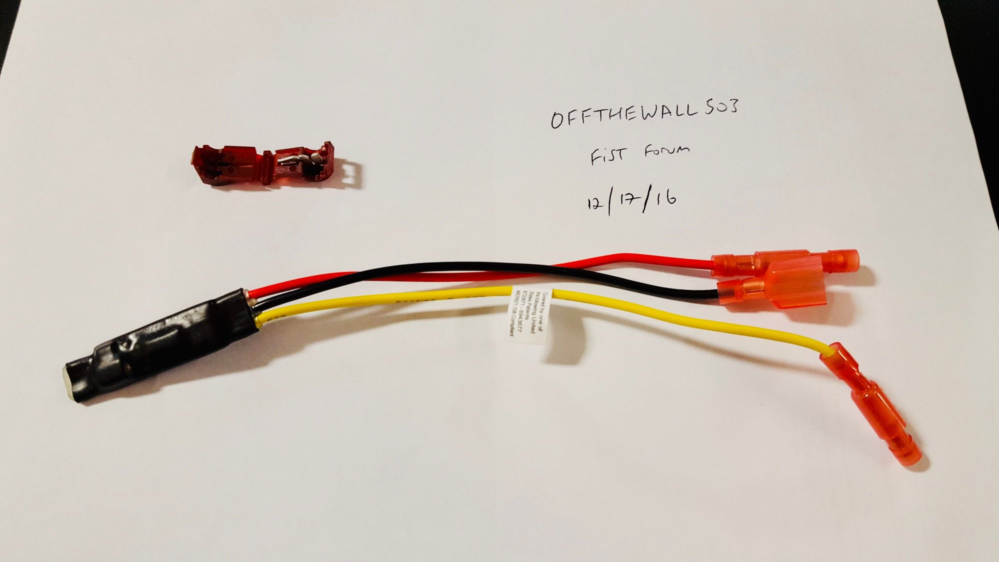

The newer flasher modules are tiny and programmable. I think I spot the OP’s on a Fiesta site but there are many others available.
https://www.fiestastforum.com/thread...-module.12200/
Others even offer an accelerometer to detect sudden, hard braking and flash the brake light faster.

Mystery solved, it is a flasher.
