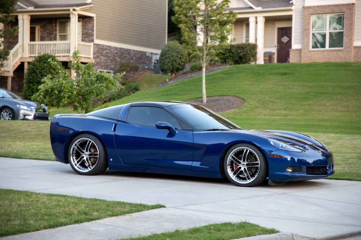

It's time to start working on the 2007 C6 Corvette. I've been debating whether to upgrade it for a while now or sell it. I finally made up my mind: I'm keeping it and I'm upgrading it. I'm going to be starting off with the suspension. Unlike my C5, with the C6 I am planning on keeping the leaf springs, for now. That means that majority of the process will be in removing the components, cleaning them, eliminating any rust, painting them, and putting them on. Since I am a clean freak, most of the body components will come off, and the Corvette will be thoroughly cleaned.
The headlights will be painted. Although I do like the blue on blue color combination, I think I would prefer them black. Now I have to check and see which finish I like: matte or gloss. I'm debating on whether to gut the interior and redo it with fiberglass or keep it as is with the exception of swapping out the steering wheel and seats. The car already has the Hurst Short Shifter and an in-dash unit, so I don't see the point in upgrading those. Engine upgrades might mirror the C5 project where I take apart everything, properly clean it, replace all of the wear and tear parts, like all the pulleys, belts, gaskets, and some other parts like the timing chain, oil pump, harmonic balancer (crank pulley), cam, and rocker arms. Decisions will have to be made once I get there since I'm thinking about either Supercharging it or Twin-Turbo Charging it. I haven't decided on either yet. But, that will dictate what type of headers I get, as well as a few other engine components.

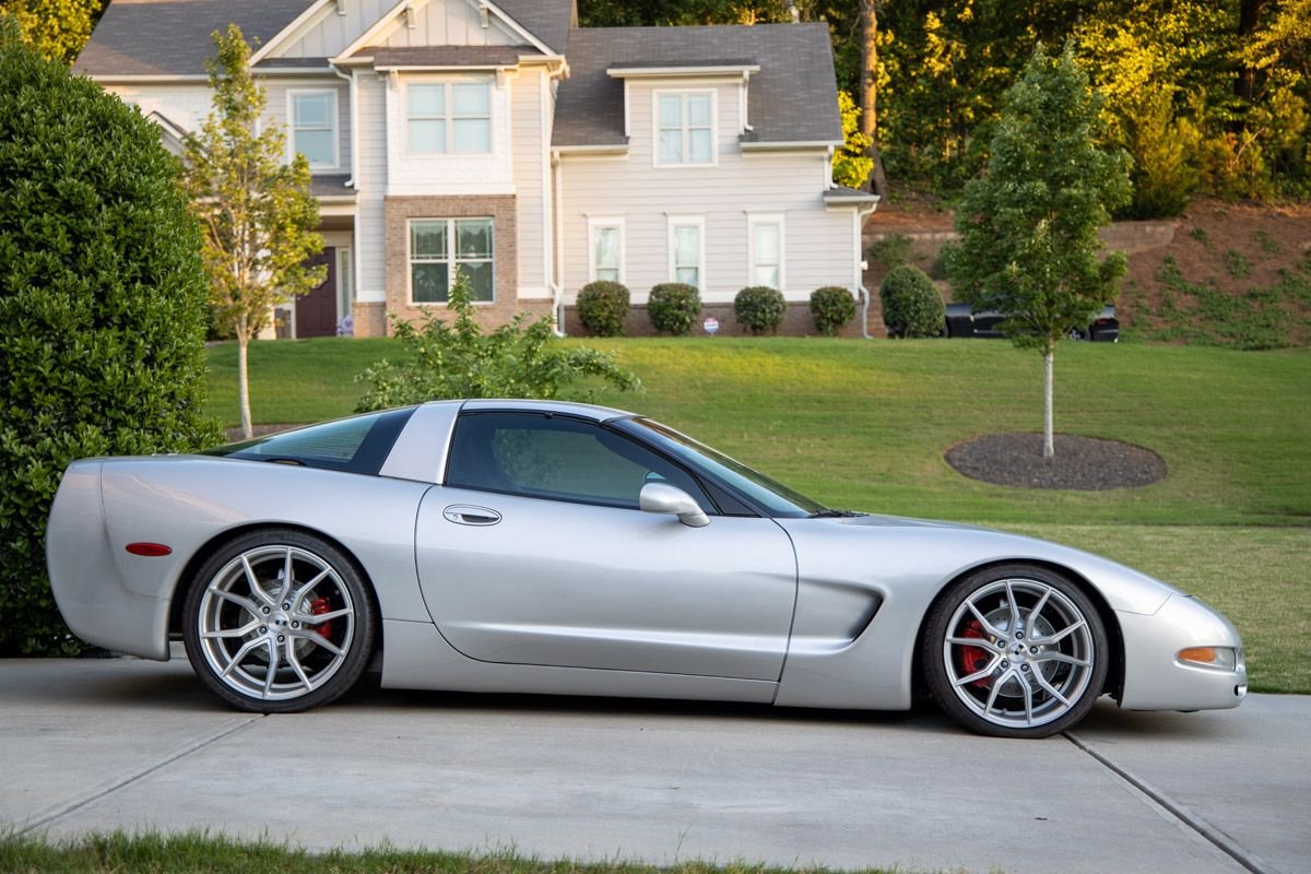

For those of you that haven't seen my C5 Corvette Build, here it is:
https://www.corvetteforum.com/forums...5-project.html
And this is my C5 now:
2003 Corvette

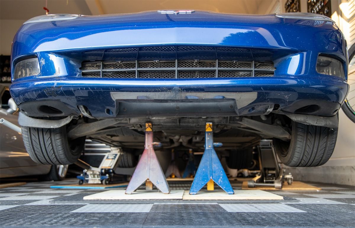

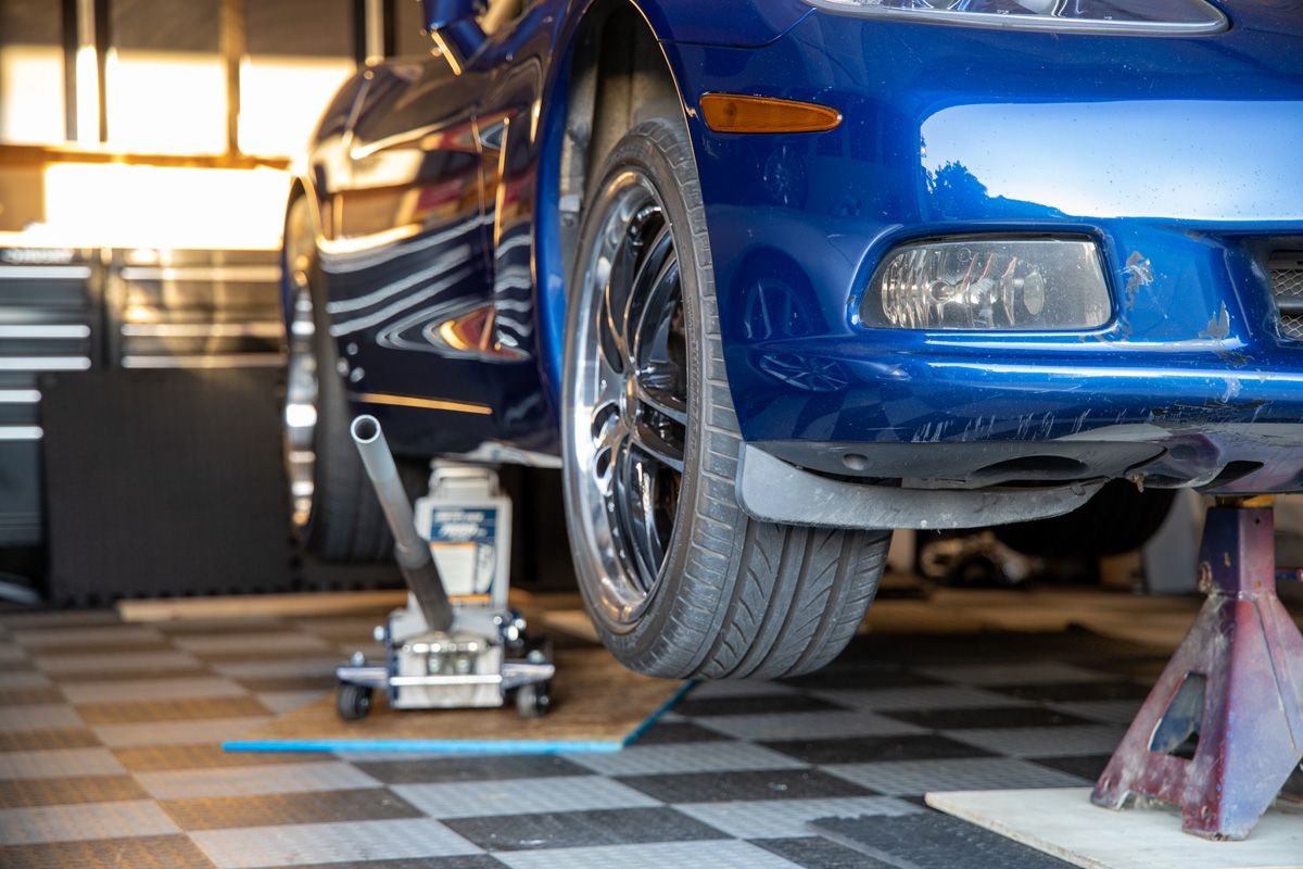

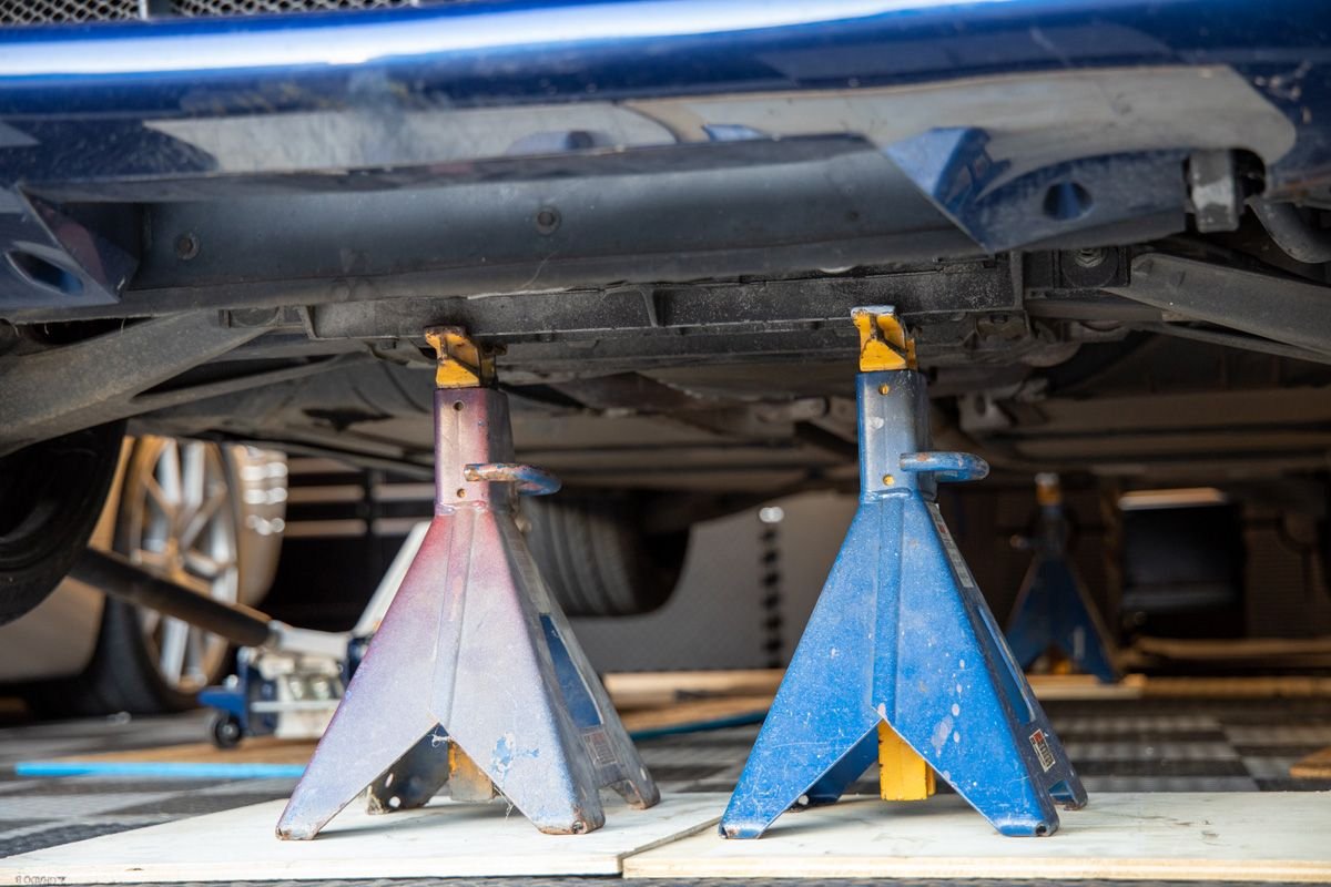

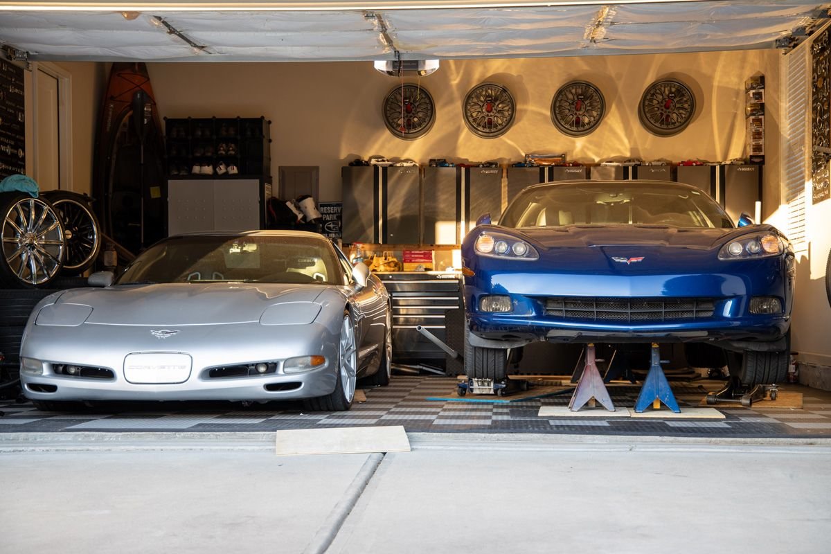

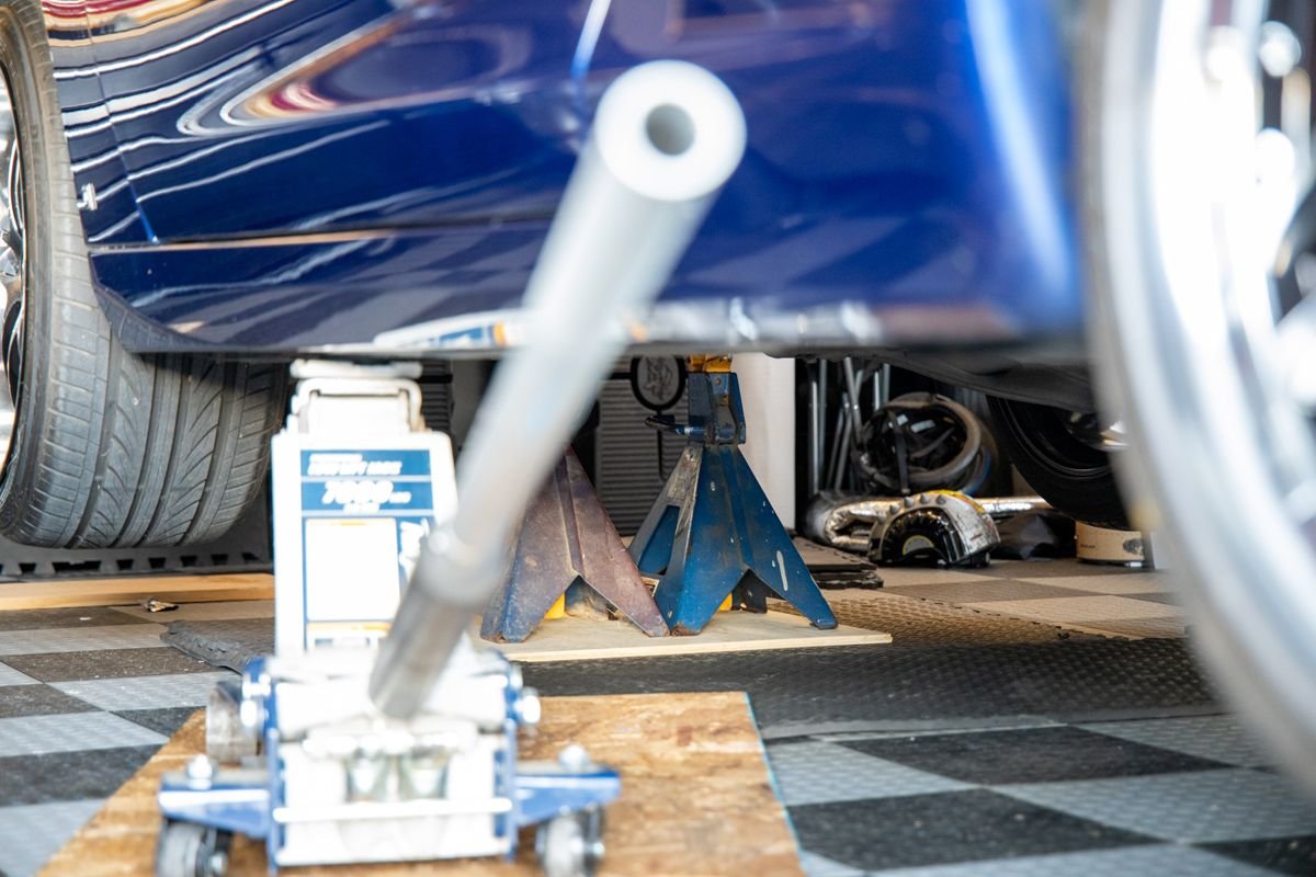

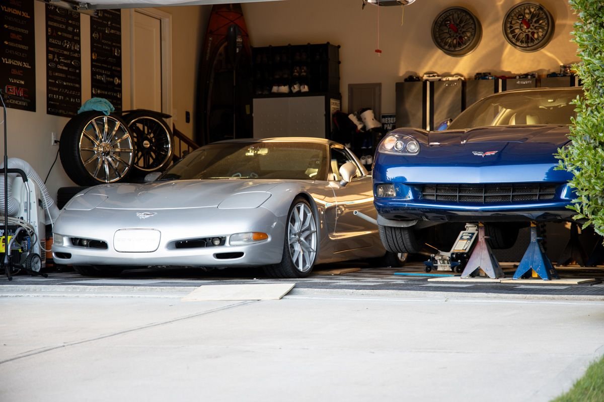

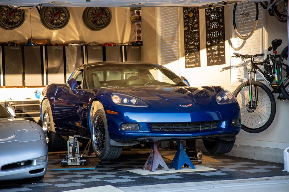

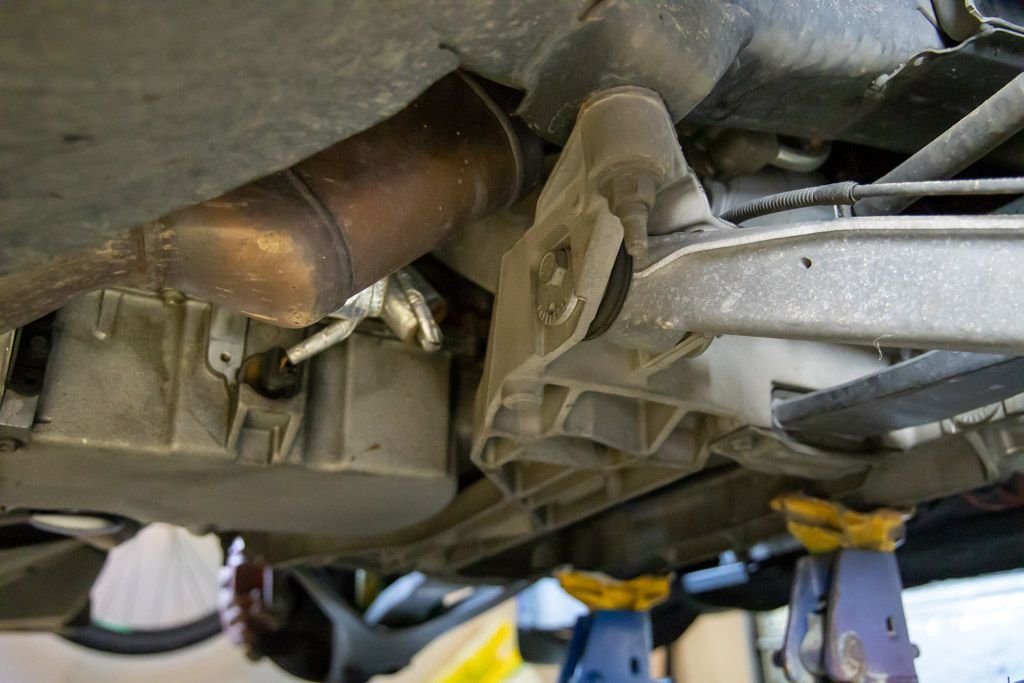

Having a lowered Corvette can be painful every-so-often. Just swapping the car position inside the garage is a process with two lowered Corvettes. The C5 is so low that I had to place boards just to be able to clear the left side of the garage. Once the C6 was in, I used one floor jack to raise the car from the back and slid the ramps underneath the rear tires; I repeated the process in the front. Then I raised the vehicle again and placed the jack-stands underneath the rear and front crossmembers. It's a balancing act but I did the C5 the exact same way. It sat like that for months without any issues. I do like to leave the floor jacks on both sides just to balance the car even more.

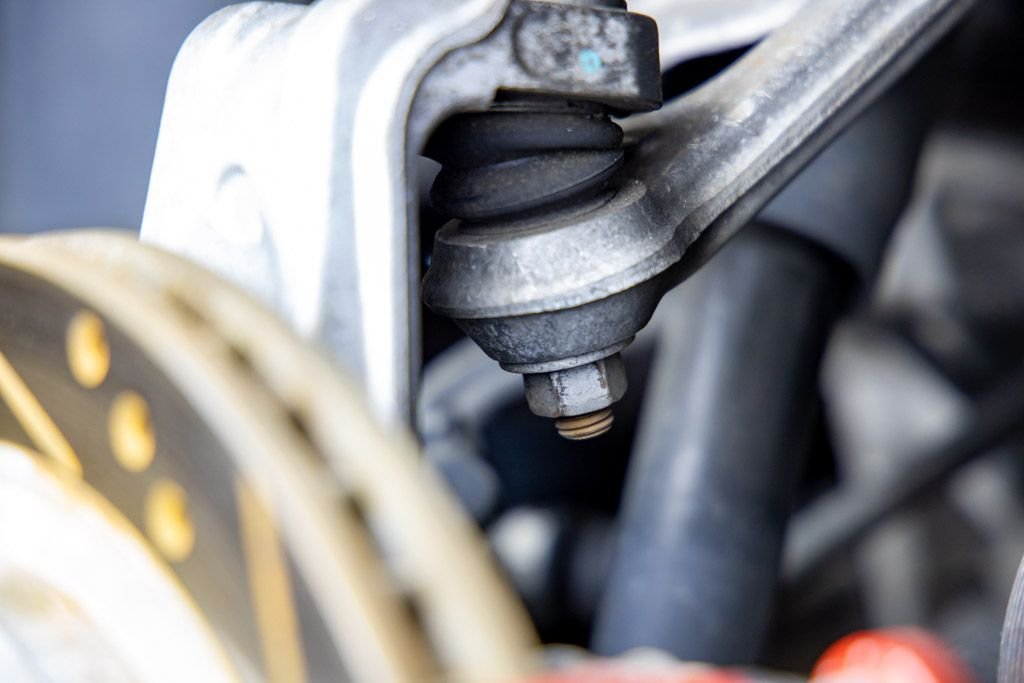

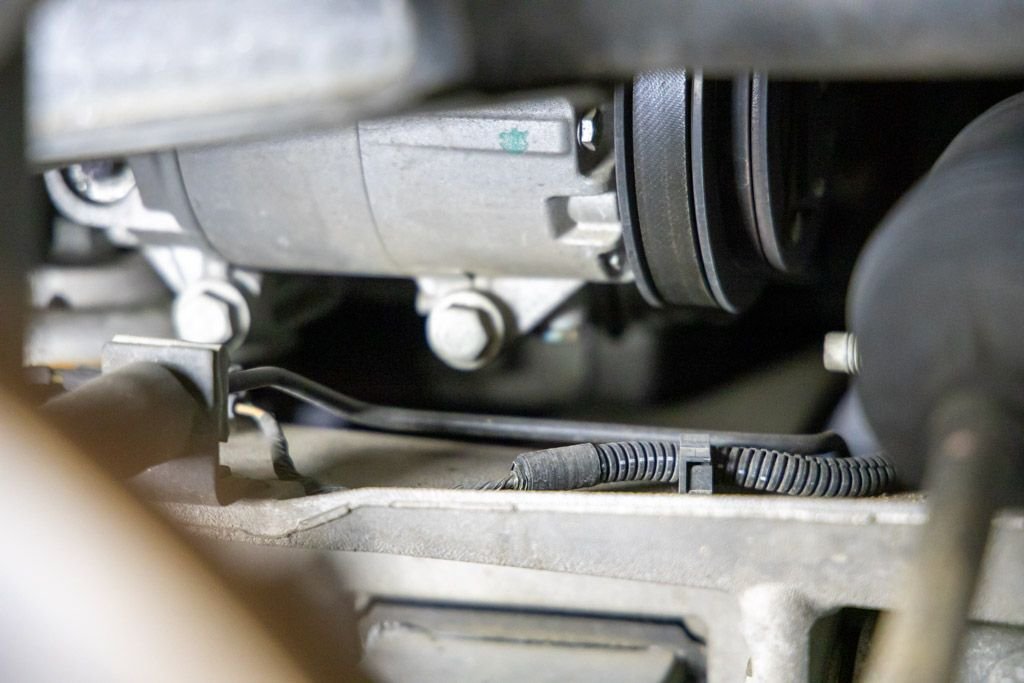

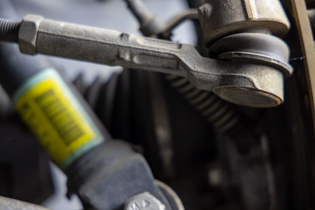

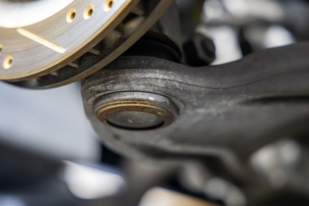

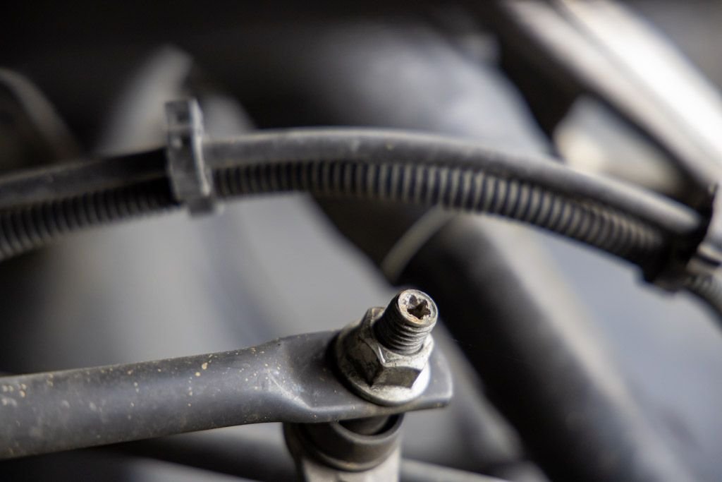

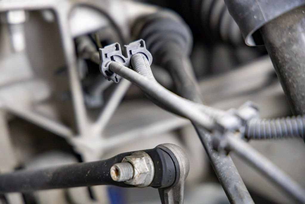

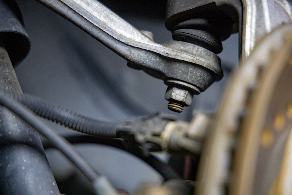

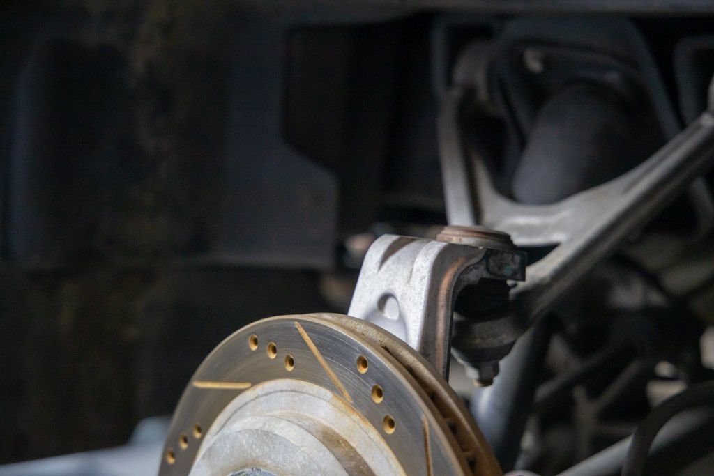

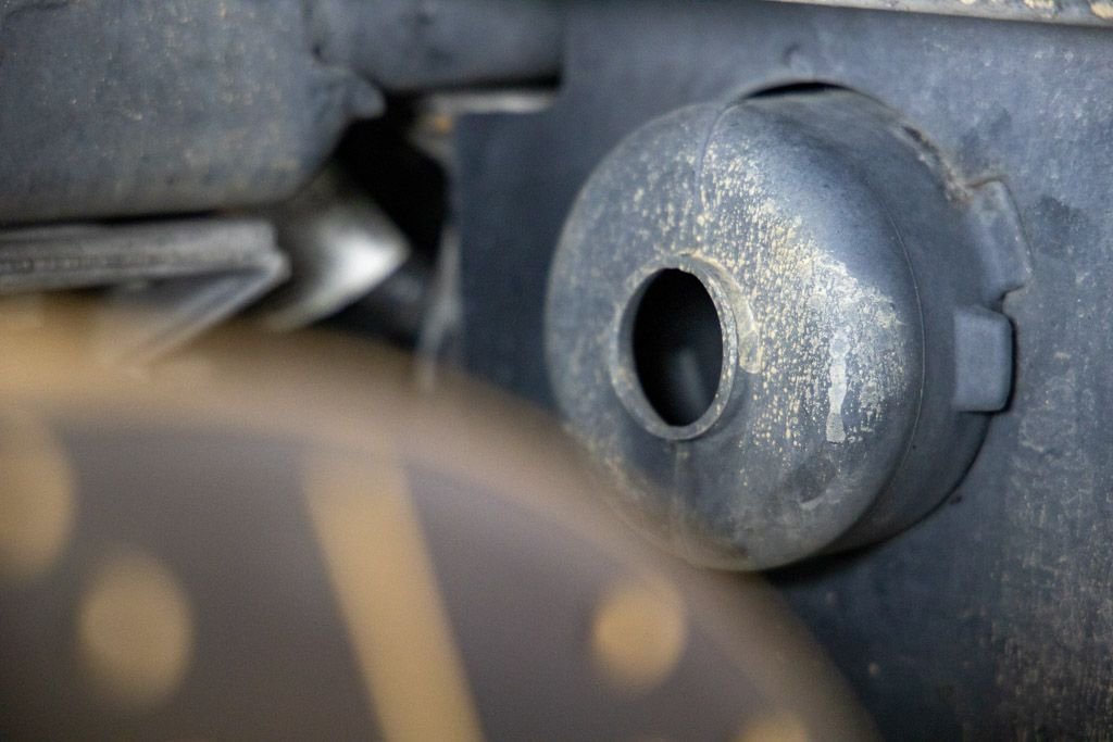

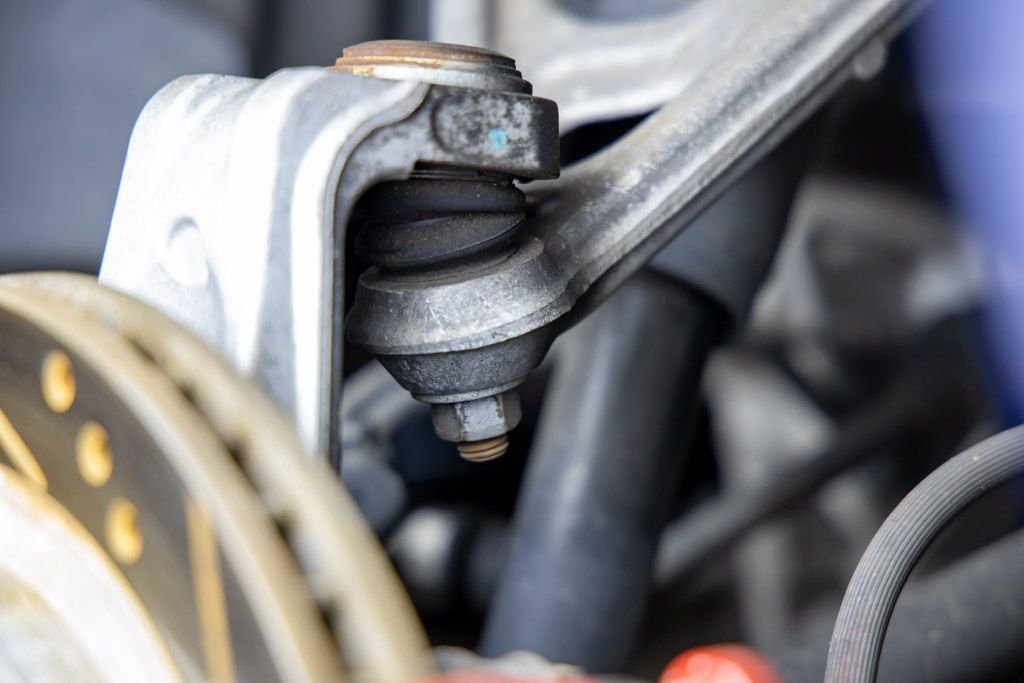

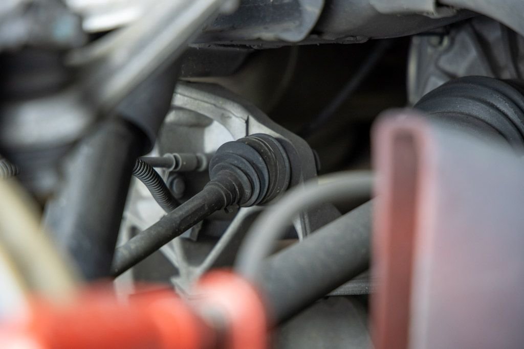

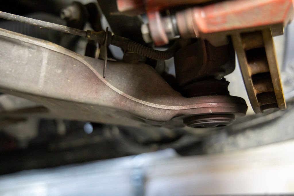

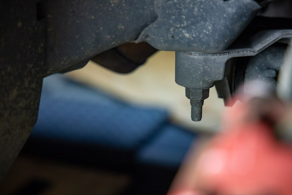

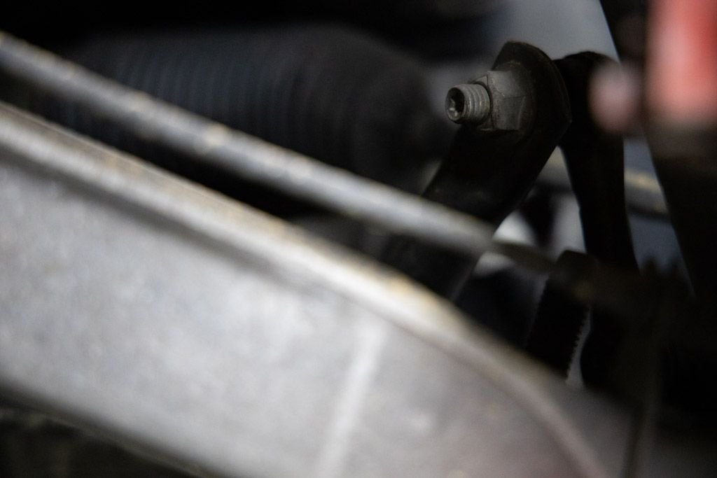

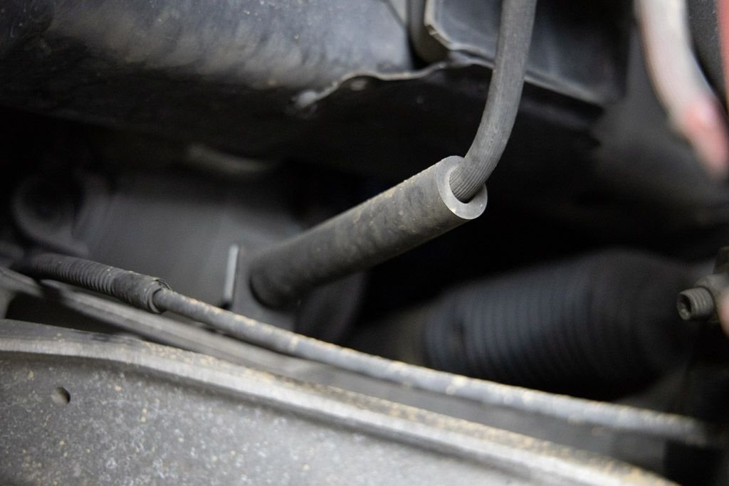

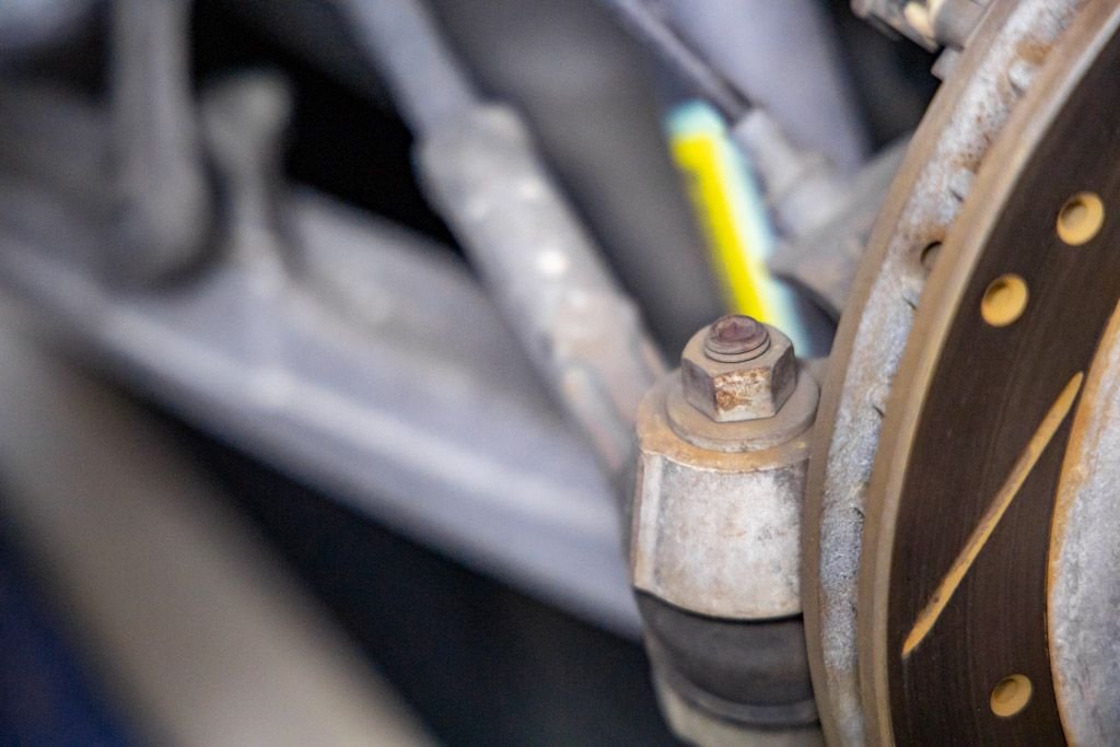

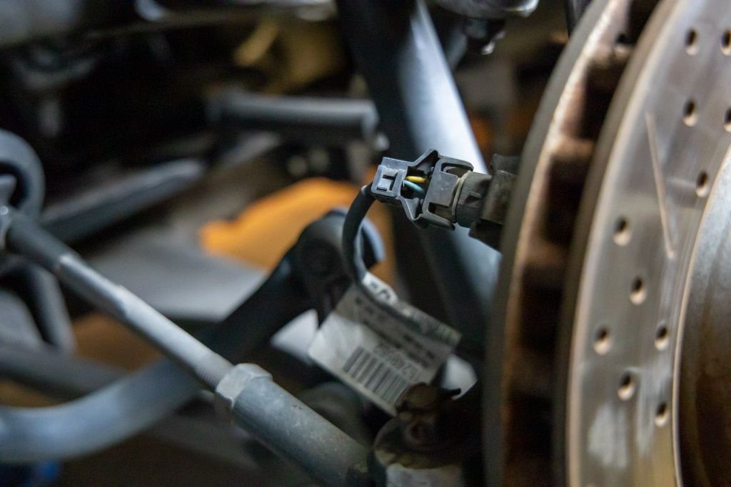

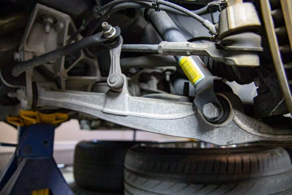

I feel like I did the same thing with my C5 Corvette build. I got all hyped up and then nothing. It feels like I just enjoy having a project car inside the garage. My son is the one that motivated me to start again. He took his camera and said "it's time to go work on the Corvette. I want to take some pictures."

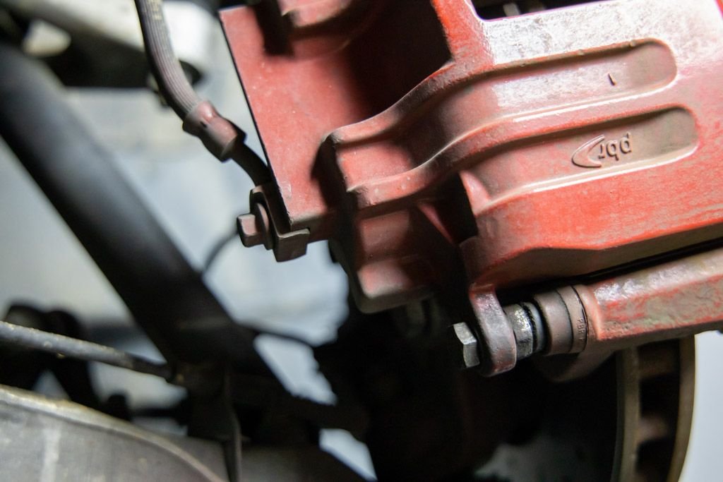

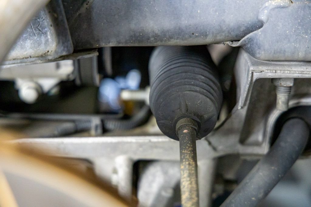

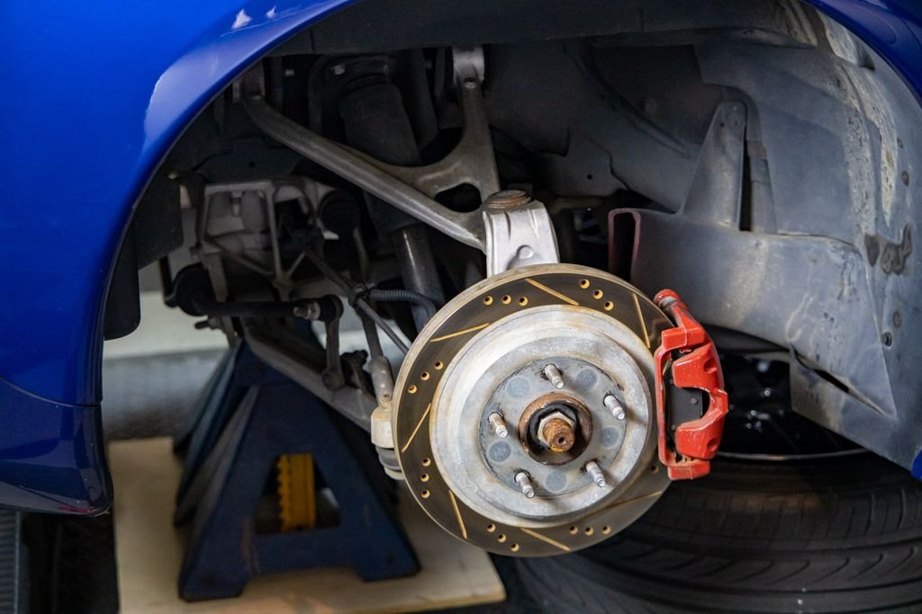

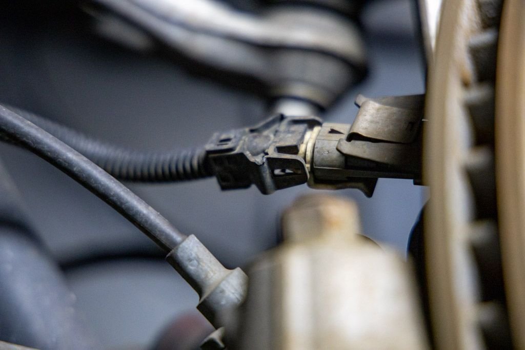

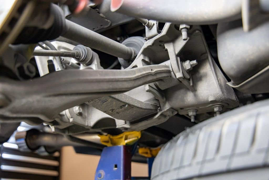

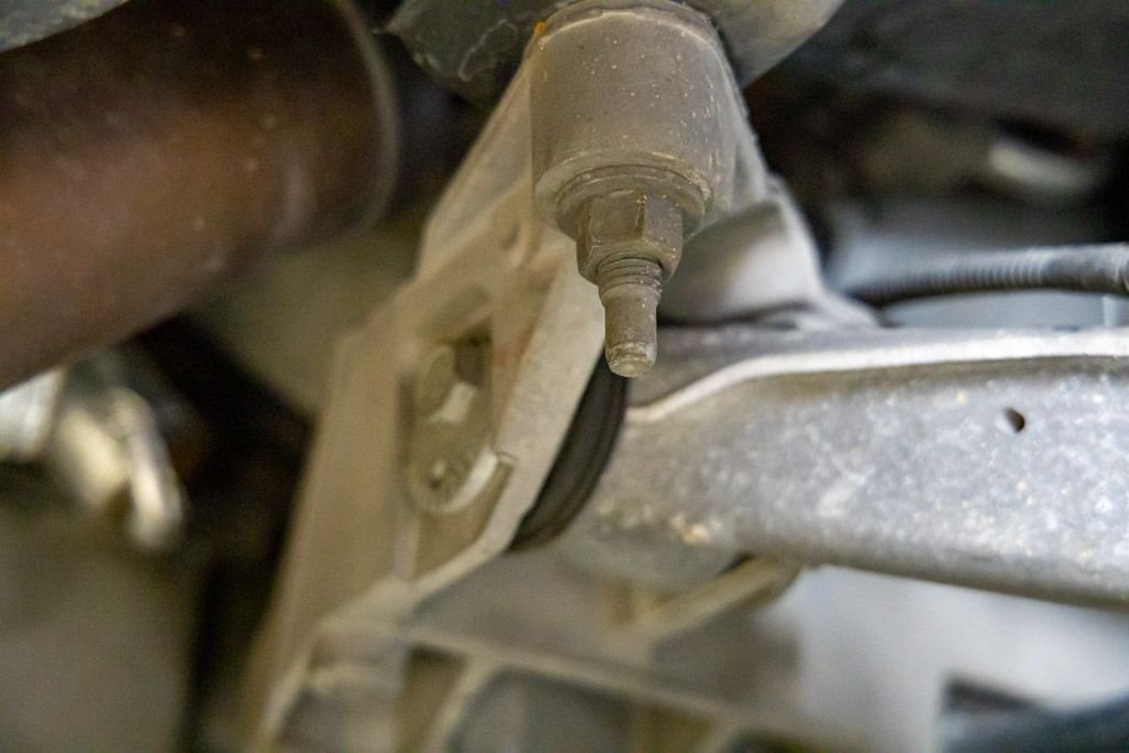

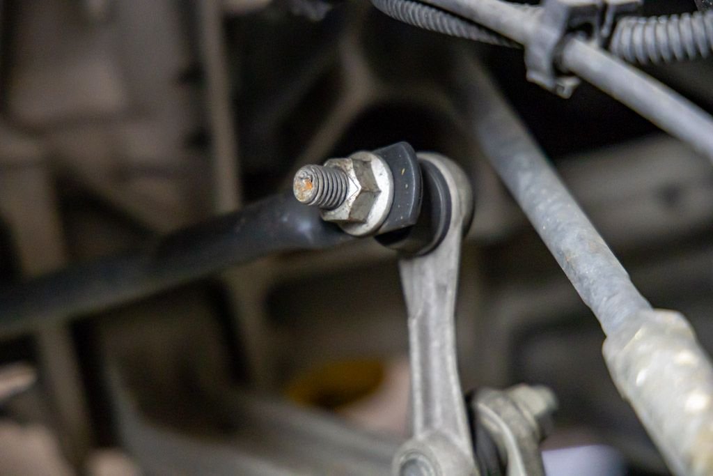

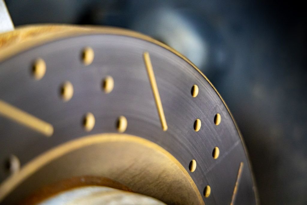

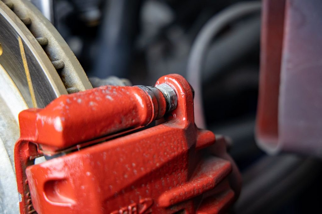

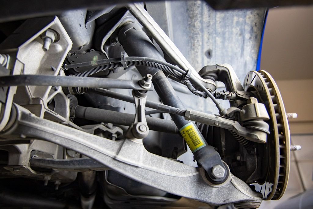

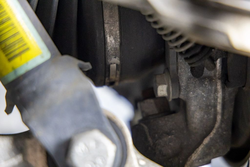

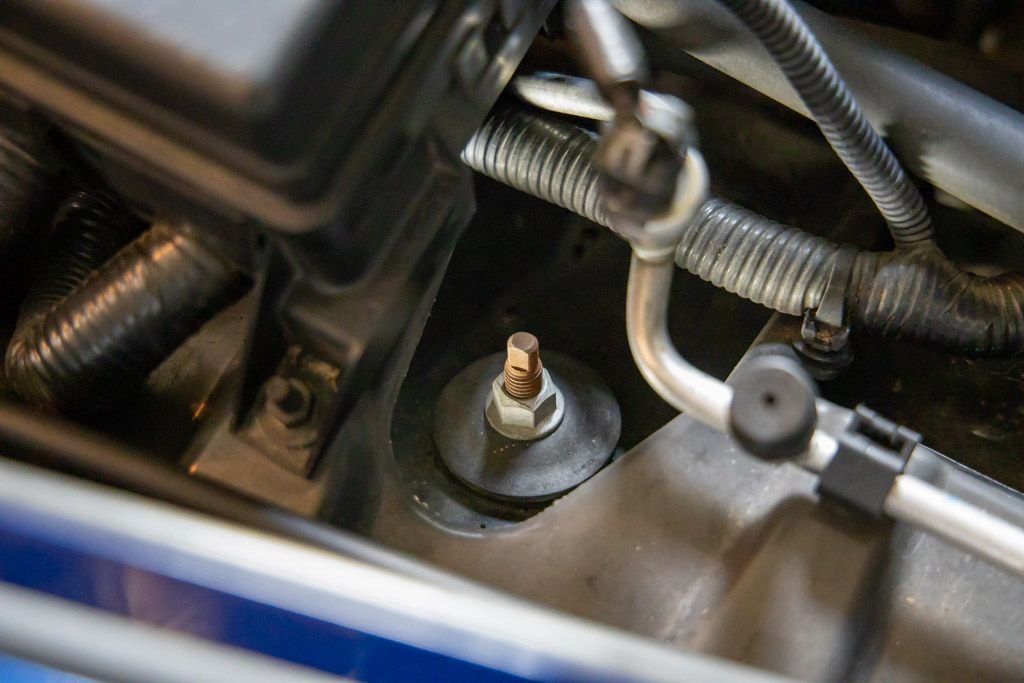

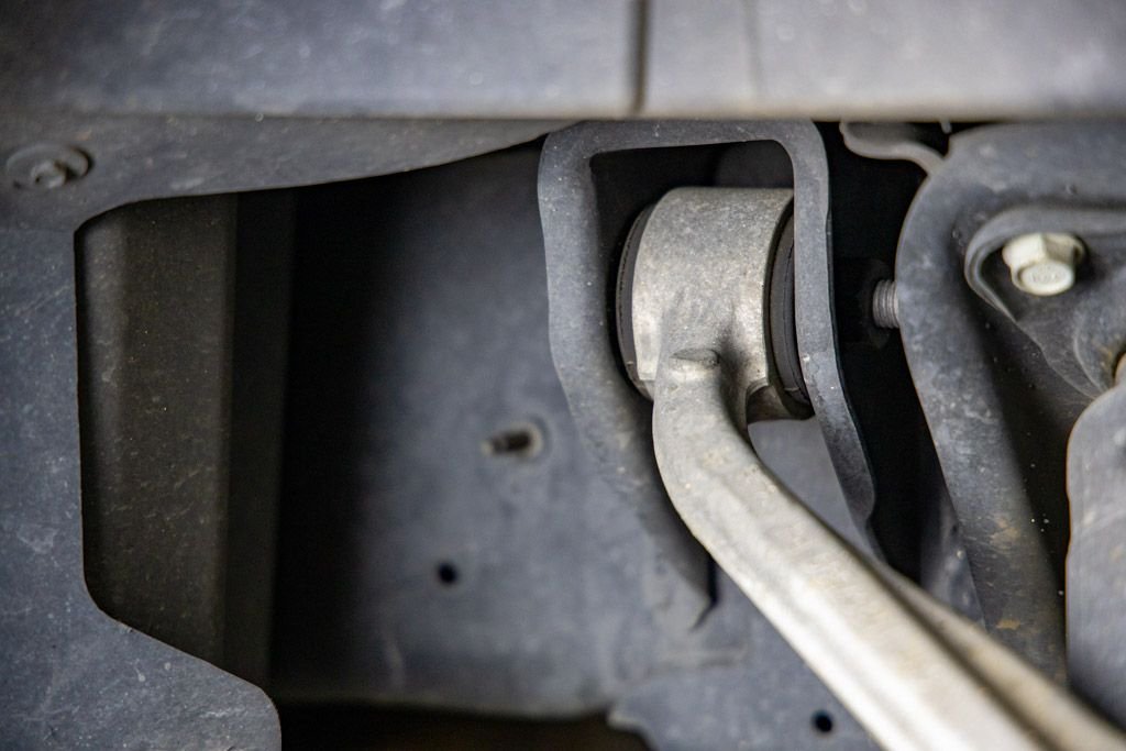

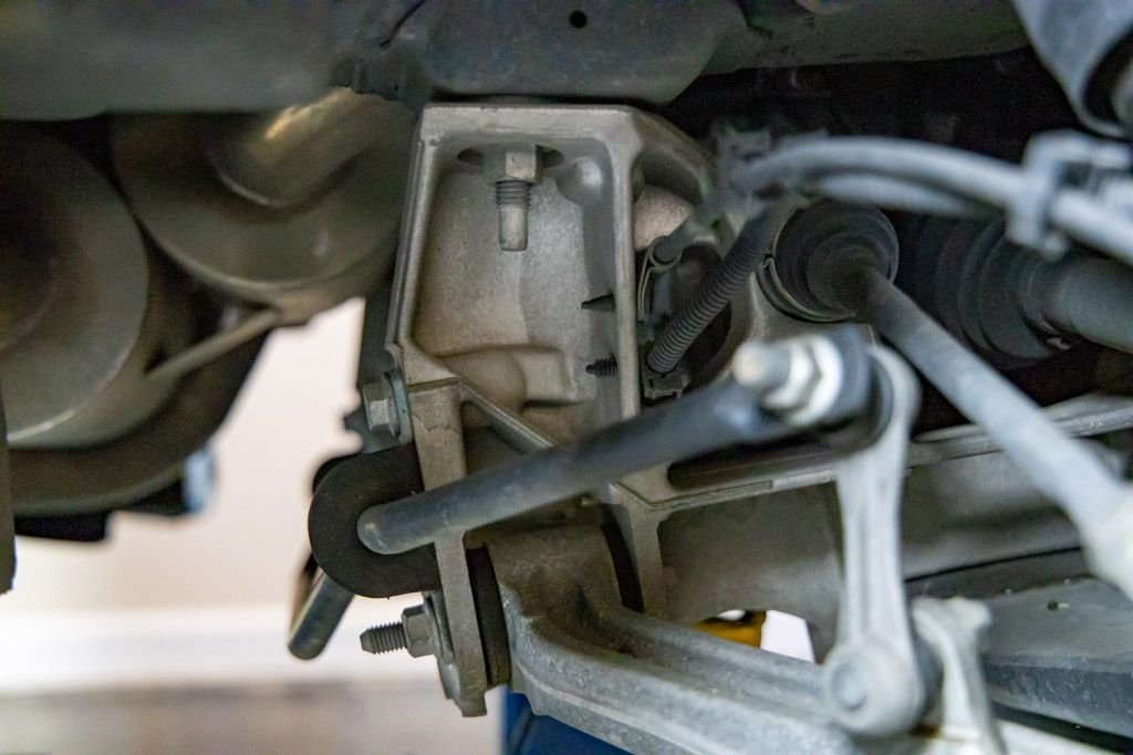

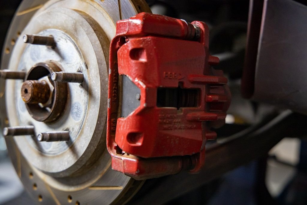

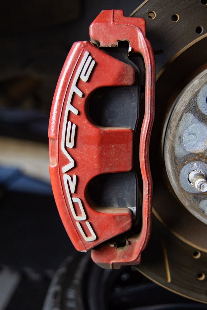

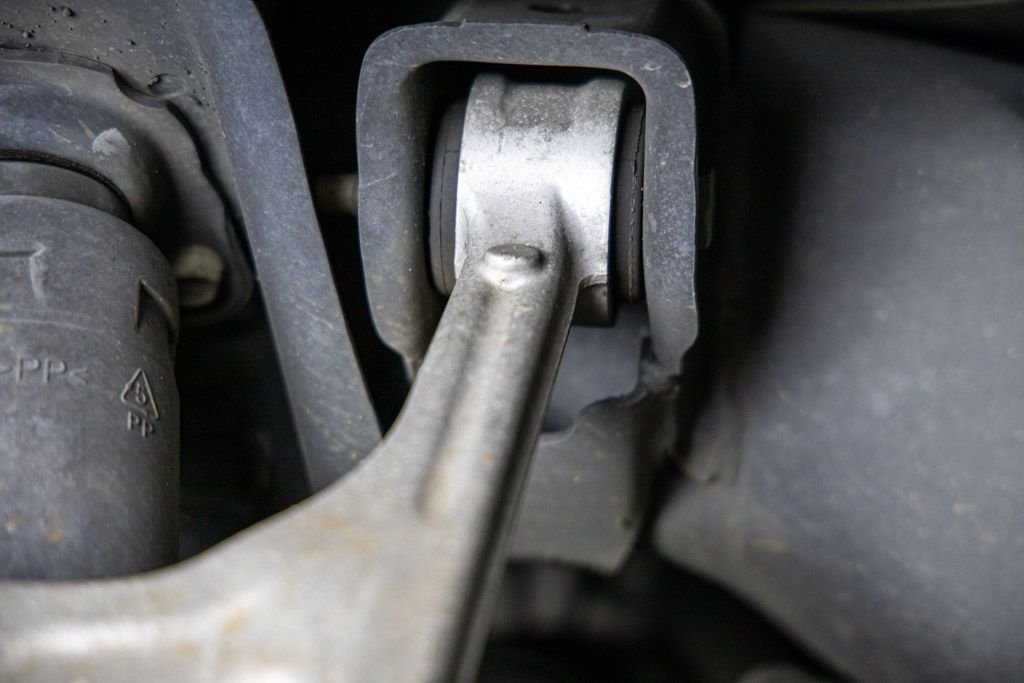

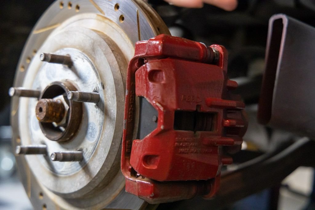

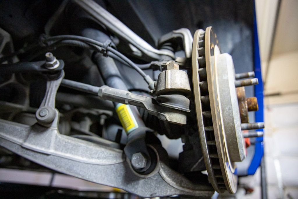

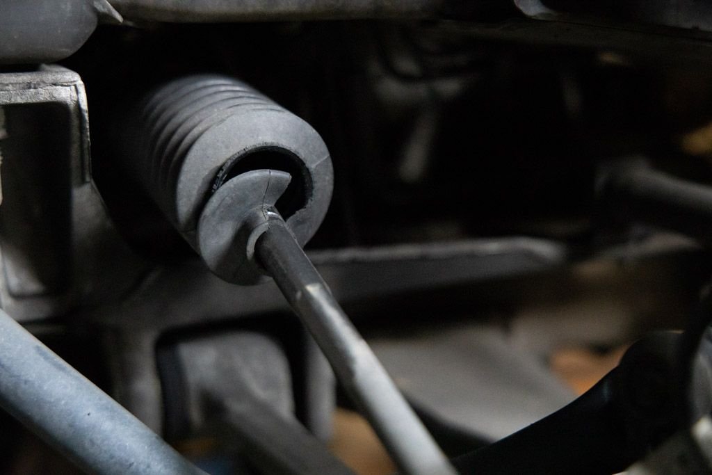

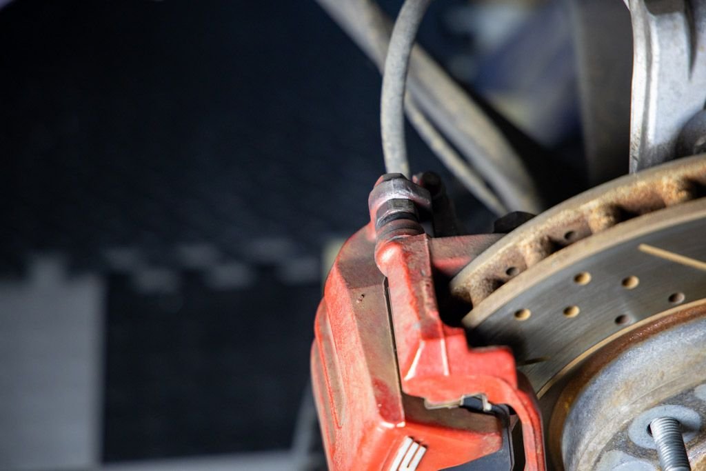

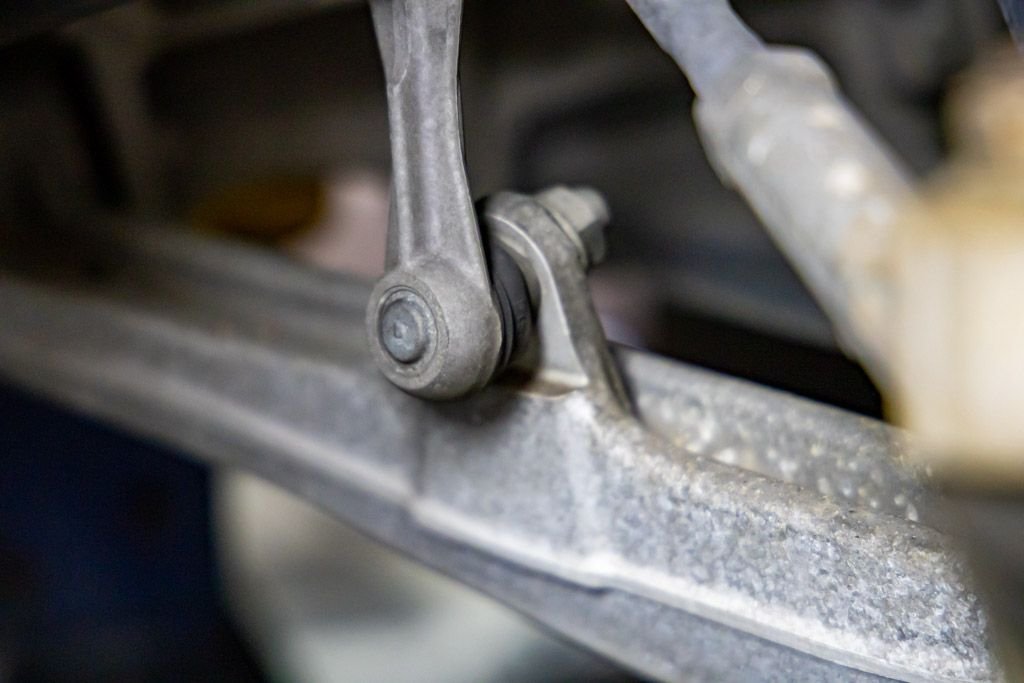

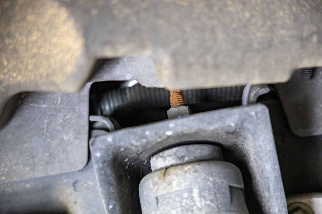

I recorded some footage of what the suspension components look like for anyone that needs a reference and I took a bunch of photos. I'll try to stitch the video later today and upload it tomorrow. As for the photos, here they are. These are photos of the front passenger suspension components.

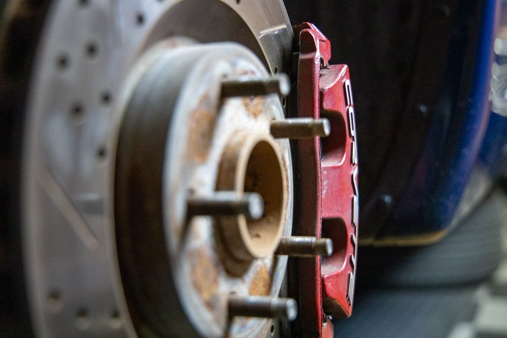

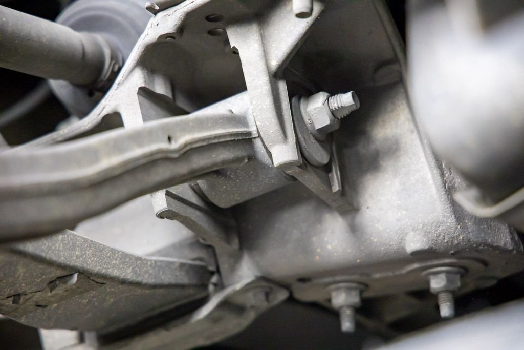

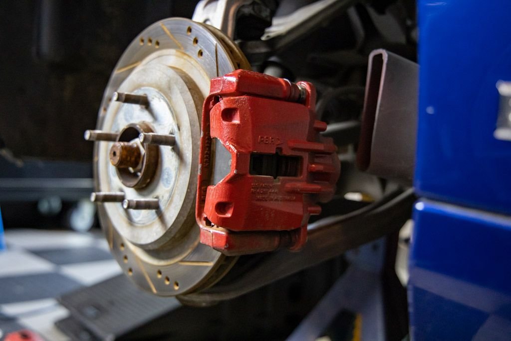

Posts: 175
Likes: 28

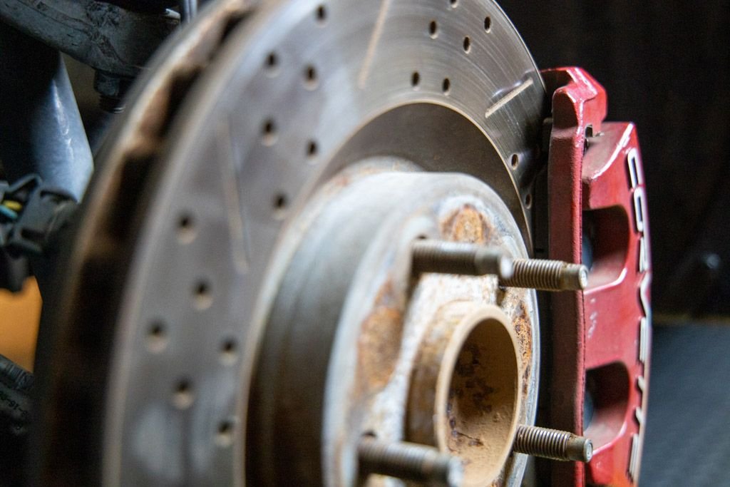

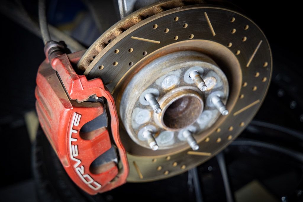

From: Atlanta, GA

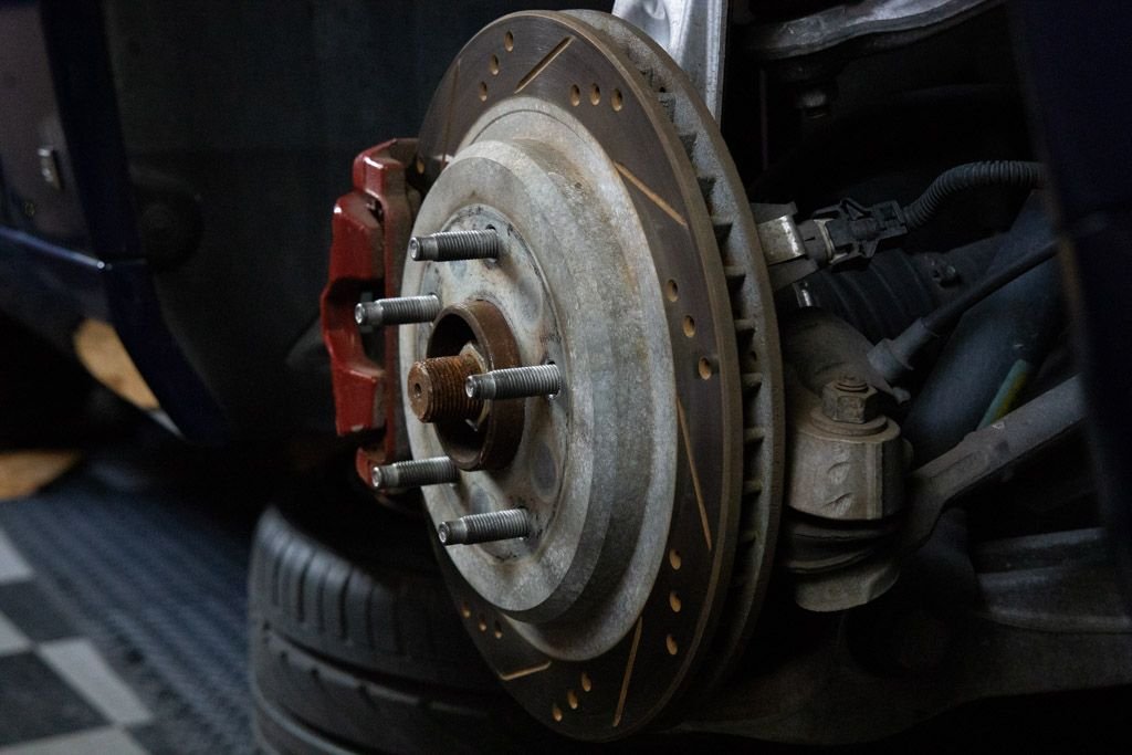

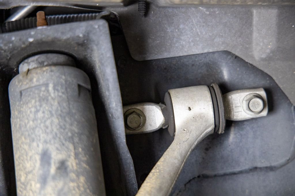

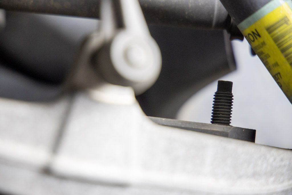

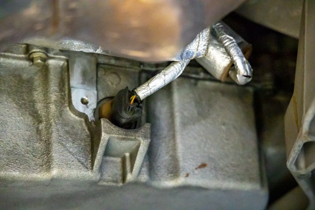

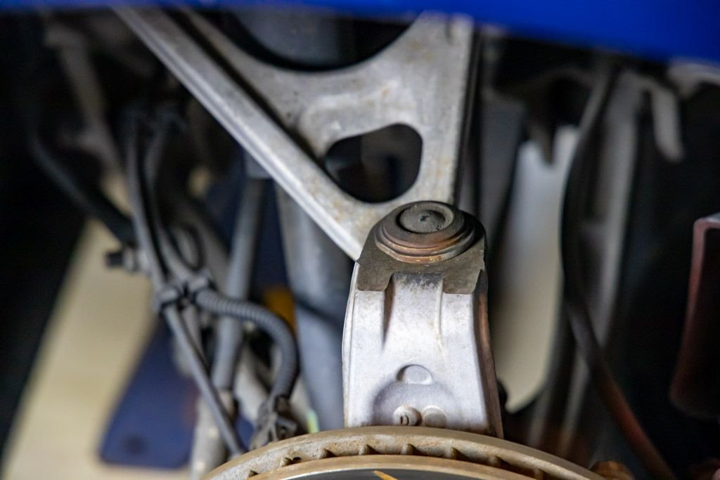

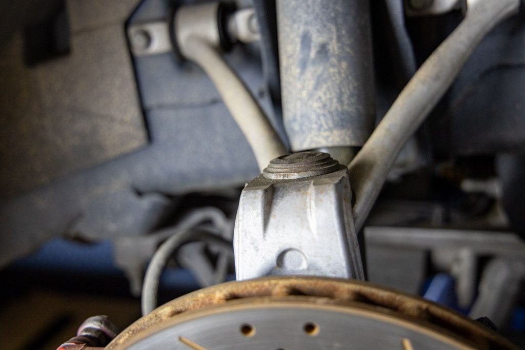

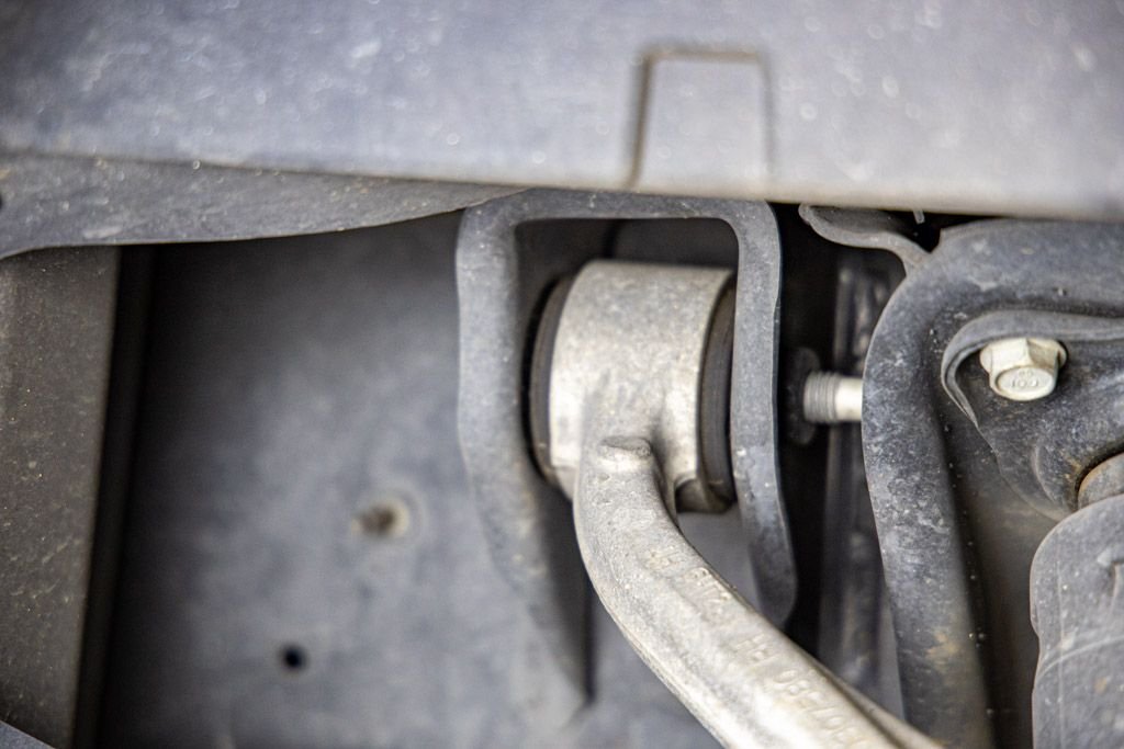

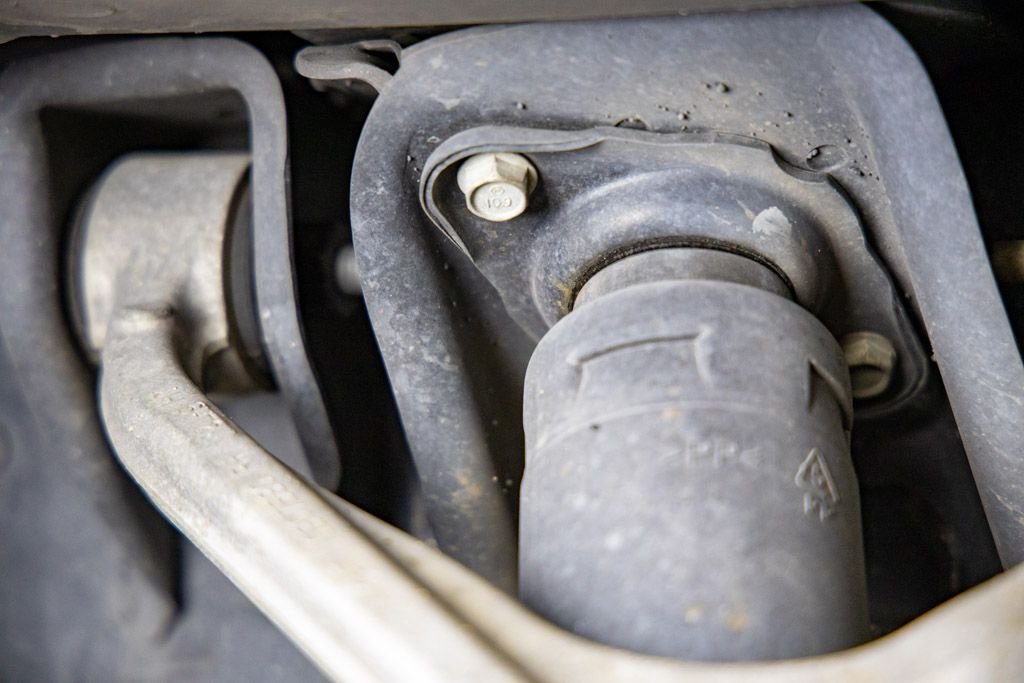

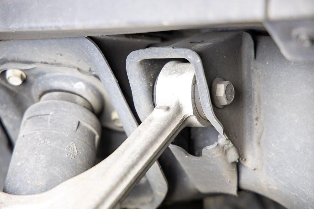

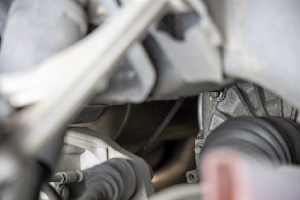

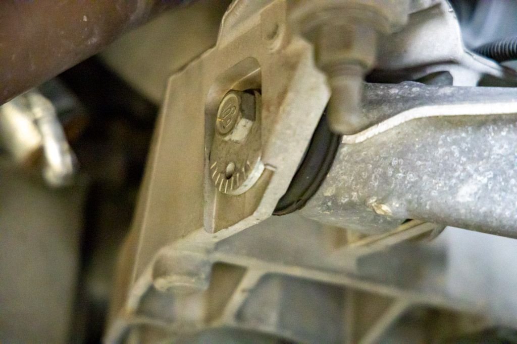

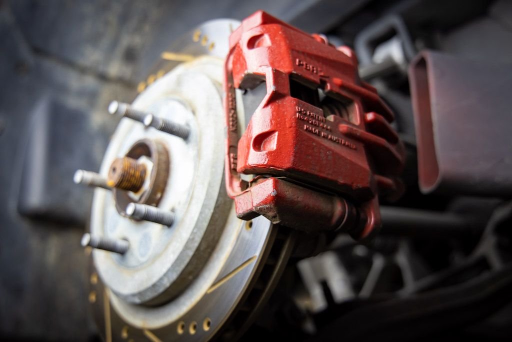

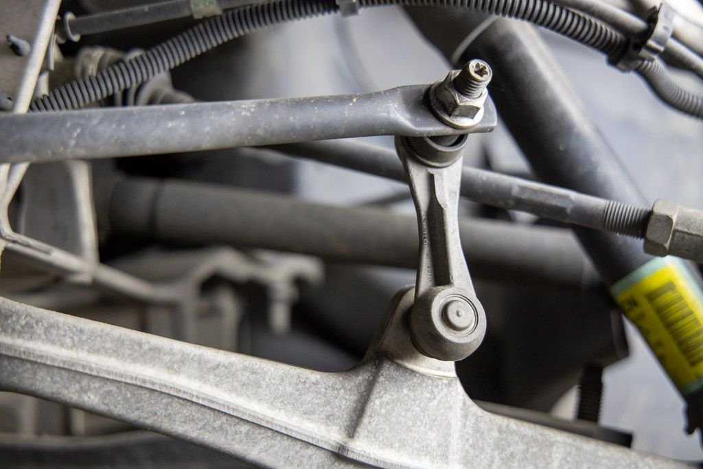

Here are the photos of the rear passenger suspension components. If you see anything troubling throughout this build, let me know. Also, if you need photos of anything, let me know and I will go and snap some for you. I think I got majority of the components so far.

Here's some footage of the suspension. From what I can see, the only part that may need to be replaced is the front driver-side CV axle because of the torn boot. What do you guys think?

I just diagnosed my own popping/clicking issue. The axle needs to be replaced. I don’t know why that slipped my mind when I was recording the video.
