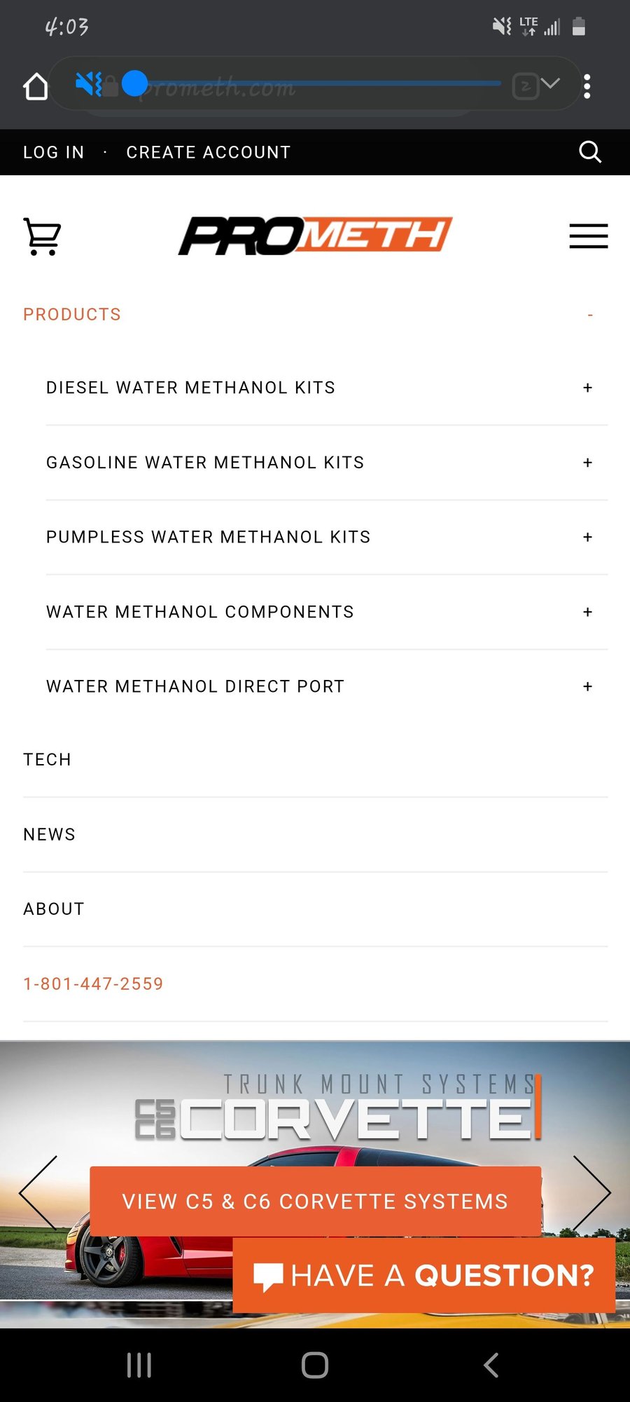

Originally Posted by Vette920
What is a good brand to get besides alky an snow.?
AIS (alcohol injection systems) also known as ProMeth. They have a real fuel cell that is designed to fit our passenger side cubby and use real stainless fuel lines unlike some others that use window washer reservoir for a fuel cell along with plastic fuel lines
