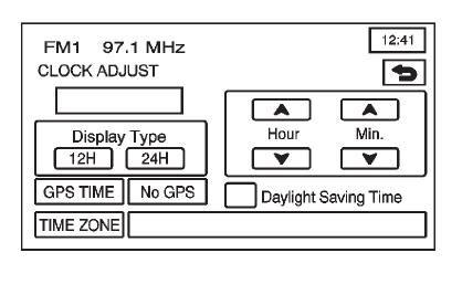

Originally Posted by FatsWaller
Also, make sure the time zone is set and saved.
Like this:
Pressing the clock will display today’s date. Holding the clock button will
take you to a shortcut for setting the clock and adjusting the time zone.

AFAIK, there is no other firmware fix. I've attached a NAV manual for a 2011, and a 2006 (I don't have one for your 2008, but they should all work the same way) for you to look at, but nowhere in there is an indication of how to manually set the date, only the time. One thing for sure: the NAV system needs to be able to 'see' the GPS satellite array in order for the date and time to be updated, so make sure that this is the case.
Finally, to force an update of time (and presumably date) from the GPS signal, press and hold the clock display to bring up the clock adjust screen. Then, press GPS TIME to update the NAV system's time to the current GPS time. Make sure that the time zones and DST fields also reflect where you are.
