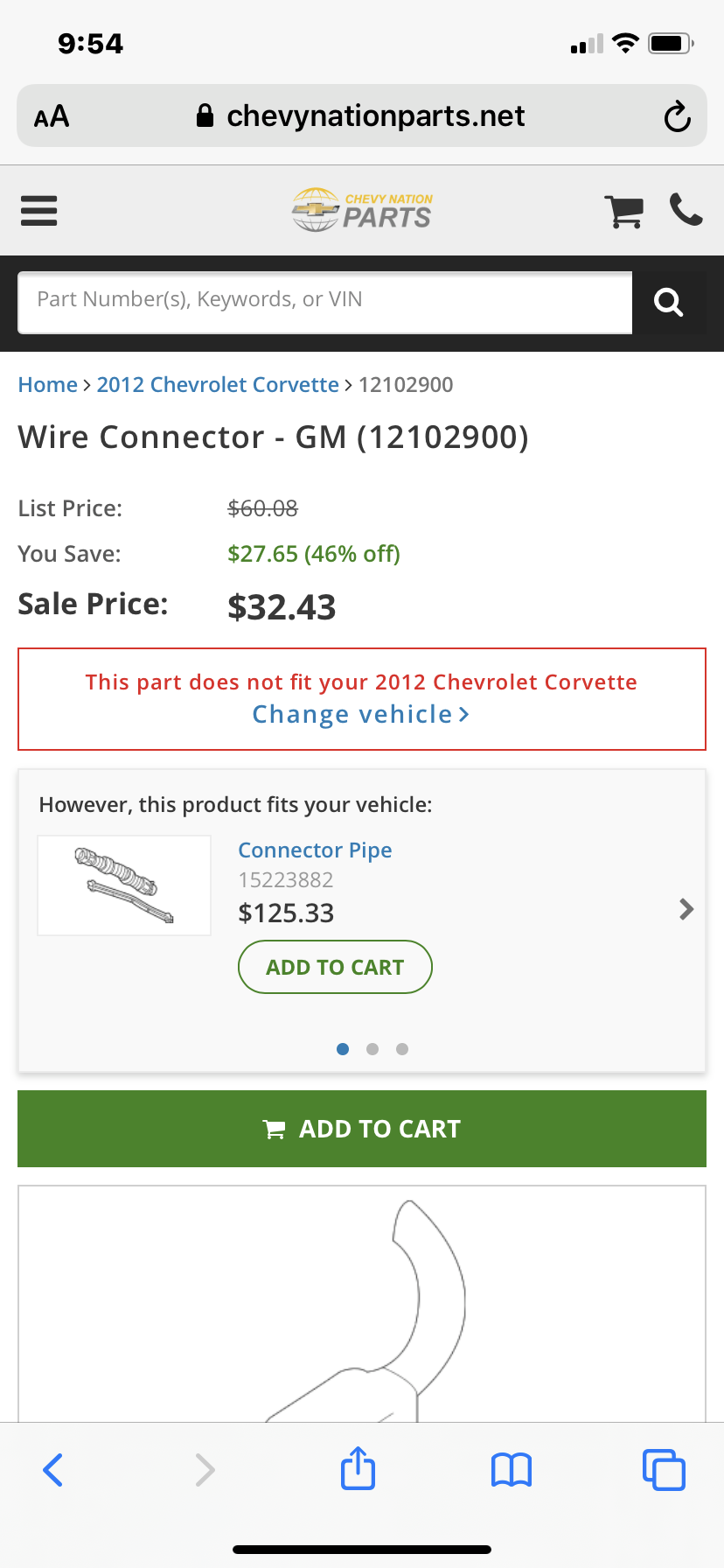

Here’s the part # that Dano suggested although this says it does not fit a 2012. I’ve purchased many OEM parts from this dealership and their parts dept guys have always been really helpful. *1 (800) 650-6261‬
Jab, this is getting a bit dicey. I can get no line on the 2012/13 version. The one you/Dano posted is the 2008/11 version. GM also changed the button in 2012, though it was the same size. I am now wondering, IF I am unable to get the 2012 version, what if I bought the 2008/11 version, with same year button, and used that? The difference appears to be that the newer button had the word "off" printed on it, in addition to the vehicle drawing.
Is anyone out there aware of any difference in the operation of the 2011 vs. 2012 traction control? If I can't get the correct button and link for a '12, would I be able to use the '11?
