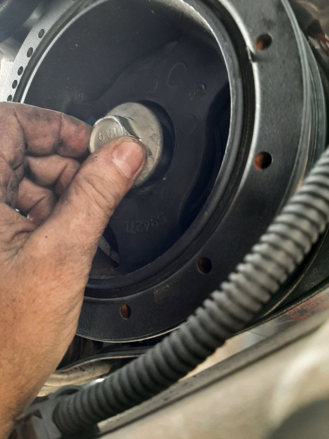

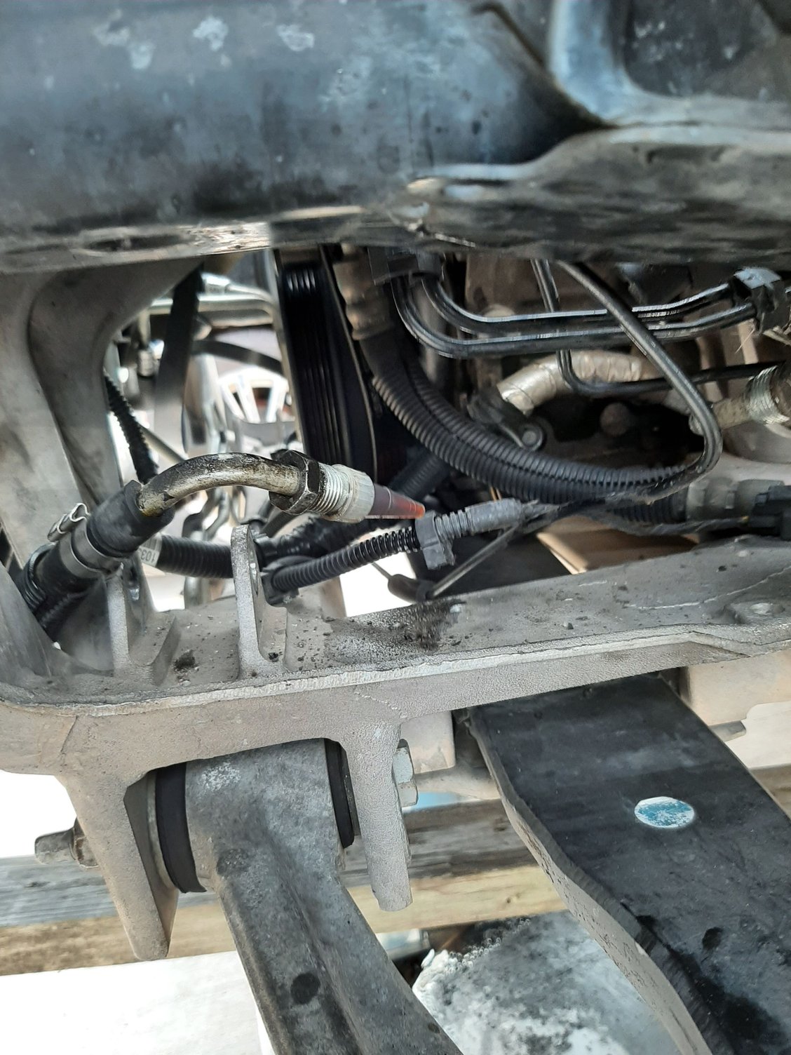

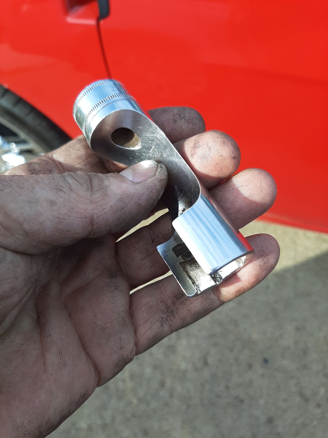

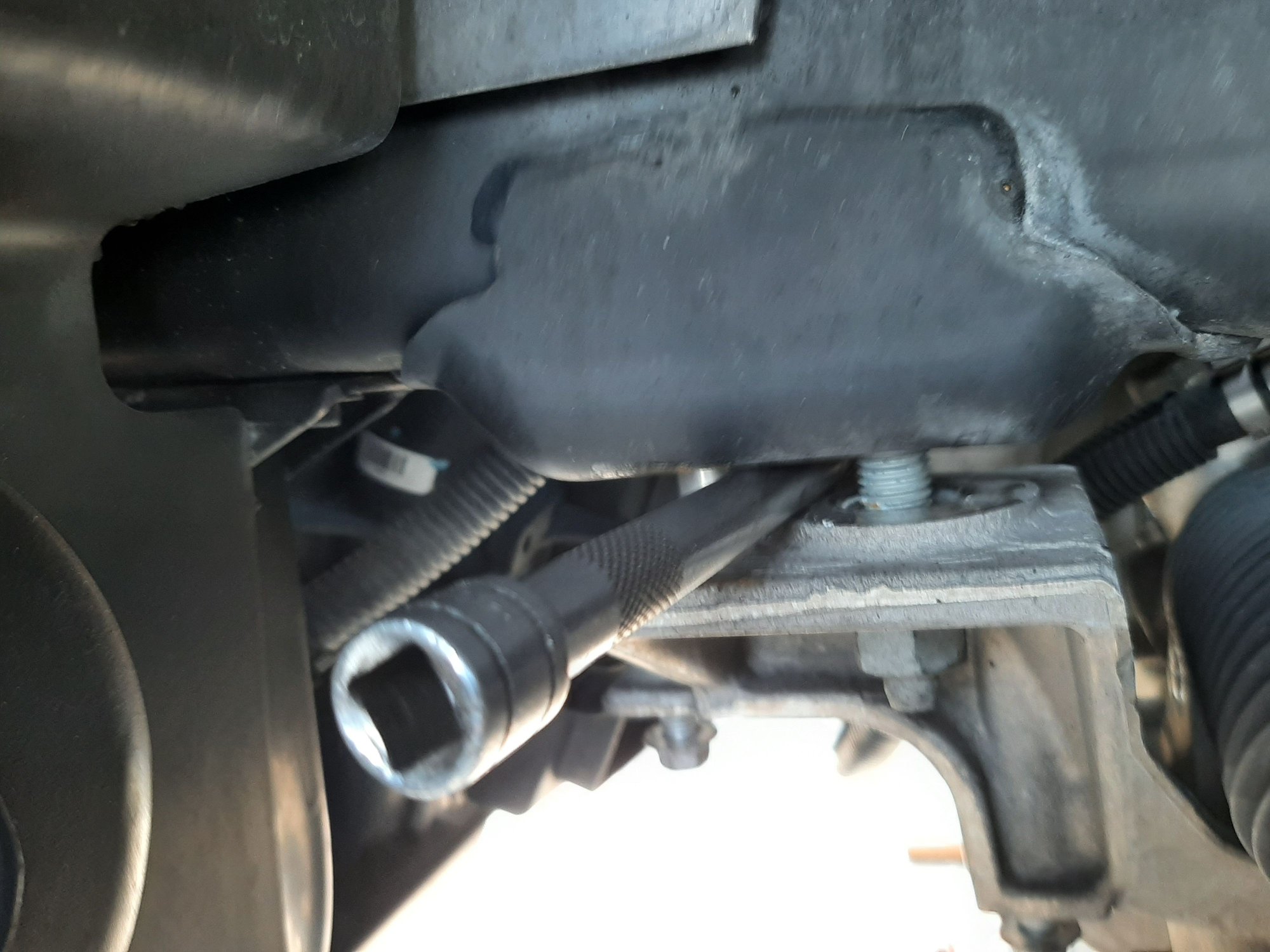

Its a Auto.... Got the car jacked up and rack out of car in 2 1/2 hours... Not bad since i never did one in a C6 and im working on my back...When i got both lines unhooked at rack, i noticed that there was 1 line that had O ring on the end, but the other line did not... Did i drop it ?? or is there not suppose to be one on the other line, like it may be a return line.. Here is a few pics.
Worked Great to reach down with extension to get to lines..
Bolt finger loose , but balancer still on all the way
wedge to hold frame down
