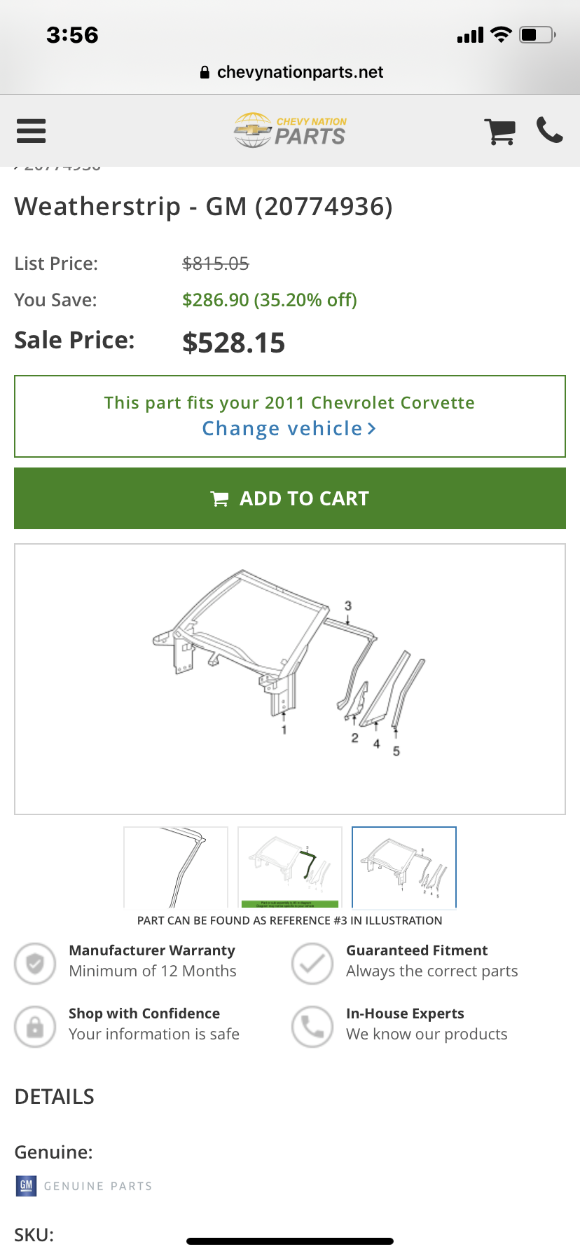

Just got a quote back from a local glass repair company.
$1500 for glass
$1000 weatherstripping he said needs to be replaced due to being 12 years old
First off gm glass is $768 straight from gm. My question is about the weatherstrip mounding. Does it need to replaced when doing a windshield and if so does anyone have the part number? Thanks

Interestingly, according to this there is barely a different between HUD & non-HUD?
Now I will say the cost of glass has gone up substantially this year, whether legitimately or not. We had to replace the windshield in our ‘16 Outlander for the 2nd time & using the same guy, the cost was double. He showed me his invoice for the windshield and his cost had doubled.
I also found an 8” crack in the outer pane of a small bathroom window upstairs due to hail & called 4 different window/glass companies who all gave me a ridiculous price to replace the single pane of class - about $400 for a 21x18” pane of glass. We had had much larger (3x) full windows replaced previously for only $159. Each company just said “prices are up due to covid”.
Weatherstripping
