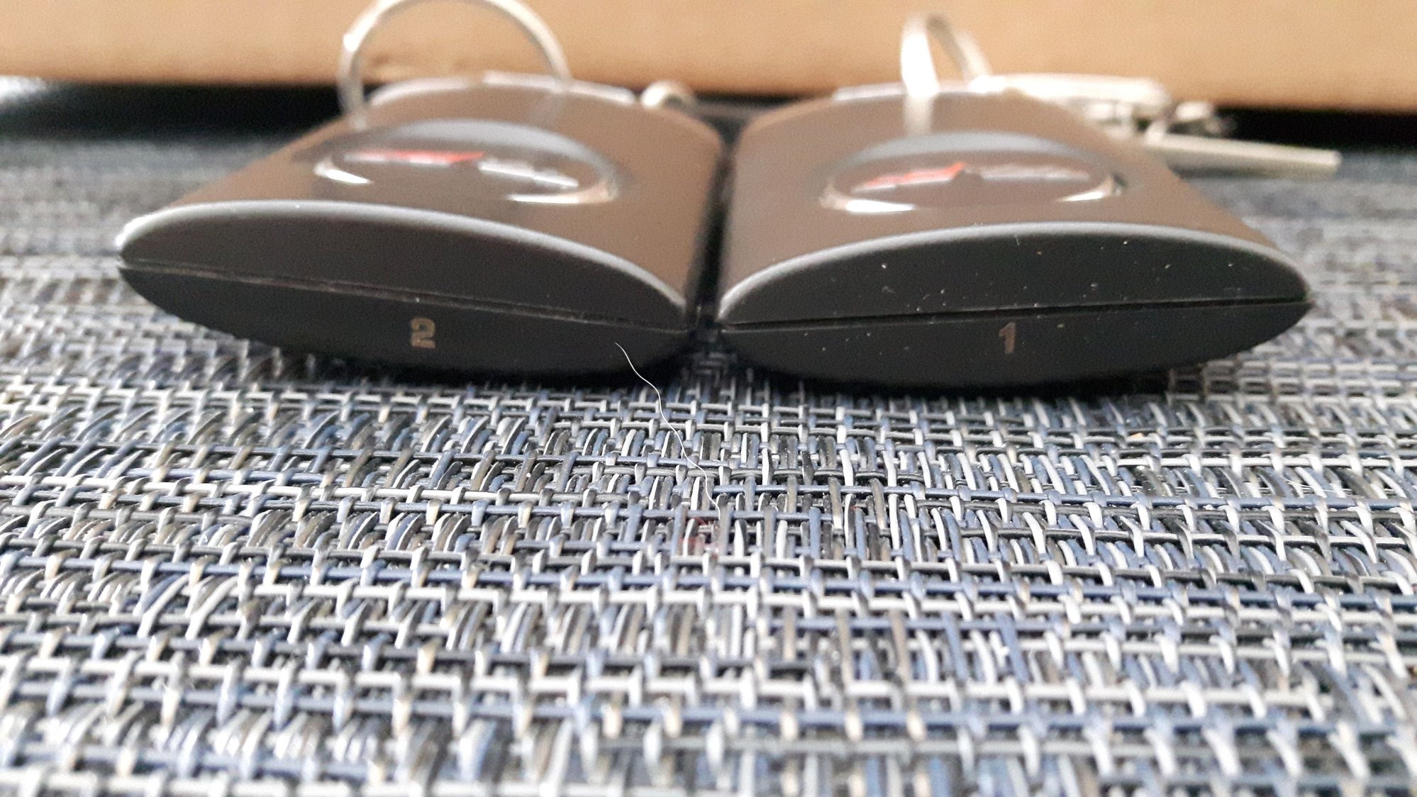

Looked under a microscope and only numbers are FCC and Part #

Well, there's a joke here about what's printed on the bottom Coke bottles - "Open other end", so I guess it applies here. You need to look at the other end of the fob. The FCC stuff is on the top of the fob case. The fob number is printed (labelled) on the bottom of the fob case. I can feel the label if I run my fingernail over it lightly. Yours should be there. I suppose with enough wear and tear, the label could be scratched off. Here are the bottoms of my '11 fobs.
The #2 fob was delivered with the car. The #1 fob was purchased from a vendor on eBay, and I added it in to the 2 existing fobs using the short procedure so that it is now recognized as fob #3, but as I've pointed out, it can act exactly the same as fob #1 or #2 with the press of a button.
