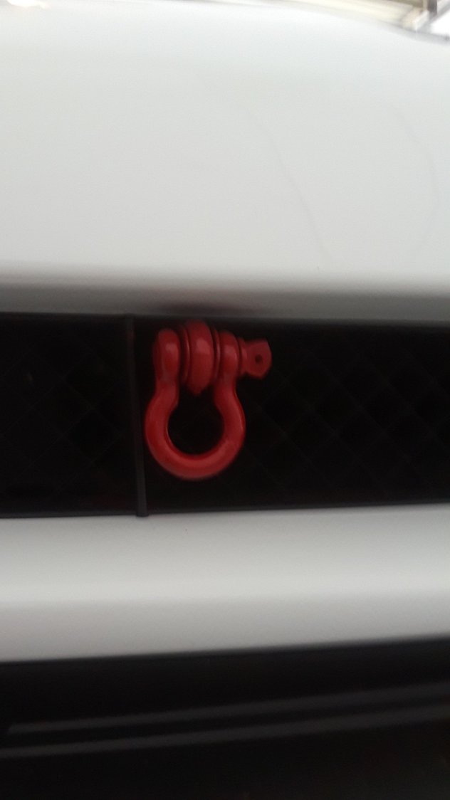

I used this and installed base, found I didn't like the hook and made up my own. You still have to remove front bumper !!
While it looks like it touches paint !!! I can assure you it doesn't touch
Corvette mods has this cheaper......But you would be a fool to mess with ( CORVETTE MODS !!!!!!!!!!)
