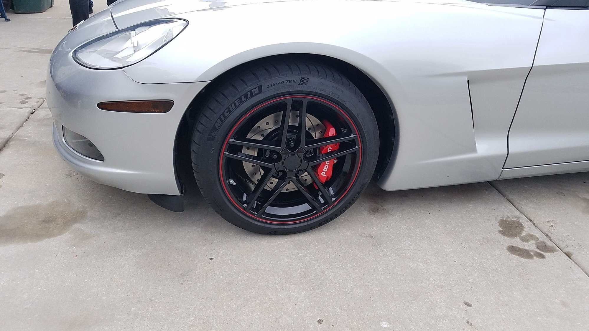

I put these on mine about a month ago. Got them from another forum member here but he did not know the brand.

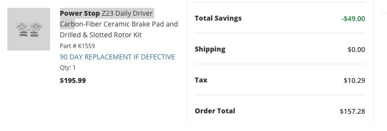

For what you need, PowerStop or BrakeMotive will be a good choice...try ebay, or rock auto. they are good rotors, good price.

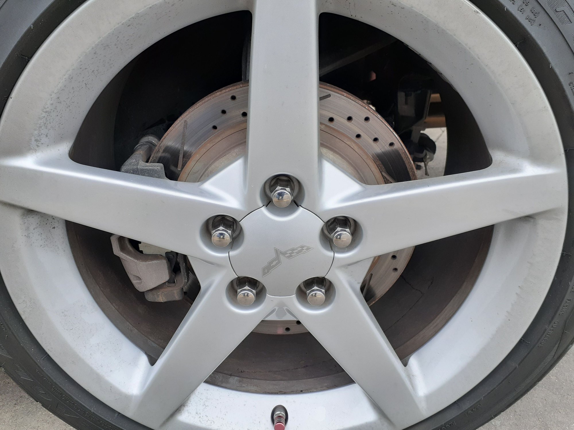

I think @CamarosRus got some off ebay that he is real happy with. He's got some pretty forged open wheels in front of them too.

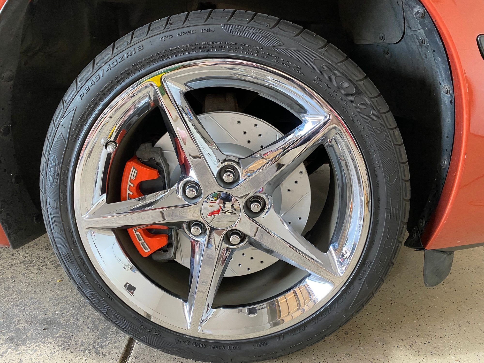

When my original Z51 rotors wore thin, I replaced them with Baer Eradispeed drilled & slotted rotors. Larger than stock, and a new bracket will be required for the rear brake caliper. Baer removes the iron core of each rotor and replaces it with a riveted aluminum center that's two pounds lighter and won't rust. Combined with Carbotech Bobcat 1521 ceramic pads, you have beautiful dust free brakes that will meet your street needs for many years.

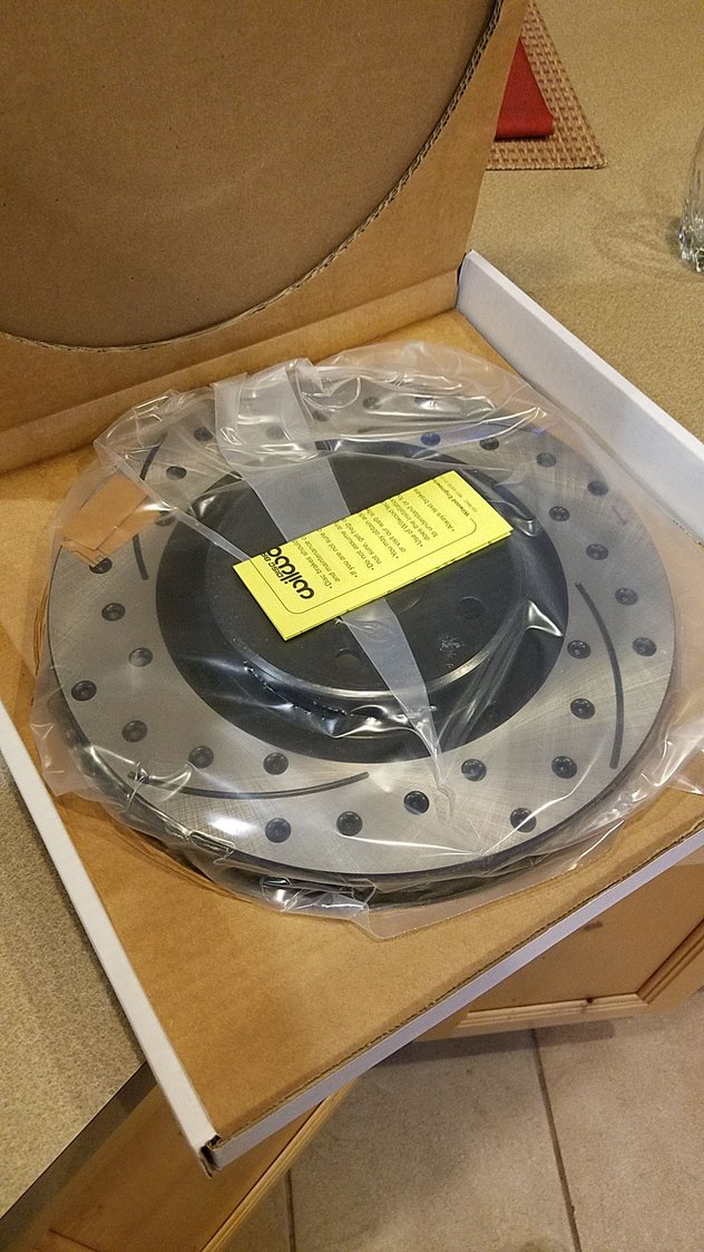

I went with the R1 Concepts drilled/slotted rotors and ceramic pad kit for my 2005 base convertible. Installation went smooth and they are performing great. Excellent stopping power and no squeaking. Photos are right after install before break-in process.
