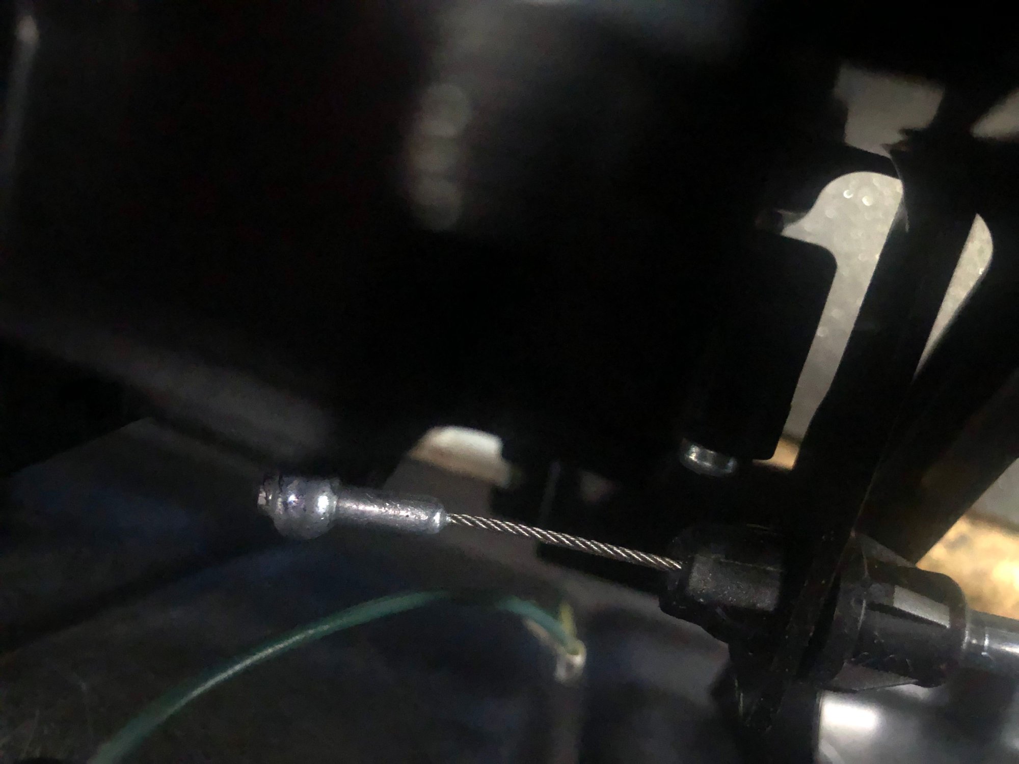

FYI, check your rear manual hatch release mechanism periodically - I came home from vacation to a dead battery and could not get the hatch to open. Consequently I could not get into the car to manually open the door. Two Locksmiths and AAA could not access the manual door release because of how tightly the window fits when fully up and potential damage to the car. Towing to the local dealer was not an option because it was in the garage, in gear and would have to be dragged out with lots of potential damage. Only option left was to break the drivers side window to gain access. New window installed was $372. All of this was caused by the cable from the key lock to the hatch latch not being connected!
Save yourself a lot of grief and test your C6 fail safe access system periodically.
Can’t tell from your photo, was this piece disconnected inside the hatch (under the carpet) or in the cavity between the tub & rear fascia that can be accessed by removing the tail light?
