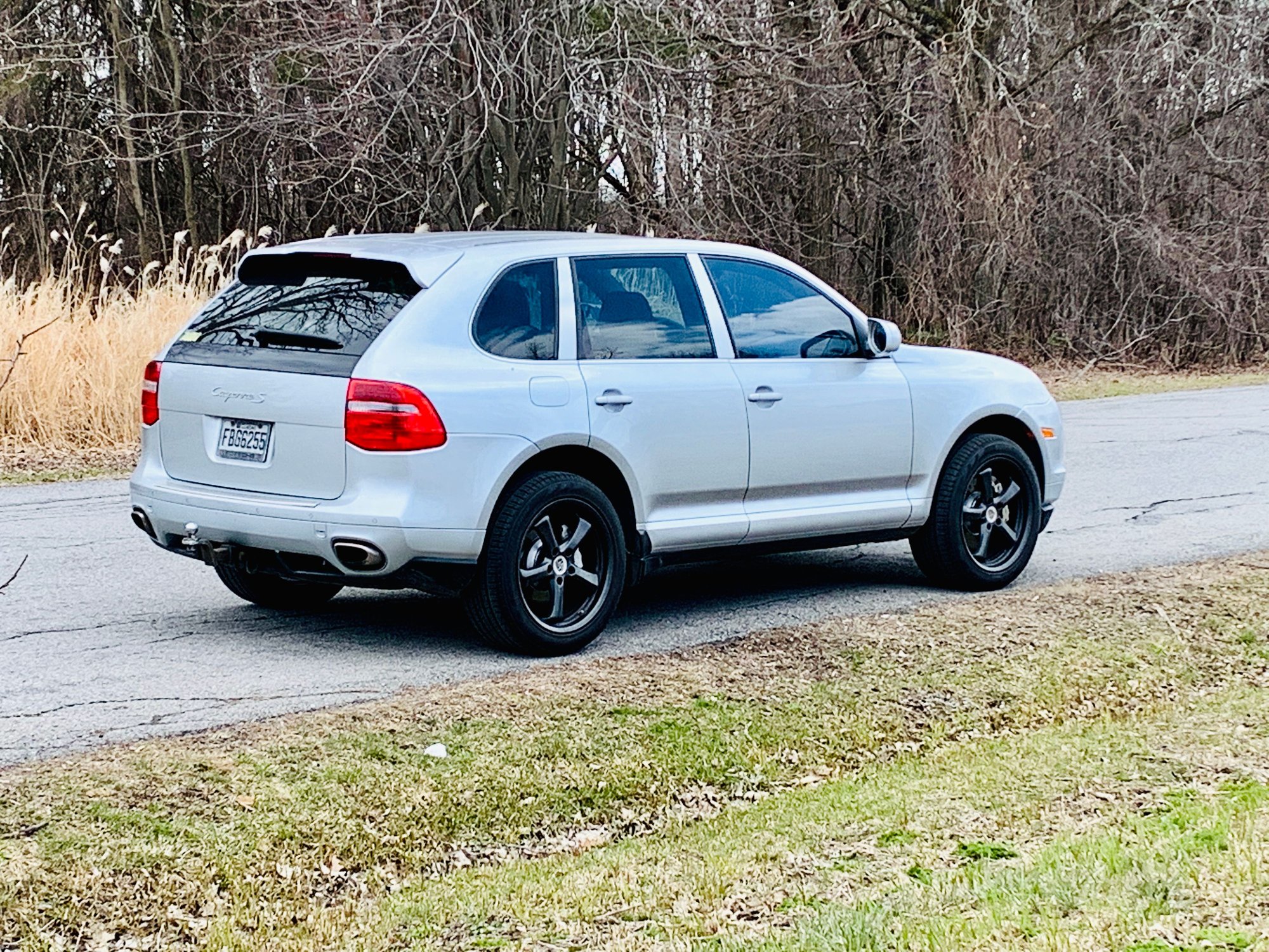

After calls to several different powdercoating/wheel, chrome shops...even to rechrome, I finally had a set of lightly flaking Chrome rims on my Cayenne tow vehicle blasted and powder-coated.
My only option was to scrap them because they were so fugly, so I took a chance on CAD$500 ($350ish?)
That was 4 years ago and they've held up perfectly. I am very satisfied with the outcome.
Caveat...I do not use these wheels in winter, but nor did i use the flaking chrome ones in winter....but doubt you'd drive your Corvette in road salt either.
I guess it depends on the shop ...and who you speak to
