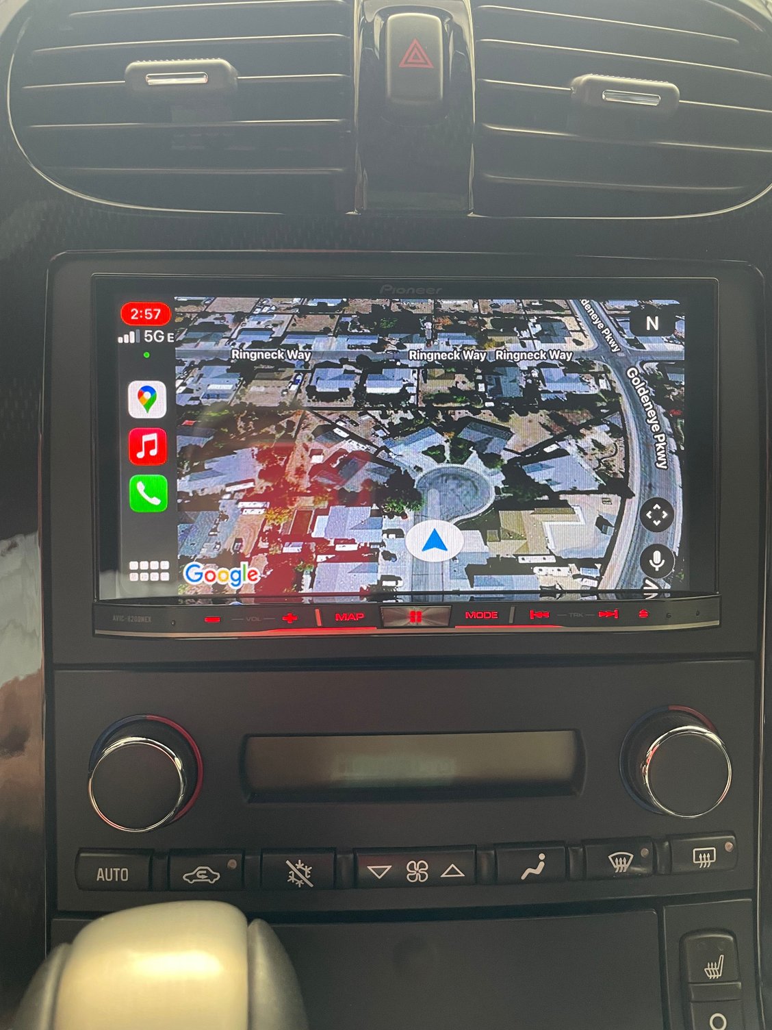

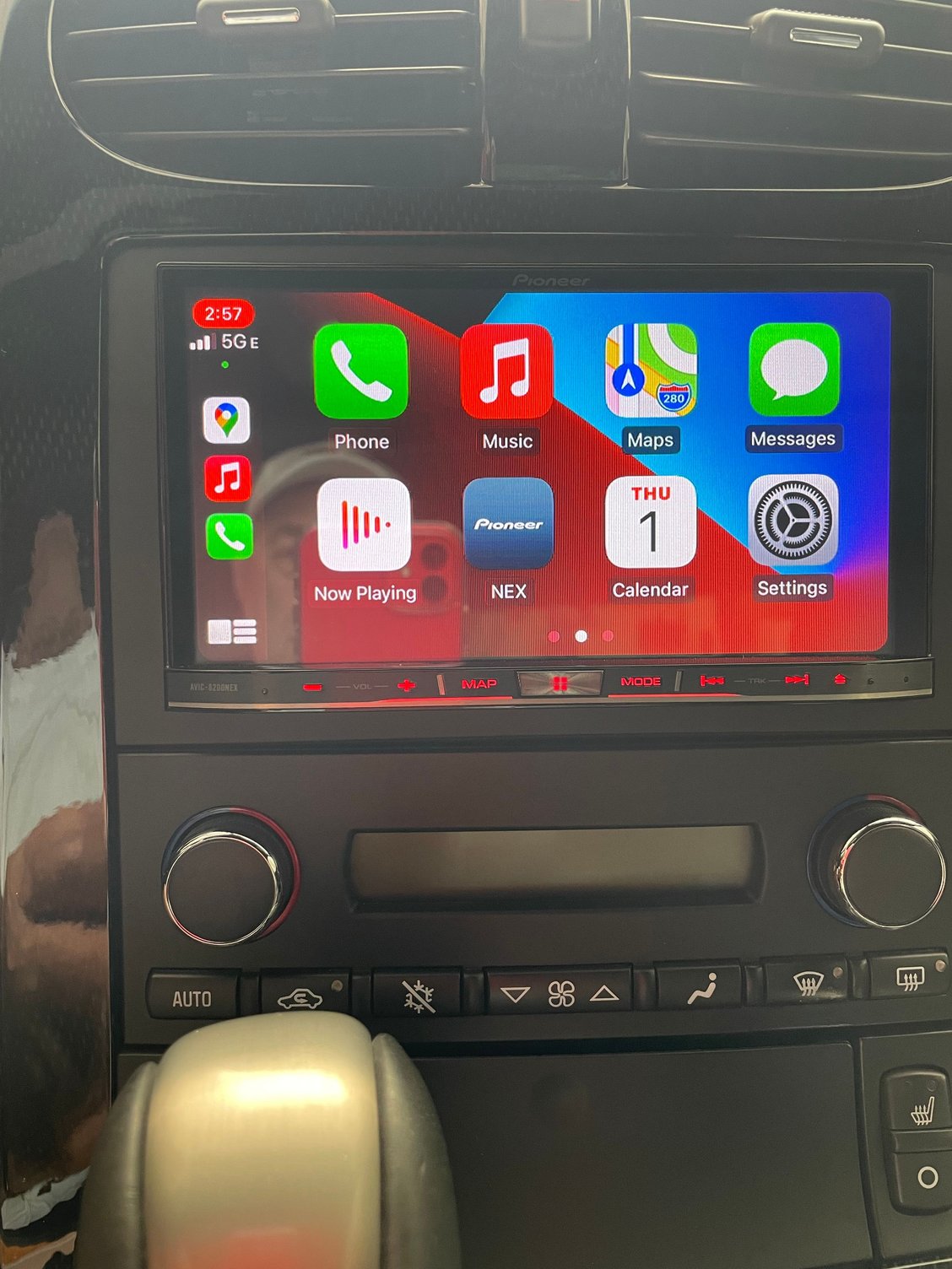

I'm using the RP5-GM11 no issues at all. 3LT in 2008 Z51 with OnStar / Bose
It is a Pioneer AVIC-8201NEX
