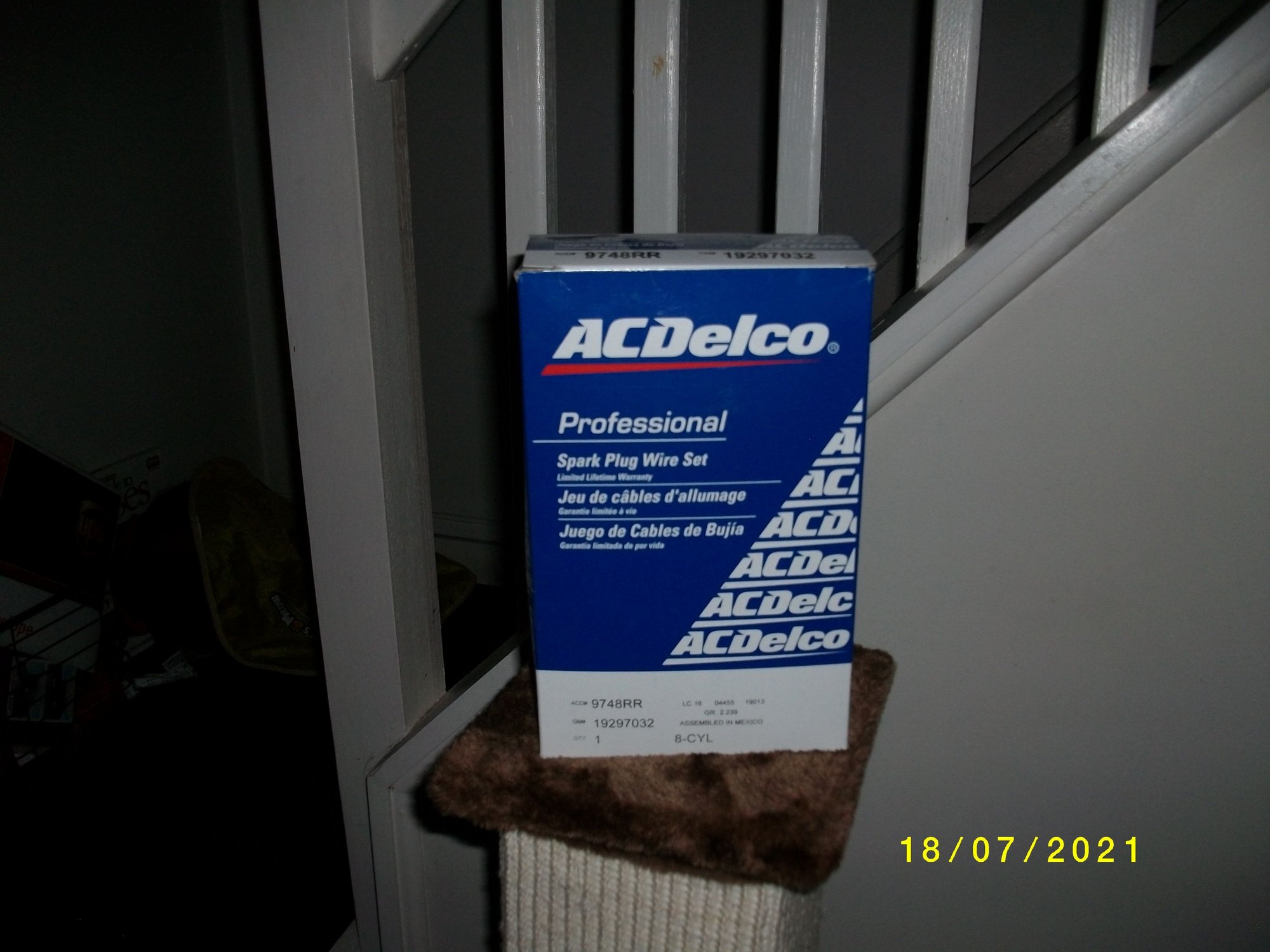

I had a rough Idle that was always there, so I put on a new set of wires and that cleared up about 70% of the roughness. Next I've bit the bullet and have a new set of injectors for the LS2.
