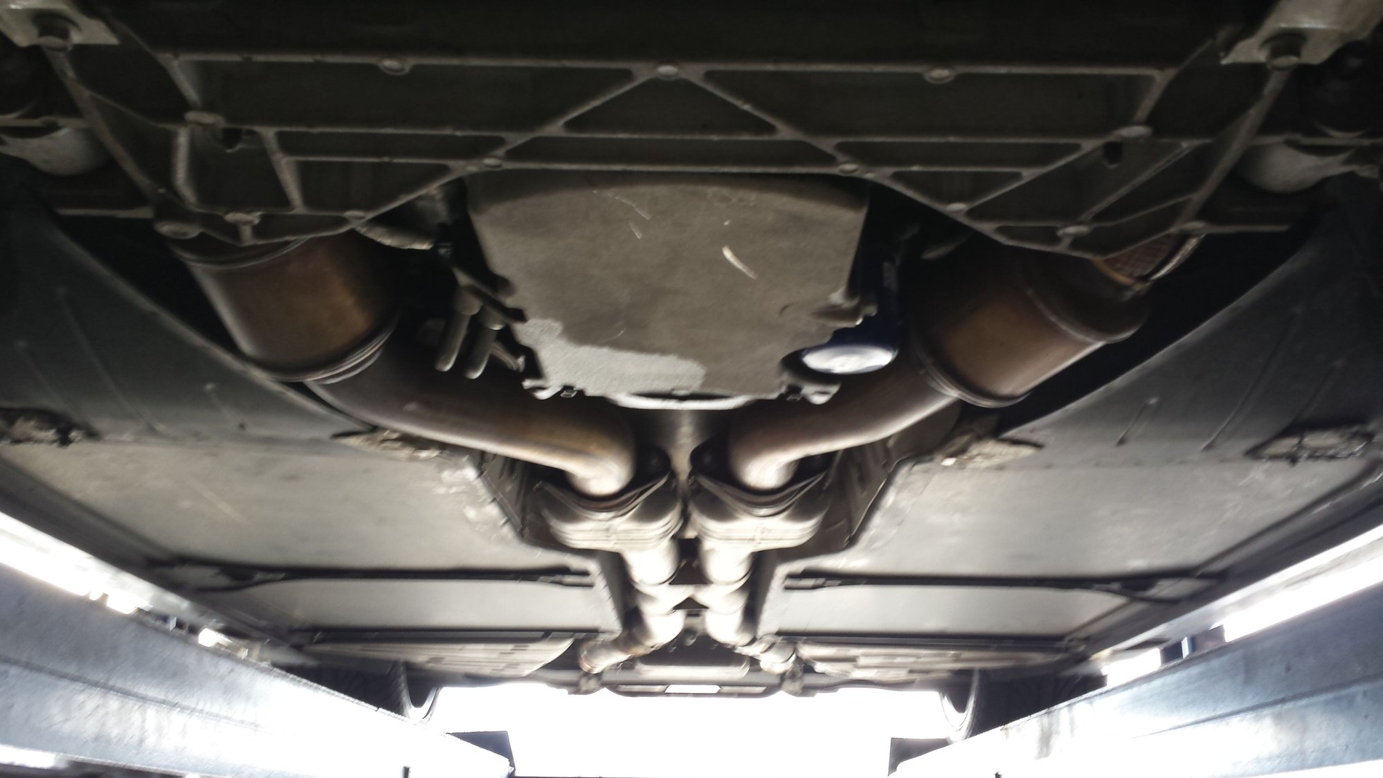

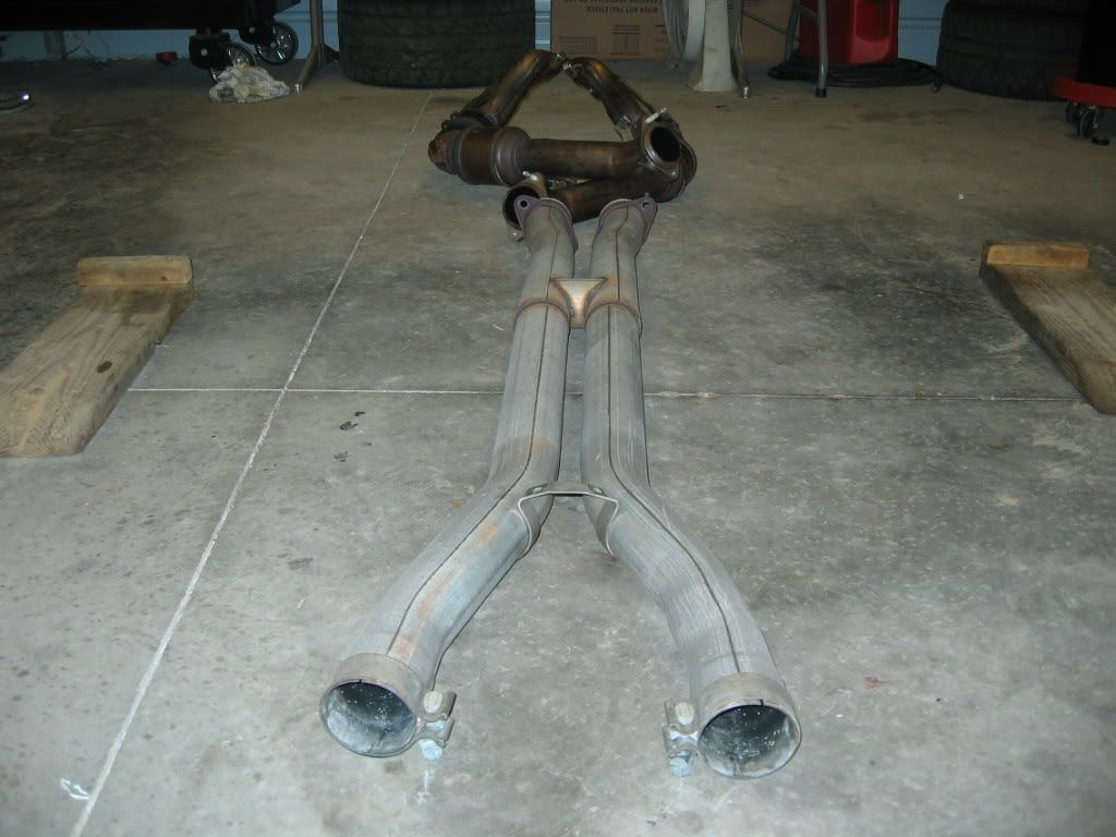

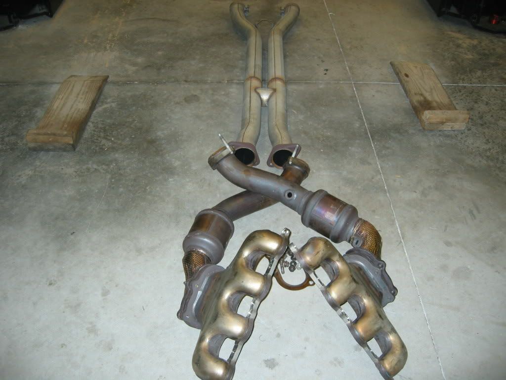

(Be aware that this first picture is not my Corvette but a picture for comparison purposes only)
This is not my Corvette - this is a system on a MN6 (my 2009 is an A6)

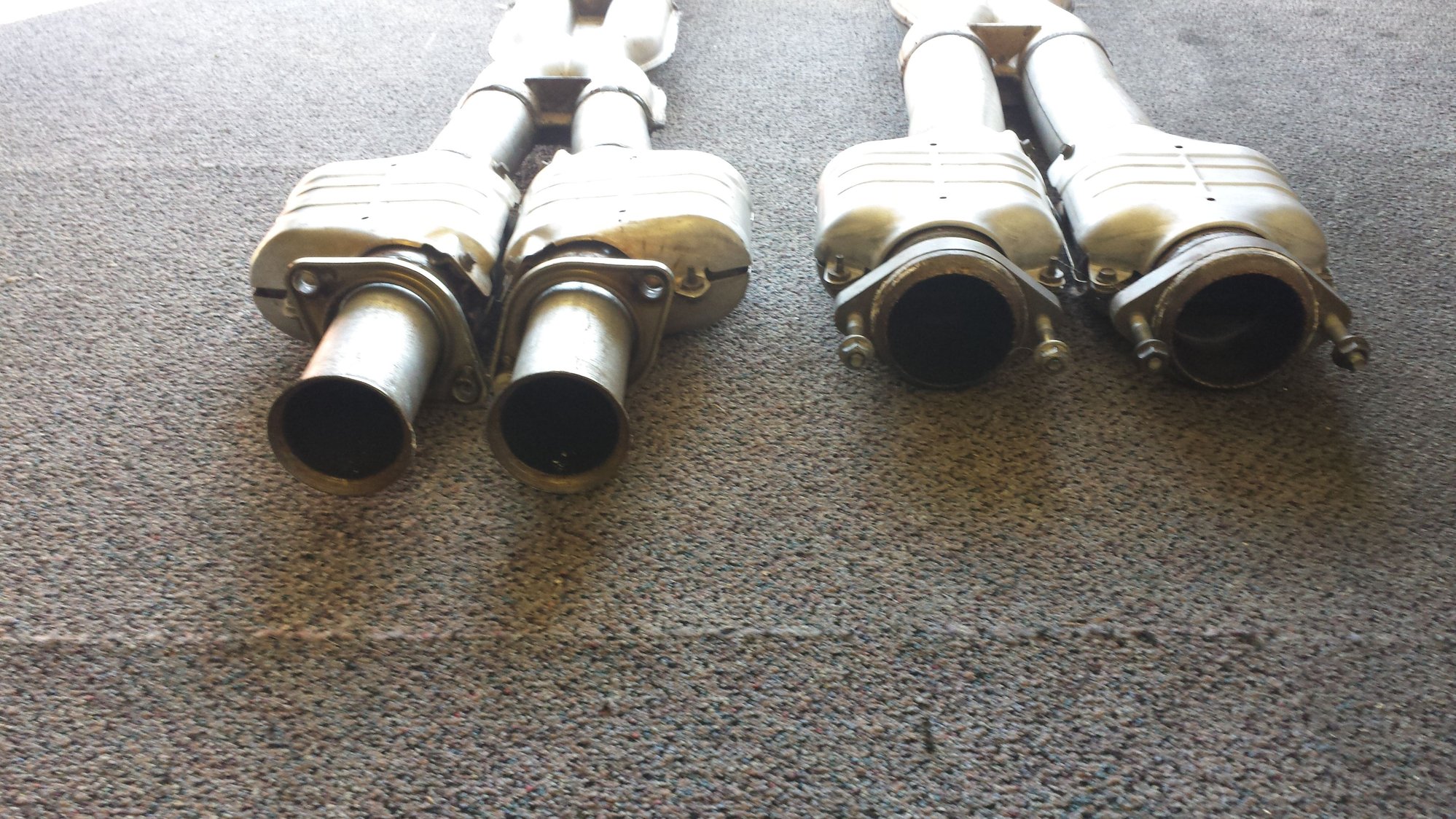

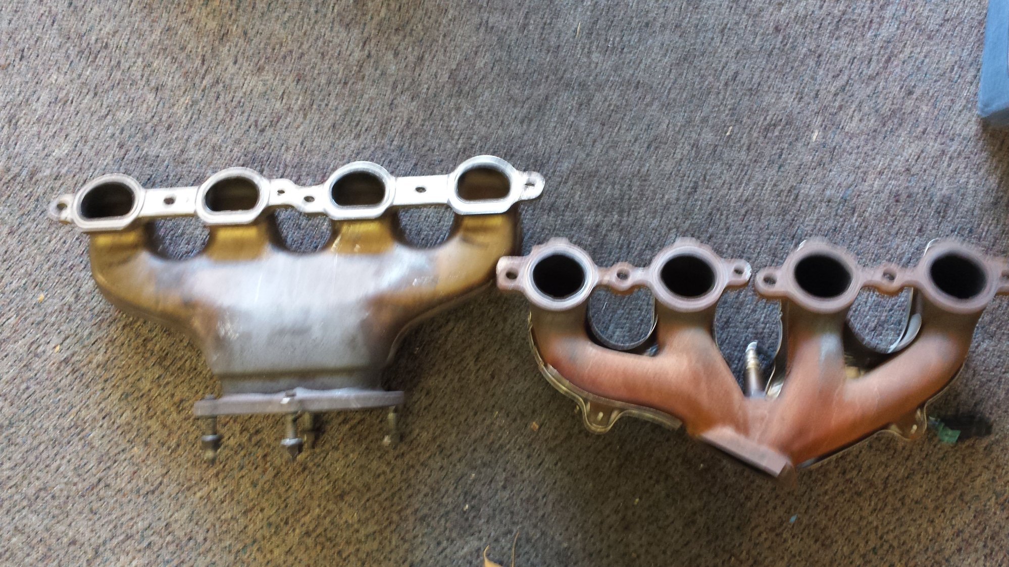

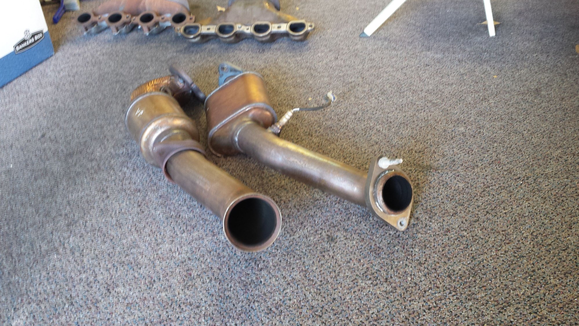

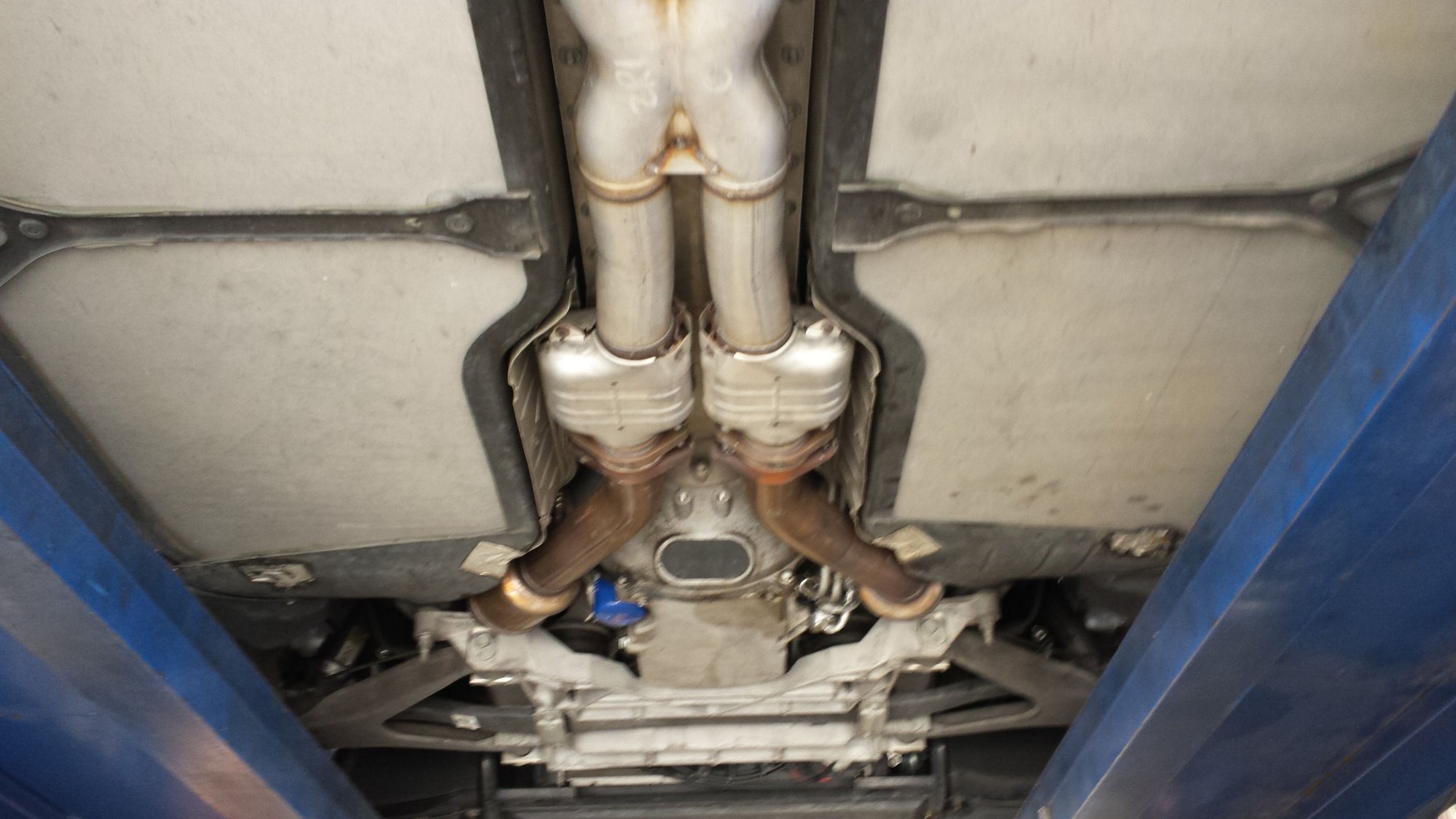

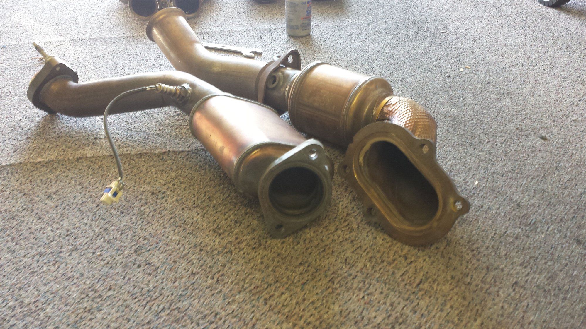

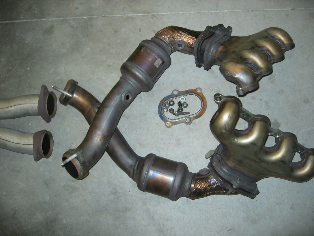

My 2009 A6 Installed Z06/ZR1 4 Cat system

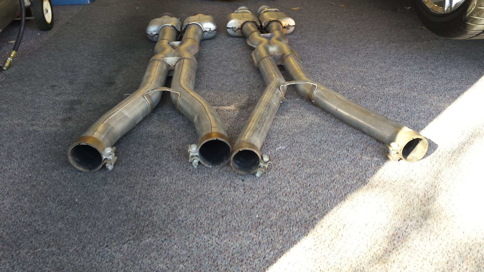

Z06/ZR1 4 cat system connected to factory 2.5" NPP (A6 transmission)
Z06 2 Catalytic converter system 3" (The Z06 for a few years had a H-Pipe before it went to the X-Pipe that the ZR1 had)

Ok, ill start trying to understand this. Looks like I will need; zr1/z06 manifolds, cat pipes and Xpipe from a manual 2012/13 zr1 or z06 to fit my 2013 GS M6.

You would have to get the manifolds and down tube(includes cats), X-pipe.
Check out this thread where I was asking many of the questions you are likely thinking.
https://www.corvetteforum.com/forums...manifolds.html
Here's two more links with tons on info including write ups on the swap:
https://www.corvetteforum.com/forums...completed.html
https://www.corvetteforum.com/forums...-09-coupe.html

2013 GS did not have the Re-Call so you should be fine finding the other set of 3" exhaust without the 4 cats
You should be able to find anything from 2006-2011 that comes off of the Z06/ZR1 - because you have the 2 Cats on yours with "NO" re-Call - only the 2008-2009 had the Re-Call and require the 4 cat system
I hope this helps some -

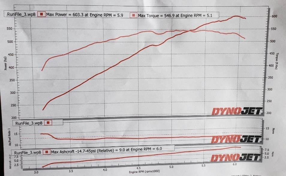

Just got off dyno and based on how the car feels now, I will be leaving it alone for a bit...

600whp on stock exhaust. I should have gotten an A&A kit... or used that dyno.

Maybe both? Lol... Car feels amazing. This is exactly what it needed...

If you're happy with it, don't mess with anything else.

I checked your post again. It was Hot and Humid when you tuned? You gonna try and retune? We Waited for a day in the low 80s as its been mid 90s here last few days. Worked out well today.

Yes, I'll get a retune after I get headers. Who knows how long that will take. I'm sure it'll be nice and cool by then.

Wow, congrats. Great numbers. No reason to change anything. Enjoy the car like it is and resist the urge to go further.
