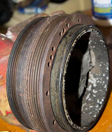

Absolutely agree! A great replacement which I used myself. (BTW, I did it myself, but for $300 I would have had it done. ) If you having a problem, get it replaced NOW! If it backs up (as in my case) you're looking at a new cam cover gaskets at a minimum. If it moves forward you're looking at steering rack parts.
Here's mine from a '98. Notice how it moved backward toward the timing cover.
