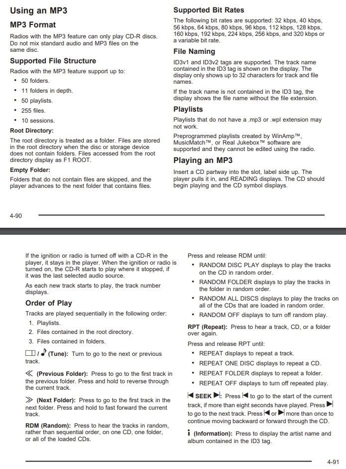

Fat32 has a drive size limitation of 8TB (technically higher) and a file size limitation of 4GB which is plenty for most USB drives including your 128GB drive. There are plenty of options to achieve FAT32 format for free on a Windows machine. How to Format USB Drives Larger Than 32GB With FAT32 on Windows That said, Fat32 is the recommended format to use for your USB if you want reliable performance. My 2010 manual has two pages (4-90 - 4-91) on the MP3 usage via CD which is mostly applicable to a USB drive. I can also confirm that playlist don't work(I've tried) despite it being posted in the manual. I also have over 50 folders and believe you can go up to 99 folders without issues. One thing I did notice is on long drives (5 hours+) the center console heats up to the point where it cooks whatever is in there including the USB drive. This typically results in the radio loosing connectivity to the USB drive where you have to pull it out and put it back in to be recognized. It hasn't resulted in damaging the USB drive but it's something to be aware of if you are planning any road trips during the summer months. I've notice no effects on shorter runs of 1-2 hours so it's not an issue under most circumstances. Although, it has given me pause enough to consider increasing insulation to the center console at a minimum since a previous cell phone charger couldn't stand the test of heat.

Thanks! I missed this. Why do they spread this info out in so many different places and across different manual?

No problem and I find it easier to download the PDF version of the manual and then just search it. In this case, I searched for MP3.

I just wanted to say this helped a lot. I finally got some time tonight to find somehow to convert my playlists to wpl and it worked perfectly! Sorry I haven't gotten back to you sooner but I've been very busy. We've been looking for a house in Florida for almost a year knowing that I was going to retire in June. We have finally found a house and looks like we will be moving sometime in late November. Now I just have to arrange a moving company. Anyone know of some good cross country movers they have used and can recommend? I know it's not Corvette related but any help would be appreciated! Oh, we will be moving to the Sarasota area.
