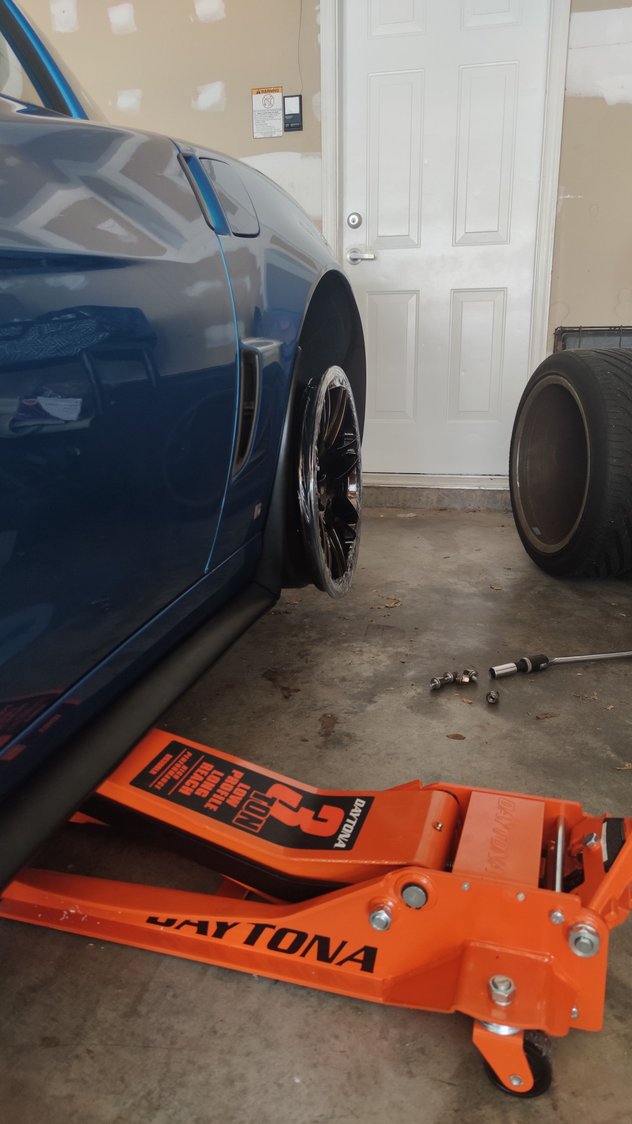

Hi all,
I just got my F14s delivered on Friday. I have an appointment to get them installed on Tuesday but Motorsports LA said to test fit first before mounting tires and the labels on boxes say "you mount it you own it". Fair enough.
I go to test fit today and I see the rears have a label on the offset 19x12 offset 36... I'm puzzled because I asked for 50 offset.
The fronts say 18x10 offset 1.75 which comes out to 44mm.. again, I asked for 40mm.
Does Forgestar use a weird offset calculator? Are they taking backspace or some other value into account?
I did test fit the rears and it looks great, won't stick out but I want to confirm the offset is truly 50 and not 36, otherwise I know the tire will rub the fender and break it.
