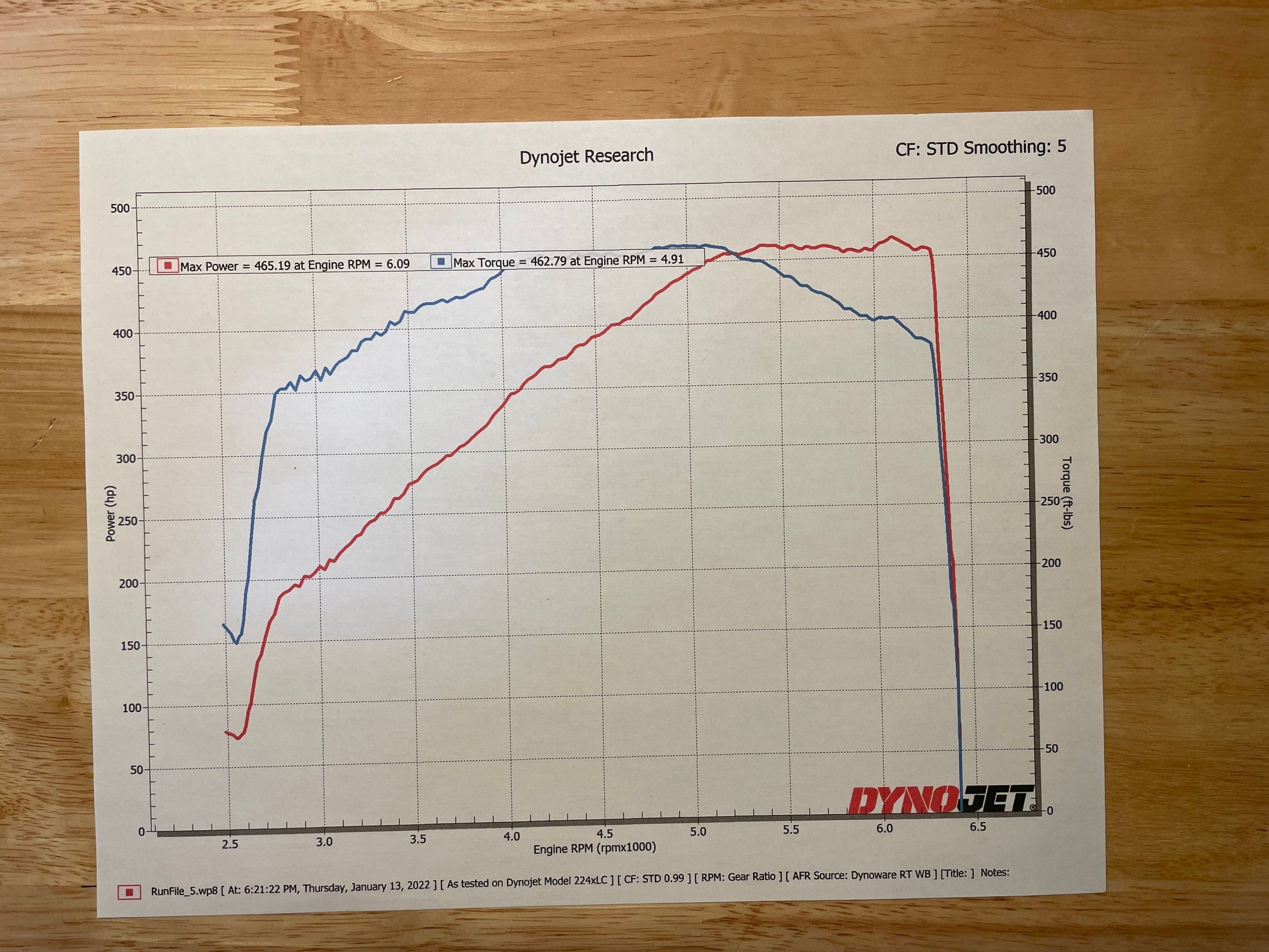

Finally got the vette on the dyno and I have a few questions.
First off…
2011 Corvette Grand Sport M6

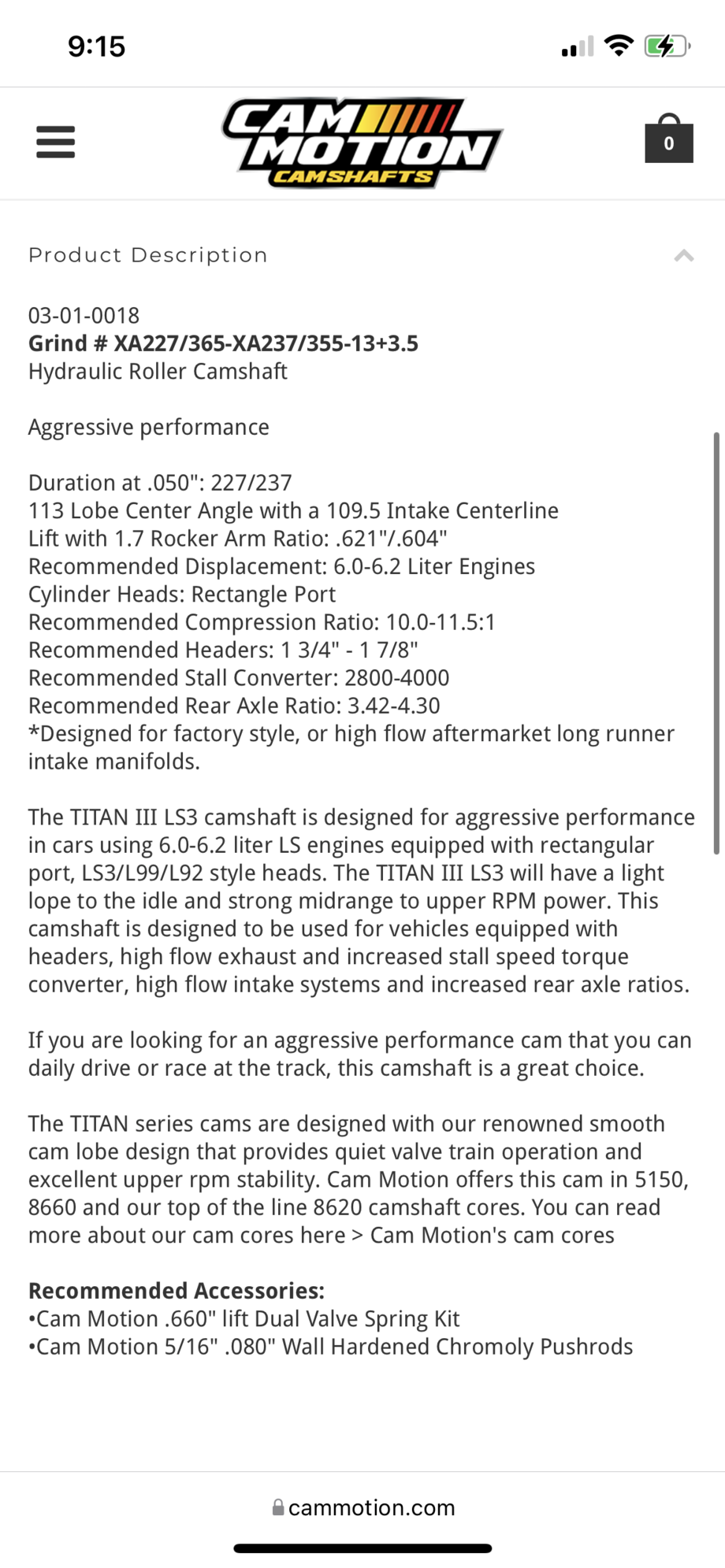

Cam motion titan 3 cam (specs in pic)
Kooks 1 7/8 catless longtubes
Intake/TB ported and rod modded by BLP
Haltech air intake
ATI 10% UDP
Glanzer flex fuel kit
LSA injectors
NGK TR5GP spark plugs
Car made 448whp and 436tq on 91 octane.
Current issues
- Tuner said it was knocking and suggested a 160* thermostat. Coolant temp was 224. No fans and 57 degrees outside.
- HP graph was completely flat after 5k rpms.
- At times, idle is very sputtery. Is there a solution to this? It chops real nice but it goes into this sputtering that sounds horrible. Sorry hard to explain.
- Car dies on warm starts .. I can hold the accelerator a tad and it’ll start right up.
Any ideas or suggestions would greatly be appreciated. Will be going back to finish off the 91 and e85 tune soon.
Old Jan 9, 2022 | 06:37 AM
old motorhead's Avatar
old motorhead
Joined: Dec 2005
Posts: 6,999
Likes: 1,685
From: Southeast TX
Your tuner has more tuning to do. I would swap plugs to a 6 heat range. The plug you have is too hot for the power you "should" be making. I use AC Delco 41-104 plugs at similar power levels. A 160* thermostat won't help much. Tuning the fans to 100% at a lower temp can help. You need to make sure your radiator and a/c condenser are pristine before going back to the dyno. Also check air inlet for dirty filter and any other obstruction.

Thank you, already ordered some NGK TR6s. 👍 I cleaned the radiator nicely during the cam swap.
I know the first 3 pulls were done without any fan blowing at the car. The IATs were up there. Not sure if the haltech intake has any part in that but It was pretty cold out.

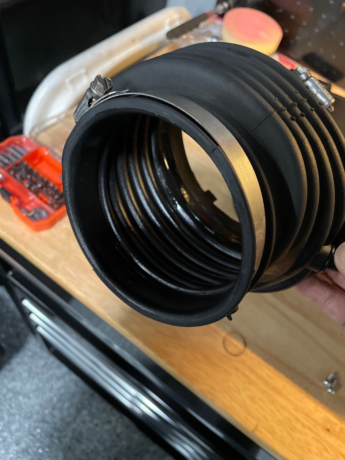

It was oil in the maf. I found out after the dyno tune.
Cleaned the MAF 300 miles ago. Guess it’s time for a catch can..
Probably need to return again too /:
This is with TR6s and a 160 thermostat. Intake temp was around 90*F.
~50* F outside temp.

Old Jan 14, 2022 | 07:22 AM
old motorhead
Joined: Dec 2005
Posts: 6,999
Likes: 1,685
From: Southeast TX
You've still got something going on up top. No way your setup should flat line at 5400 rpm. I'd look real hard at your valve train. Maybe push rod length? Also, with the flex fuel kit, you may not have enough fuel pump if you're still using the stock one.
Old Jan 14, 2022 | 07:55 AM
Spaceme1117's Avatar
Spaceme1117
Joined: May 2016
Posts: 4,669
Likes: 1,849
From: Erlanger, Kentucky
Yeah, something's not quite right up top. Looks like timing is being pulled or maybe even some misfires. And could should be able to go to 7000 rpm with that cam.
What springs and pushrods are you running?
Old Jan 14, 2022 | 01:09 PM
Zee_'s Avatar
Zee_
Joined: Dec 2020
Posts: 51
Likes: 8
BTR 7.40 hardened pushrods and BTR dual valve springs.

Did you measure to make sure the 7.40 pushrods were the length you needed? Usually larger cams than stock will have a smaller base circle which can usually mean you will need a longer push rod.
For example, in my 2006 I used to have with the LS2, I did a cam swap with a Cam Motion cam and I had to got with a 7.425 pushrod versus the stock 7.4.
If your pushrods are too short, that could be what is going on. But the only way to know for sure is to use a pushrod length checker and measure it.

Sorry the springs and pushrods are from cam motion too. No I didn’t measure that’s just what they recommend me.

Most shops recommend 7.40 but this is just plain dumb. Only way to know what you actually need is to measure. And if you don't want your cam to eat a lobe or failed lifters, and you want good valve train stability, you MUST measure.

Yep now I just need to figure out how to stop it. I believe the oil is coming from the dry sump vent hose that connects into the air intake coupler. 🤔
Any ideas??
The air filter was cleaned and oiled but I was pretty careful oiling it and It sat on the shelf for 2 months before going on the car. 🤷‍♂️ Maybe air filter oil?

So finally got around and sent another data log to my tuner. He said everything looks fine. No changes need to be made.
I’m a little surprised because of that power curve.
33 degrees timing at 5500 rpms.
This was on 60% ethanol, by the way.
Did he speculate on what was happening from 5300 rpm on up? Or does he consider that normal?
