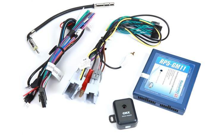

Just wondering which PAC interface are you using ? Is it the RP5-GM11 or the GM1A-RST ? I know there've been some issues with some of the RP5's but I've never heard of an issue such as you're having with it, not to say it couldn't happen. I know PAC recently changed the design of the RP5 which came out in Sept. of 2021 which looks like this now. https://catalog.pac-audio.com/catalo...ement/rp5-gm11
Where as this is what the older ones looked like.
So if you do decide to get another one I suggest shopping around to make sure you get the latest version which is Rev. 5.1.3.22

Have a Pioneer in my '05 with no issues. I have the older PAC as shown in the above picture. Certainly sounds like that could be your issue, even if you have the newer interface if there's an issue with it. Wouldn't think you'd need to completely re-wire the interface, just pull out the connectors and install another one. Where did you get the interface? If from Crutchfield they're very helpful. Can't imagine wherever you got it wouldn't be willing to send you a new box to verify your problem.

It depends on which version of interface he gets, if it's the newer version I think he may have to rewire his radio harness to the harness of the new version because it looks to me like the connecters might differer from the old version. If he gets the older version one, then he probably wouldn't and everything should just plug right into it.
