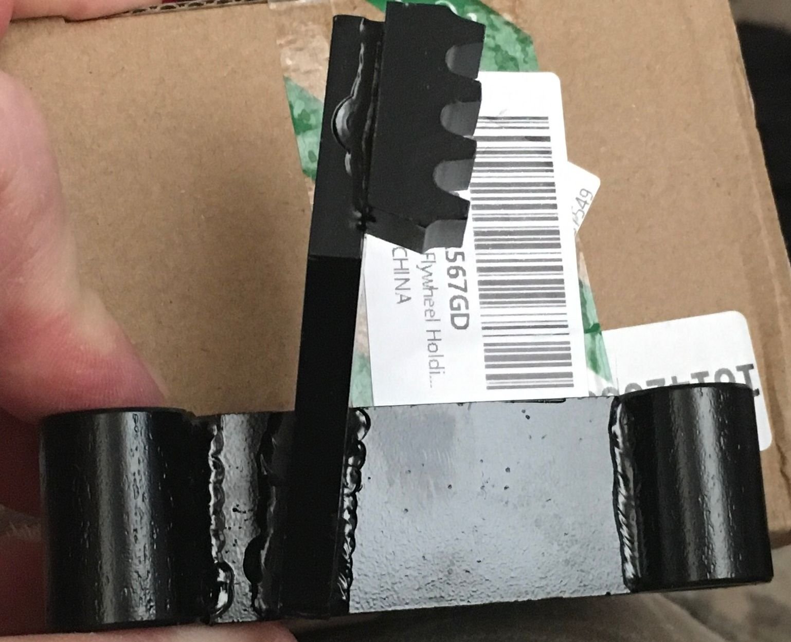

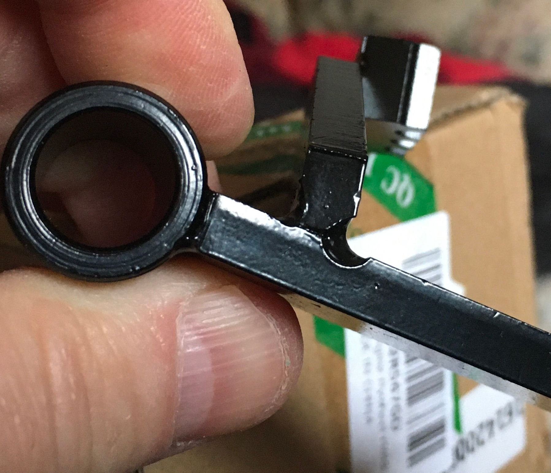

So I purchased a flywheel hold jig off Amazon to facilitate harmonic dampener torquing. Since I figured this would be a single use tool I went cheap. Well F me…
Would you look at the undercut on those “welds”. Doesn’t look like they used any filler on those tig welds, lol, I really didn’t expect much but come on. Guess I’ll fire up my tig welder and fix this mess. 🤔🤨

Pissing in the wind by breaking it apart to re-weld it, since the metal is soft to begin with instead.
So unless you are planning on stripping it so you can first break the welds and re-weld it a lot cleaner, then heat treating the entire thing afterwards (***** loads of Kasenit to get more carbon into the steel to start with), then just run it as it, and if it does break a weld for the single use, would worry more about the metal bending/peening instead.
Simply, most of the time cheap has nothing to do with the labor of building the tool so much, but the metals used to build the tool isntead. Take wrenches, and since it pretty much the same process to get the finished wrench in the end (forging and processing), the reduction in price comes down to the steel and heat treatment processes isntead.
P.S, love that fact that they did not even clean up the splatter, before the piece as painted. So guessing steel was not even primed after clean up, so paint should be easy to remove (that is what does not flake off from the first time you go to use it as well)
Oh, and back to the welds, and the reason that it's only single pass welded, single pass wire is a hell of lot cheaper than multi pass wire, so would be twice the money in welding wire if they were going to do multi-pass fillet welds to begin with. If you are going to re-weld it to start with, then you have a lot of grinding to do, since you need to remove all of the single pass wire fill to start with from the base metal, before you can start laying down welds with multi pass wire or rod.

Really, when is comes to buying what you consider one time use knock off tools, its really a crap shoot, since the cost reduction is not that much to begin with, and lets face it, in most cases, before you get to end of task, the tool has had not only problems to start with, and even lucky if it even last to the end as well.
Case in point on the fly wheel holder, will bank that the gear section does not fully mate up with the fly wheel teeth to start with, with the excess of paint, even bolting the tool up tight is going to end up with the teeth slipping/having to go back and re-tighten up the bolt, and the first time he hits the HB bolt with a impact driver to break it free in the first place, tool going to break apart in a few pieces as well.
So back to OP, once you do finish the project, please post back with the wear of the tool, and how many of a PITA it was using the ill fitting tool in the first place.
