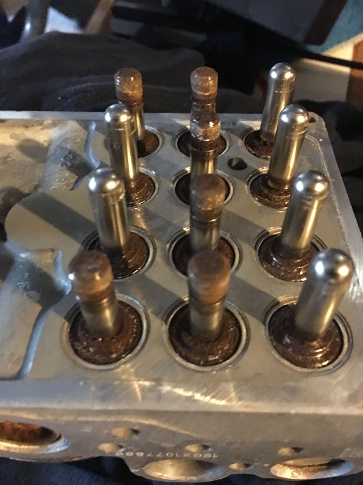

Need more details, since problem could just be a corroded EBCM connector the problem alone.
If sticking valve, not hard to pull the control box off the unit to get to the valves and control solenoids to clean then up, as well correct a cold solder joint or two as well.
Really, the problem is that you have the car at a dealer, instead of indy shop, since the dealers are just parts changes, while indy shop will go the extra mile to clean up the connector, and maybe even repair the module in house as well.
Hence here we have a valve body that the valve stems need to be clean up,
As well as the solenoid bodies clean up, and a couple of solder joints on the board that need to be re-flowed to correct the control side of the module.

Short version, easy to pull the control side off the EBCM, while leaving the body side still in the car with the brake lines connected.
If see that the piston valve stems needed cleaning, such can be done in place, and regarding the control side, solenoid bodies easy to clean up with a touch of dielectric grease in the end, and since you can see the solder joints on the board, easy to re-flow any in question too.
If such is beyond your skill level, go find a Indy shop that is able to do such in house, isntead of the car sitting at dealer for weeks as they pull and farm out the corrections on the EBCM instead.
