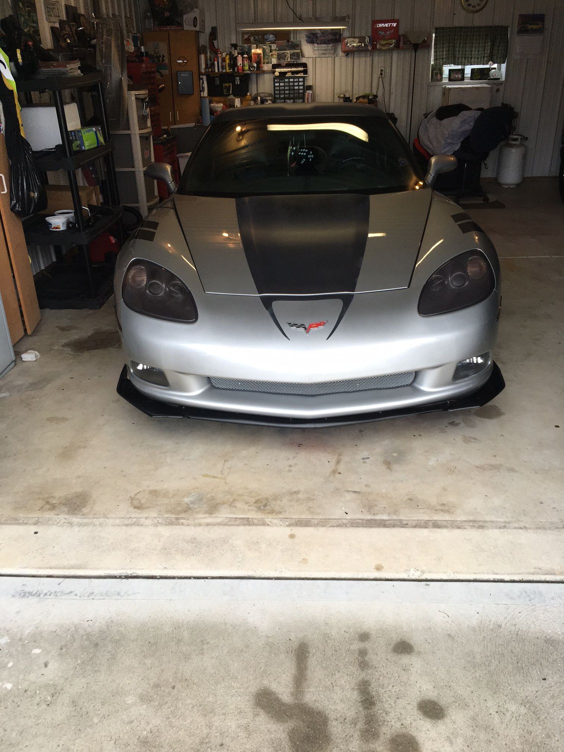

Light smoke for reference

Nice and im hoping it turns out good. If it doesn't turn out well, I might super lightly tint them to see how that goes!
