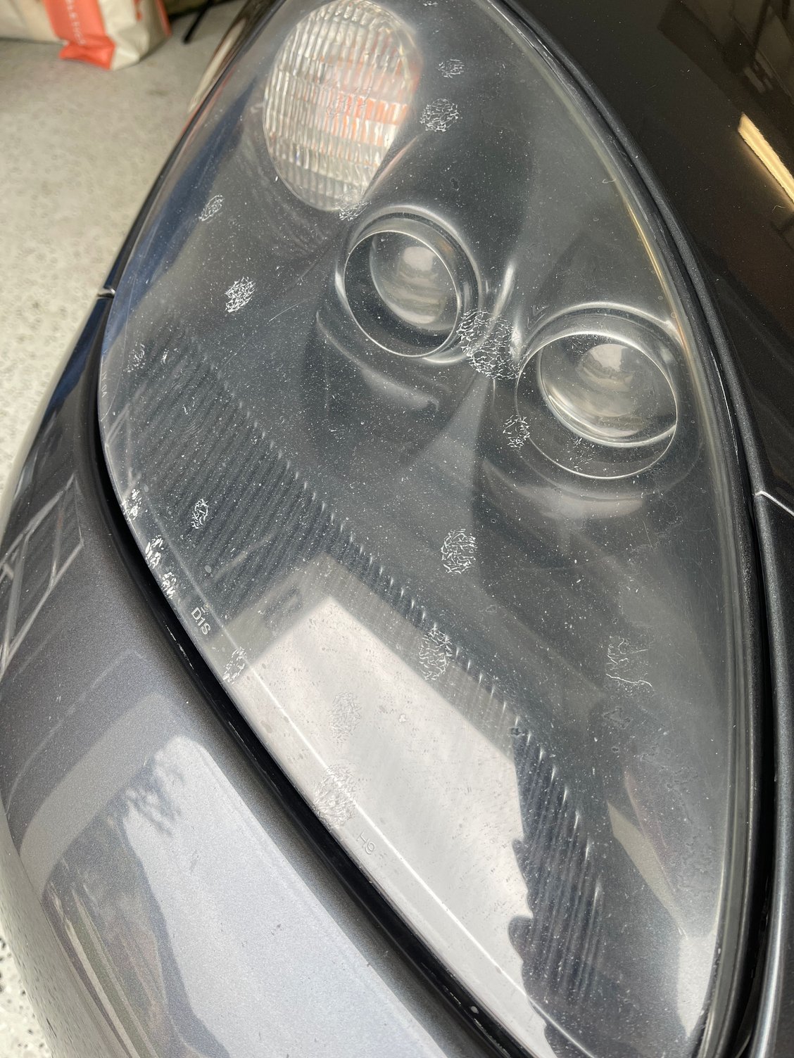

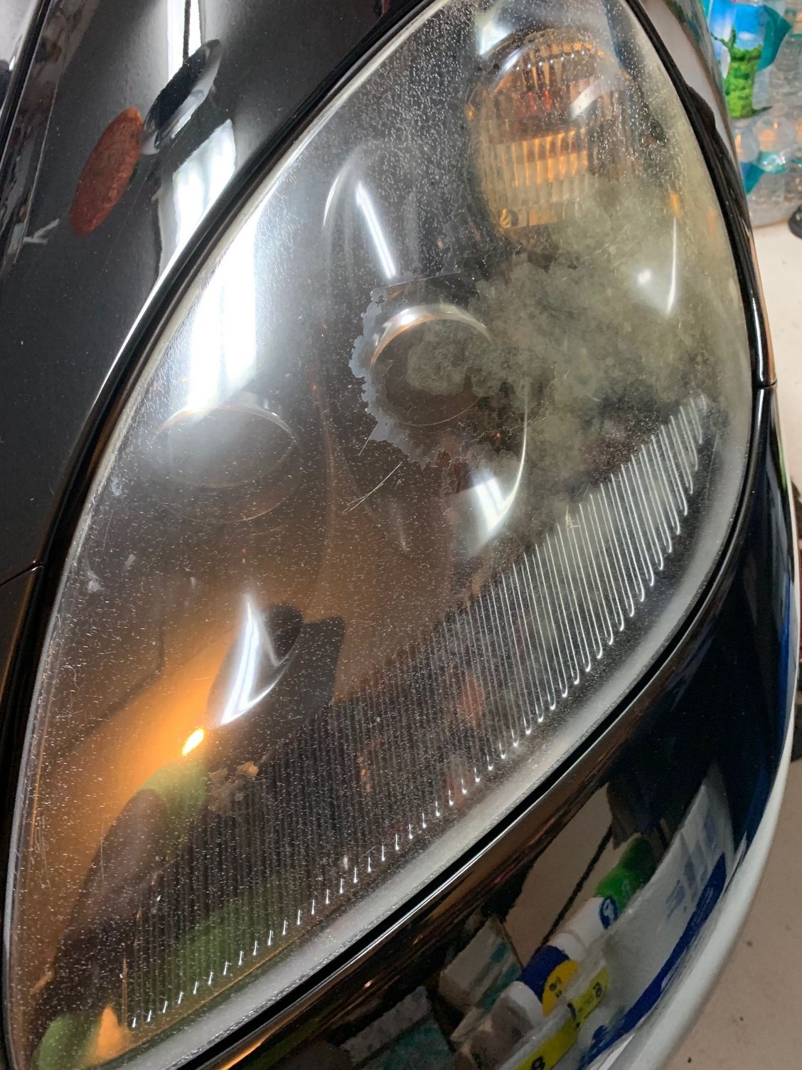

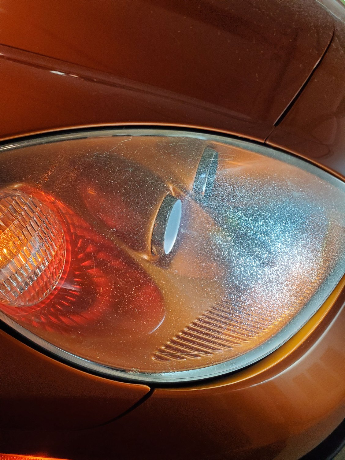

Hey y’all! Just picked up a 13’ GS. Loving the car…except the damn headlights are shot. I want the c7 ones, but before I order those and spend $1500 on that instead of wheels…is there anything I can do to fix these up a little?
those white marks are driving me nuts. You can’t feel them at all - they look like you could, but they are completely flat on the surface. I tried a lens restore kit from advanced (Mothers brand I believe) but it didn’t do a damn thing. Also, I have no idea what made these white marks lol…
thanks for any help in advance!

Looks like etching either on the outside or inside. If inside, nothing you can do unless replace a new lens or take apart and polish the inside which would be a chore.
I've been in detailing and the business for about 10 years and the best way to clean the outside is clean with IPA, do a couple passes with correcting compound, couple passes with finishing compound then couple layers of wax. This assumes you have delamination (fog), scratches and etching which this will fix completely. Cracks in the lens or stuff on the inside obviously polishing cant fix.

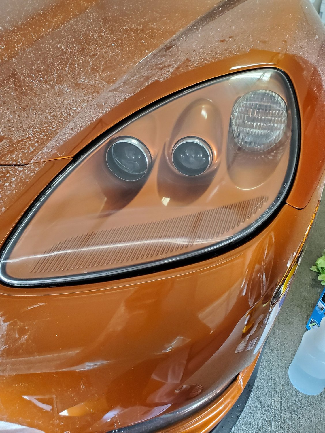

dang that worked well! It can’t get worse so I guess I’ll give that a try! What did you start with grit wise for sanding? All wet sanding right? Lol did you make a thread on this process I can just go read? Looks like a cool project

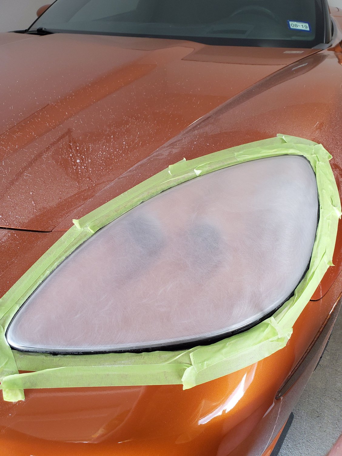

Believe I started with 180, but you can start with like 400 and see how it goes. And yes it was all wet sanding - no I didn't make a thread. The trick to getting it to turn out right is you need to strip the entire factory clear from the lights since that's what's crazed - not likely the plastic housing. You can see in the pic below towards the bottom, there's little slivers of what look like 'clear' still on the light. When you're sanding you'll see it and helps you make sure you've got it all off if none is visible.
