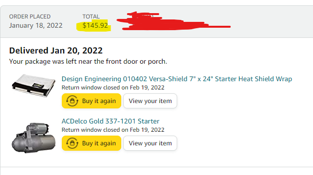

I swapped my headers about 6 times on vette for smog reasons and what not. I once accidently destroyed the selenoid on my oem one lol. Went to oreilly to get a $140 replacement and installed it in like. Idk 30 minutes? Less? Never had problems with it with my LT Headers TSP.
